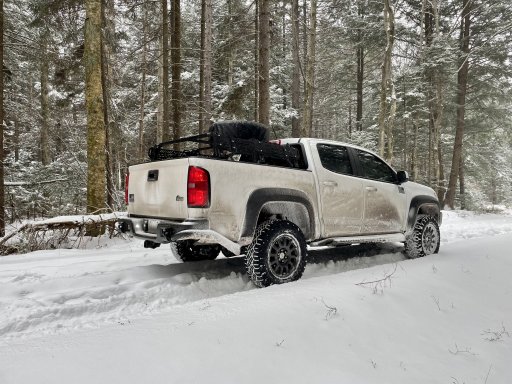

This is definitely more of a general truck issue. I pulled mine out from under my Bison almost immediately and mounted it to the bed for a hot minute, then the decked drawers, and now it’s on my bed rack where it’s staying. I don’t like any of the potential issues of having the spare under there. Not to mention it hung down too low and the tire size I intend to run won’t fit anyway. I secured strongly, locked to prevent it from taking a midnight stroll with strangers, and covered to keep it out of the sun. You Yota people have the benefit of the bed rails. Should make mounting it simple.
