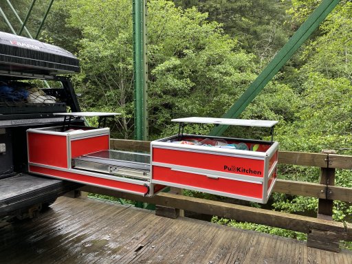

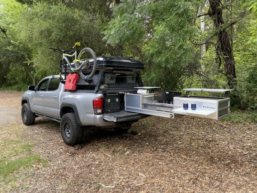

The mount is completely redesigned, the drawer now has the slides hidden inside, power and water are managed differently, but it worked awesome as designed in these plans. Of course the new designs are better :)

Producing and building in the USA isn’t cheap, and it’s made from all aluminum-stainless steel-HDPE-composite materials. So unfortunately it will price some people out for sure. Hard to meet everyone’s needs when some want a turnkey product and others are on a tight budget. But either way we just wanna see people get out and see the world whetther they buy it or build it!
