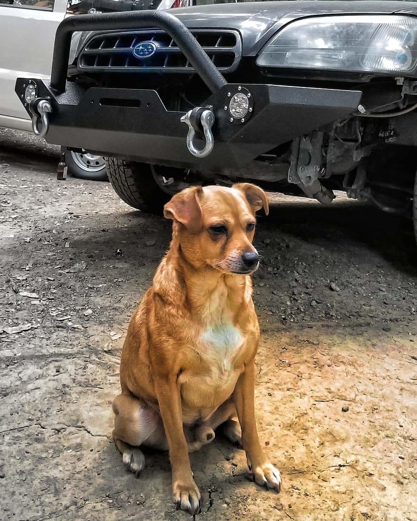

I would like to know more about the subiefish bumpers? Is everything made to order, or do they prefab some stuff?
I believe they are doing batches of the bumper brackets. Send them an email, they respond pretty quick. They are currently updating/building their webpage so there's not much beyond contact info and some pics on there.

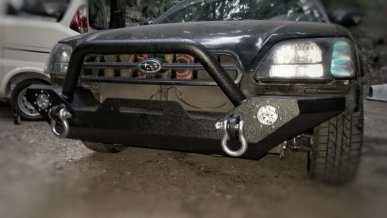

I went down to Boulder Creek to SubieFish yesterday after work and we got my front bumper installed!
Im super happy with it, its hard to believe it was designed for a Jeep TJ and not a Subaru! It didnt add as much weight as I expected! The new bumper weighs 63 lbs including shipping materials and we probably removed 20 lbs of the OEM bumper!
Im really itching to get the lift kit installed and getting new tires and rims!

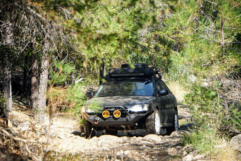

Went to meet up with Mountain Roo Sacramento and did a trail run out to Jolly Boys Mine today. Awesome trail and the swim hole created in the mine pit is amazing!
Below pics by Kyle Cunningham

Bumper looks great! And that trail looks super fun with that swim spot. Cant wait to see whe. U get the lift. Dont forget to have an alignment done whif Subiefish fish doesn't do it for u.
Reactions: Low594

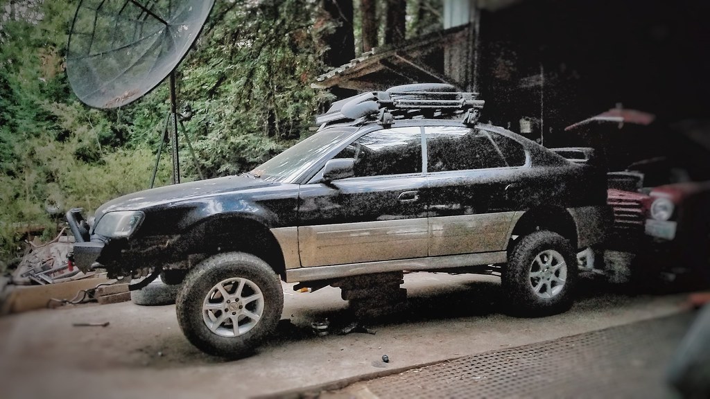

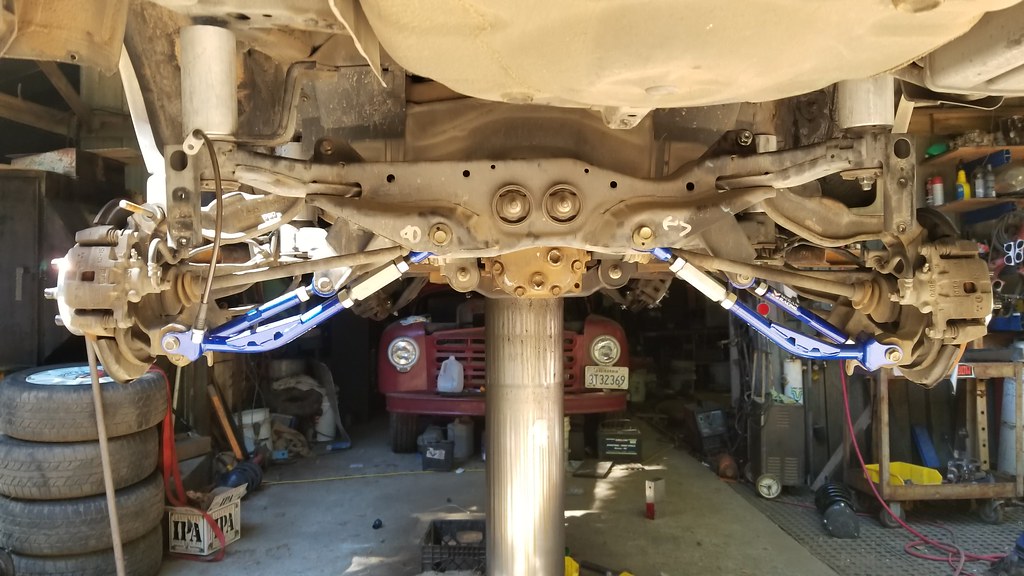

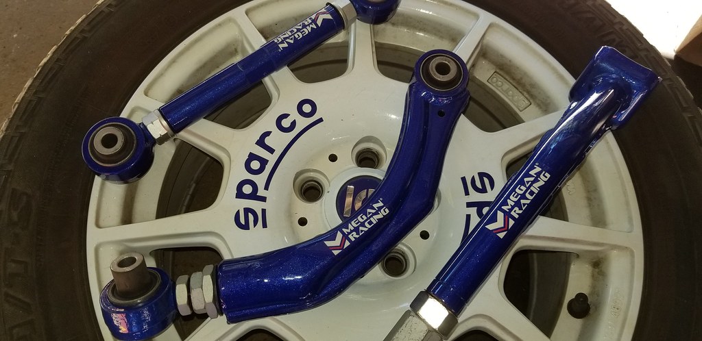

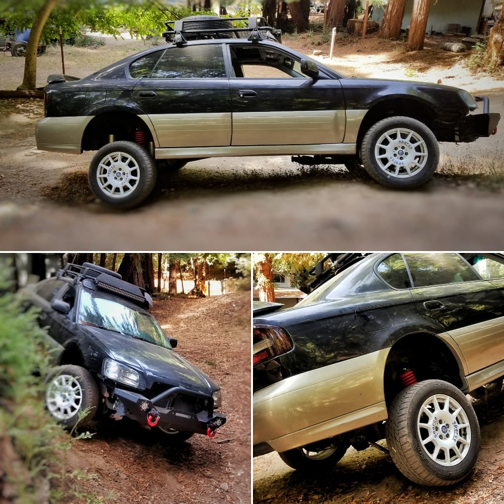

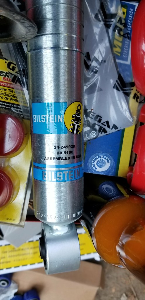

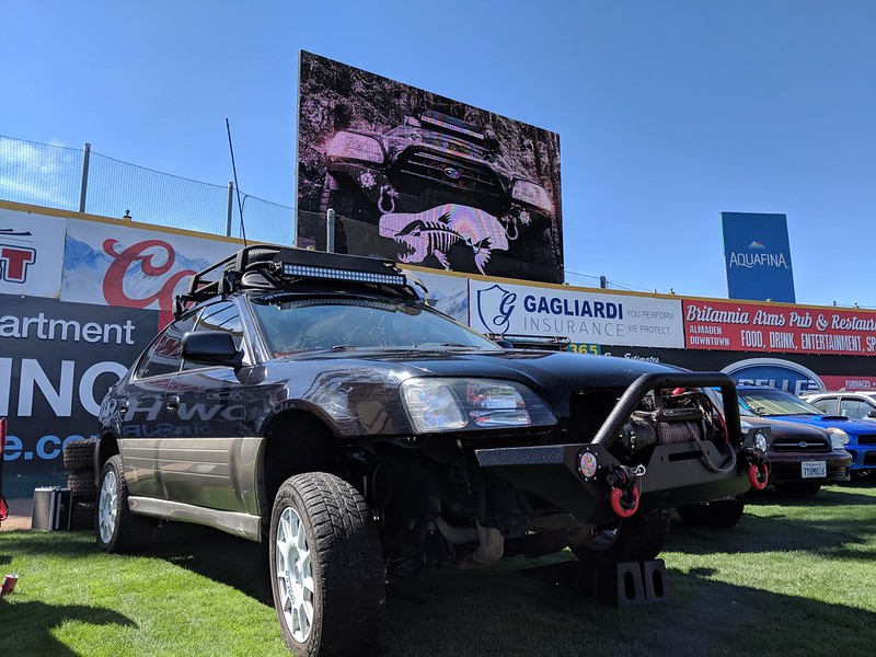

Been super busy the last few weeks between work and installing the monster lift! Getting tires and rims soon!
At the SubieFish booth at Bay Area Subaru Meet 2018!
SubieFish 5.5" subframe and strut lift with rear Tacoma strut conversion
6.5"-7" travel, 4" down at all 4 corners (2.5" up travel in front & 3" up travel in rear)
Clearances (w/ 215/60r16 = 25" tires; going to 28-29" tires very soon):
Radiator support -> 16.5"
Oil pan -> 10"
Mid-body Pinch weld -> 14"
Rear Differential -> 8"
Misc parts used:
Megan rear control arms
Bilstein 5100 rear struts (fitment from Gen1 Tacoma front)
Fox springs
'04 Outback front swaybar (21mm)(with polyurethane bushings)
SubieFish Swaybar Disconnects (currently Beta testing)
custom built 2.5" catback exhaust w/ DynoMax muffler (too loud, going to add a resonator back in)
Whiteline rear trailing arm bushings
