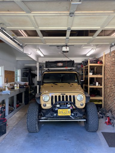

I have a Tepui mounted on my trailer. At one time I took it off and leaned it against the wall in my garage for a month. It didn't seem to care. I did set the bottom against the wall so it was sitting on something solid.
Most of the RTT's out there are built very similar with the only real differences being quality. Mine not being a Smittybuilt, I would bet their similar enough.
As for taking it on and off, mine only sits 5 feet off the ground and its a pain to take off with two people. I actually considered making a hoist in my garage to remove it. Its a little over 100 pounds and awkward. Once on the ground I used small furniture dollies to scoot it around. If you had a hoist or made some kind of a ramp to slide it on, I guess it wouldn't be too bad.
