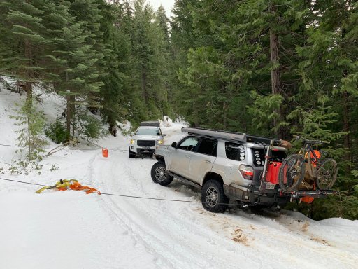

I thought about this thread while winching last weekend. We winched A LOT! Our snow wheeling trip felt like an episode of 4wd Action due to all of the winching. Here are a few of the thoughts that ran through my head.
1. Steel cables are heavy! After a couple of winching episodes fatigue will start to set in and pulling synthetic line is just plain easier and safer.
2. As fatigue sets in you are more likely to make mistakes like forgetting to wear gloves or placing the damping blanket over the line. Synthetic line is more forgiving of such mistakes.
3. Coiling up excess line on the grill/bumper to be ready for the next pull is a lot easier and less damaging to paint than steel cable. This applies to prep before water crossings as well where you want your line available quickly.
Another semi-related but important consideration is having enough winch points on each vehicle AND having enough recovery gear that can be quickly deployed in emergency situations. Having 1 winch in the group sometimes isn't enough.
On the road back to town we came upon a corner that had almost 2' of snow piled up on the "hill side" such that it created a slope. The snow was slick and my buddy's rig slide sideways and just barely stopped before sliding off the road. The large trees would have stopped the rig but not before doing extensive damage (totalled) to the top and side. With him standing on the brakes we set up a basic winch recovery but as he pulled forward the rear of the rig started sliding off the edge. He has recovery points on his rear bumper so I quickly deployed a snatch block winch setup off a tree to his left and secured his rear bumper. We could then inch him forward until he was securely back on the road. Before he was safe we had to reset his winch to another tree which require me to reset my line so it passed under his because his new tree was higher on the slope than the previous one.
This setup required 2 winches, 2 tree saver straps, 3 bow shackles, 1 snatch block, 2 damping blankets, and nearly required a winch extension strap/rope. The point is, sometimes you think you're done with the hard stuff, you're cold and tired and then disaster strikes and you need to act fast. We winched well over 15 times in 2 days. It was a great learning experience. :)
To his credit, he did everything right but the curve was just flat out dangerous. Two properly built RZR sidebysides had a similar issue here the evening before. I only made it through because I took a high line and was going a little faster with grippier tires.
In this picture my line passes over his line and when tensioned they didn't touch. After resetting his line to a tree higher up on the slope I had to reset my line so it passed under his line to avoid the lines touching.
