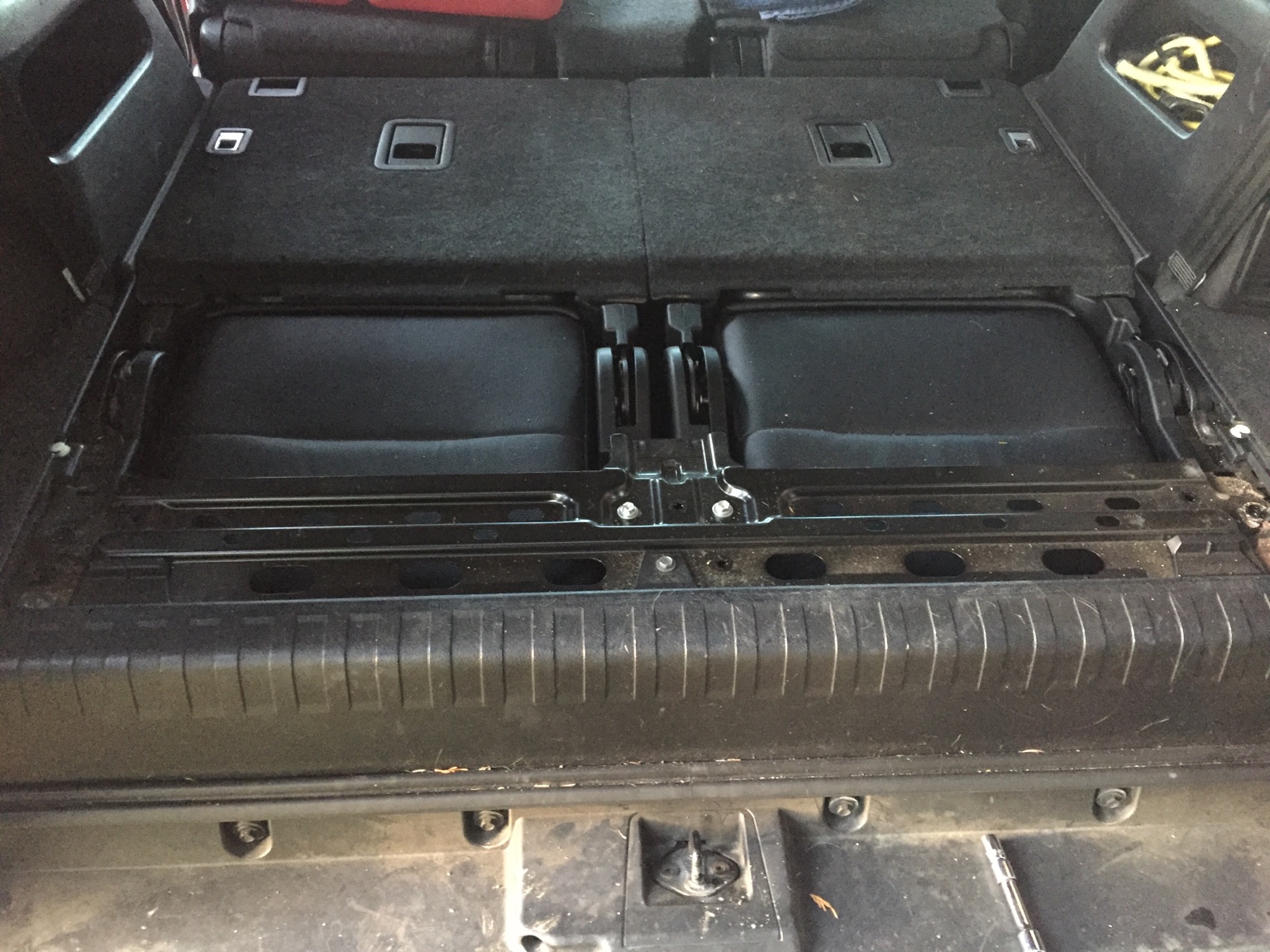

So I've decided I'm going to use these points (where the 3rd row seats were mounted) to mount the cabinet to the body of the 4runner, just for a bit extra stability
I decided to go with 5/8" thick fir plywood for the base. Going to build the cabinet on top. Drilled the holes shown above to mount it to the points corresponding on the body.
