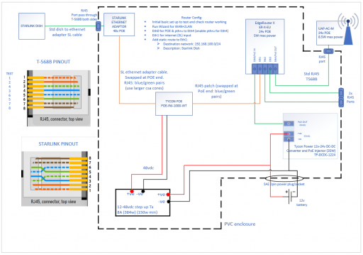

System as it stands at the moment in the attached schematic.
Now being built into a box for fitting in the truck. Photos to follow.
  • Visio-130 network (8).pdf

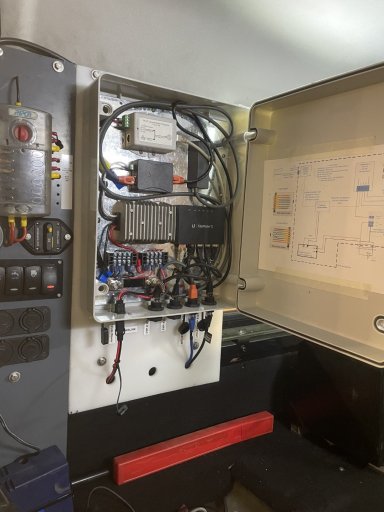

Final working version. A bit of cable tidying to finish off. I've deliberately left the swapped SL cables a bit long for now, to allow for mods/repairs etc....
But it's working and will be permanently mounted in the truck at the weekend.
Junction box is a bit bigger (400x300x120mm) than I was hoping for, but gives plenty of room internally and is fine for the place it'll be mounted in the truck. Lid is both removable and hinged.
Would be an easy change to run off 24vdc.

If anyone wants to set up the same system, I can let you have a copy of the EdgeRouter config file. There's a couple of steps needed to get it all working - it's not plug and play ......
Final test - running off a battery with no charging - SL ran fine until battery voltage dropped to around 10v, then the 48v PoE injector wasn't injecting enough to keep SL reliable. Not sure what the 48v side dropped to, but now know what to set a low battery voltage alarm at - 10.5v.
Obviously, duration of operation without charging will completely depend on size of the battery bank it's running off, but low voltage set point is good to know.

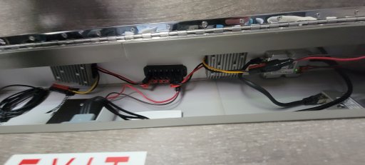

Im redoing it right now so Im using the sl router, waiting for the new poe injector and the cable converter to come in. The cable converter takes the standard cable plug and conveets it to an ethernet outlet without cutting the cable. The poe injector is the same company and it seems like the most simple way to do it. When i get those in and ill post it up on how well it works.
Here are pictures of how it was wired before. The stepuo to the pow injector, then the passthrough so i could hook it up outside. I believe the passthrough connector was my problem in the whole thing.

Got the 12v system hooked up for the starlink. super simple plug and play. on the initial speed test im getting 112mb download which is about apot on for what I was getting. Best part is I can use my router instead of SL. The two items on the first picture are the converter from the SL cable to standard ethernet. Other is the POE injector that also has surge protection if I had a place to runthe ground wire.
Nice work.
Surge protection ground wire could go to the chassis, but it really ought to go to a proper ground spike. I've seen some grounded to the shore power earth connection.

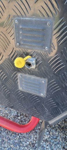

Final install - set up and working. Two external RJ45 connections - one for SL dish and one if I want to put the UAP outside. Plus I have 2 ports for direct conn to the router if needed.

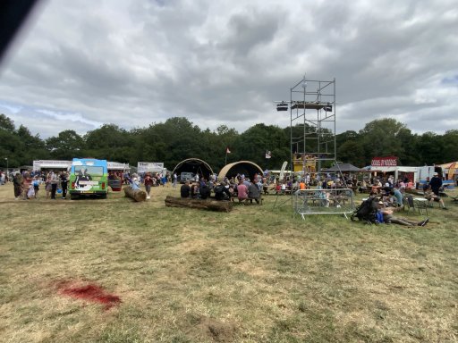

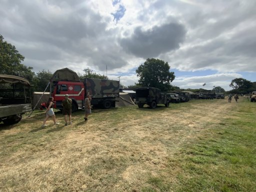

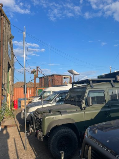

Update, all still working well, internet wherever and whenever we need it.
Also put to good use at a recent Military Vehicle Show where cell service is poor at best, but when there's several thousand mobile phones trying to use it, it just fails completely.
We used 3 Starlinks (2 on a load sharing/failover router, and 1 as a stand alone) to provide wifi around the show fields for main gate entry, traders point of sale devices, including the all important bar, and comms for the show organisers.
At one point we had close to 1000 users connected, and ended up having to ban the likes of Youtube, Tiktok etc... due to massive amounts of data usage chewing up bandwidth.
The whole system was built using Unifi kit and managed using Cloud Key.
WiFi AP testing
Spot the two SL dishes and an AP
Initial router, radio link and AP testing
Radio Link and AP on the Scaffold tower middle of the entertainments field.
