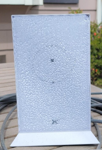

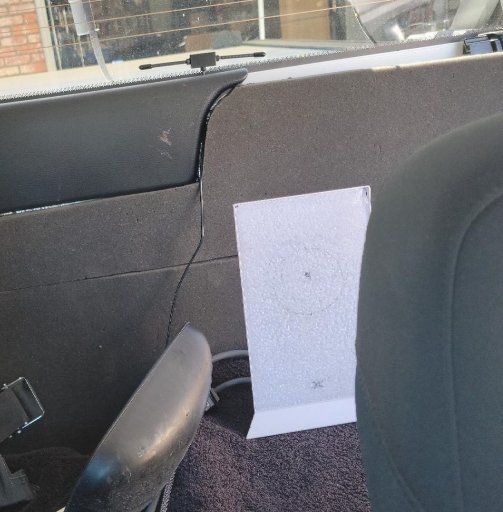

Well, I said I would post mistakes, so here's the first (hopefully save someone else the bother):
That right there is a shattered piece of safety glass. Yiikes! I thought everyone was using Gorilla Glass or some such on things like this (or heck, why glass at all?) It still works just fine:
So, new rule - don't fumble finger the router over a hard surface!
I have a ticket into support to see about a replacement. Until then I've taped over to keep the glass from wandering off. Should have more pics by EOD.

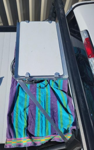

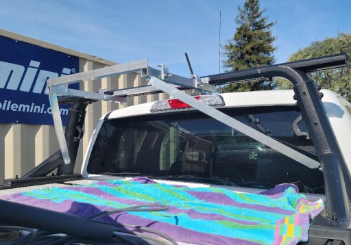

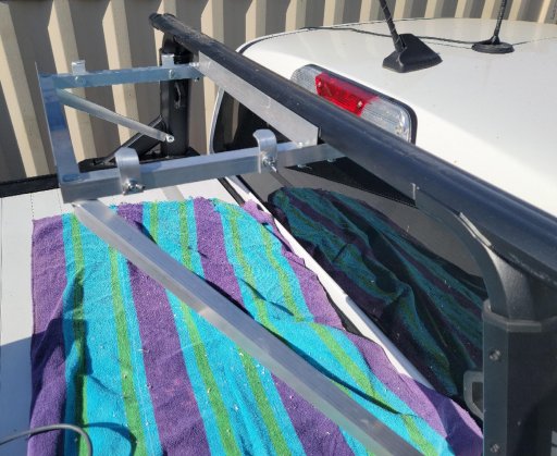

Here are some "rough cut assembly" pics of the build for my truck. Pieces are pretty much all HD, aluminum lengths, 5/16ths tee bolts.
20220507_163951 SB 1.jpg20220507_164001 SB 2.jpg20220507_164257 SB 3.jpg20220507_164320 SB 4.jpgScreenshot_20220507-165422_Speedtest SB 5.jpg
Dishy wasn't happy about being tied down flat, but still produced decent performance.
Remaining steps:
1) Disassemble, sand/grind smooth, prime & paint, reassemble with weatherstripping to pad the dish a bit.
2) Rework the networking cable to route into truck cab and quick disconnect so can move off of truck as needed.
3) Round up some "security nuts" to keep honest people honest - I had no idea these things are going for more than double on Ebay - yiikes!
More pics once I get those things done.

Great service from Starlink!
COMMENT FROM Victoria
Hello Derek,
Thank you for reaching out! We';re sorry to hear your router arrived with some damage. We went ahead and created an order for a replacement router to be sent out to you as soon as possible. We've updated your order to the highest priority possible to get this out to you. You are free to keep or dispose of the router at your discretion! You will receive an email with all of your tracking information as soon as your order ships. We hope this helps!
Should we be able to assist further, please reach out in a new support ticket!

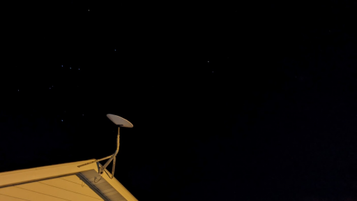

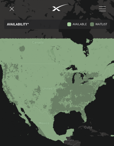

I have been a Starlink user from home since March 2021. I initially signed up to be a beta tester in late 2019. Starlink is great and not even in the same league as other Satellite ISP's. I was a HughesNet customer for 7 years prior and hated every minute of it! Every sub 1mbps download with 900ms ping minute of it!
My dish has been roof mounted since April 2021. Dishy (yes that is the name SpaceX gave to the round dish) has been subject to snow, ice, -22°F to 110°F temperature, 95mph wind, torrential downpours, smoke from pasture burning, dust and humidity. In the last year (including the beta period) I can count the number of outages on one hand. This has been a life changer since I live in a digital Bermuda Triangle with no cell coverage. My monthly bill just went up to $110/mo, but I would be willing to pay much more than that for the service!
You will never catch me trying to take my dish overlanding! I go on trips to unplug and get away from everything. If you work from the road or live on the road, do your thing.
If you are excited about the portability of Starlink, first check out Starlink's Availability Map to see if it will suit your travel plans. Starlink's portability is only available in areas that are not waitlisted and does cost another $25/mo. Starlink
In regards to cable attached to the dish, it is just a basic shielded network cable; around 26awg from my experience with a neighbor who cut their cable with a lawn mower.
Also, you don't have to use the Starlink router.

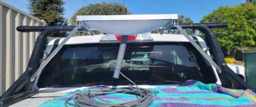

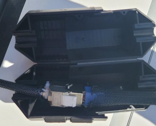

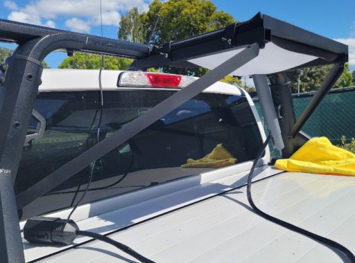

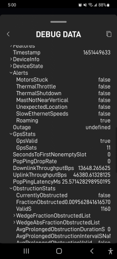

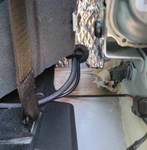

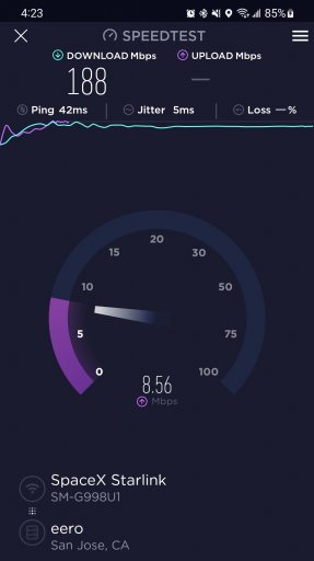

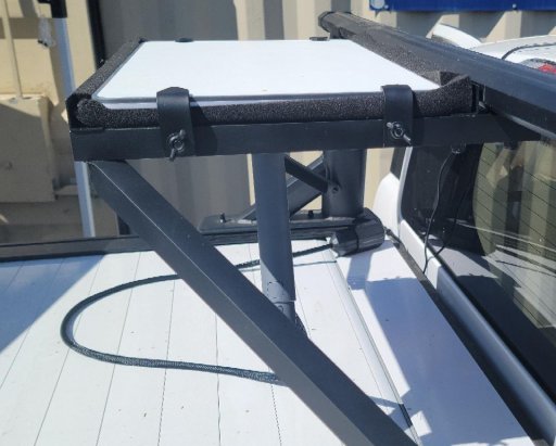

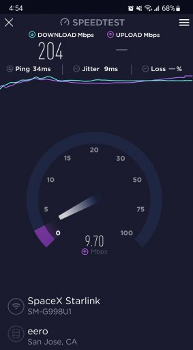

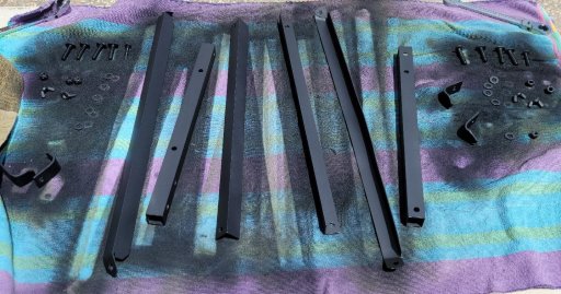

OK, goal in sight. Got the cables re-worked, the dish mounted with foam buffer and took it around the neighborhood for some spot tests.
Quick summary, Dishy stayed connected most of the time (apologies to Starlink, as I forgot to Stow and Disconnect between stops), but Dishy liked a north/south orientation versus east/west. There is about a 5 second delay in reporting a loss of signal or disconnect, and a couple of times Dishy went offline to try and adjust its orientation, eventually reporting a "motor stuck" error, but then came back online. Performance varied, but generally in between 40-200 down, 3-20 up, 25-75ms latency and 5-35ms jitter, all of which would be fine compared to what we have experienced traveling using distant cell towers.
The mount seems to be working just fine, but I have a few more minor mods (plasti-dip the retention hooks so as not to mar Dishy, replace the existing nuts with security nuts, install square tube caps, mount a hook to manage the cable better). Still, it is good to go in terms of taking with us on adventures going forward.
I may try traveling a bit without paid Portability to see if it works (rumor has it that it will until 3-June, but my roaming bit is set to false, so we'll see), but I'm OK paying the additional freight in exchange for the service, especially if it hastens the arrival of Mobility. As other posters have noted, this usage (overlanding) pales in comparison to the real good this service provides to currently unserved/underserved netizens and the brave defenders of liberty in Ukraine; game changing in both cases.
Anyway, here are some pics - they should be self explanatory, but let me know if any questions.

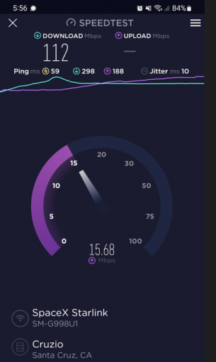

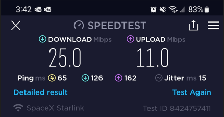

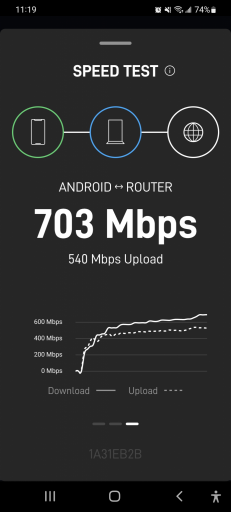

Heh, if I could get Hotspot where we go I would gladly do that, but, you know, overlanding......
Starlink service quality varies and will continue to vary as a result of numerous factors.
We typically get downloads in excess of 100Mbps with <60ms latency and minimal jitter, which is more than we need.
Our worst Starlink performance so far was in a dry lake bed north of Bodie where we experienced 25Mpbs down with 65ms latency and 15ms jitter, downlinked into Oakhurst. But hey, we had service, and my cell analyzer couldn't pick up anything.
More typical is our experience from Prewitt Ridge into Santa Cruz (112 down, 59ms latency, 10ms jitter)
Starlink is a game changer for us. YMMV.
Here is Bodie vs Prewitt Ridge within the last month or so:
