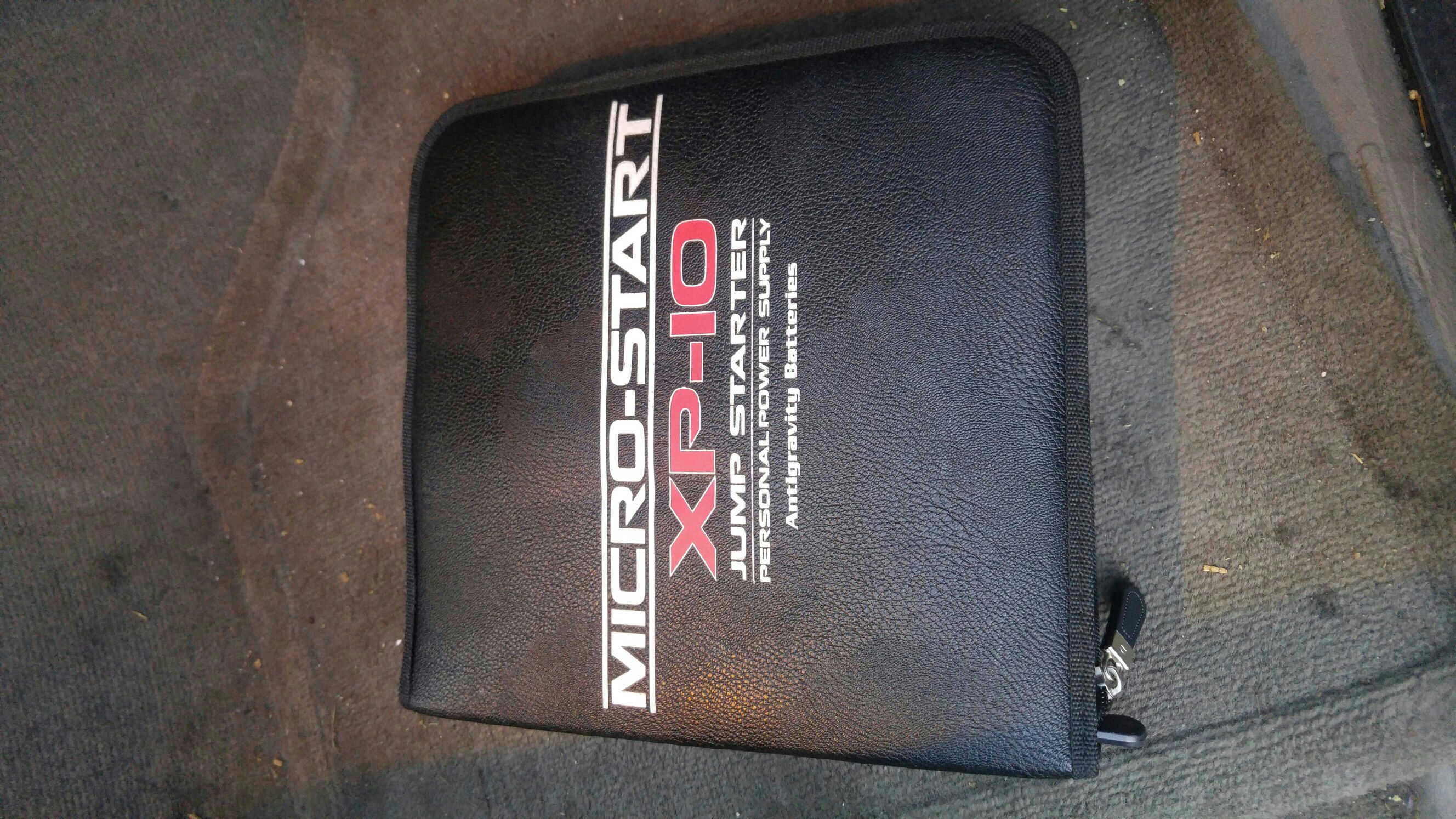

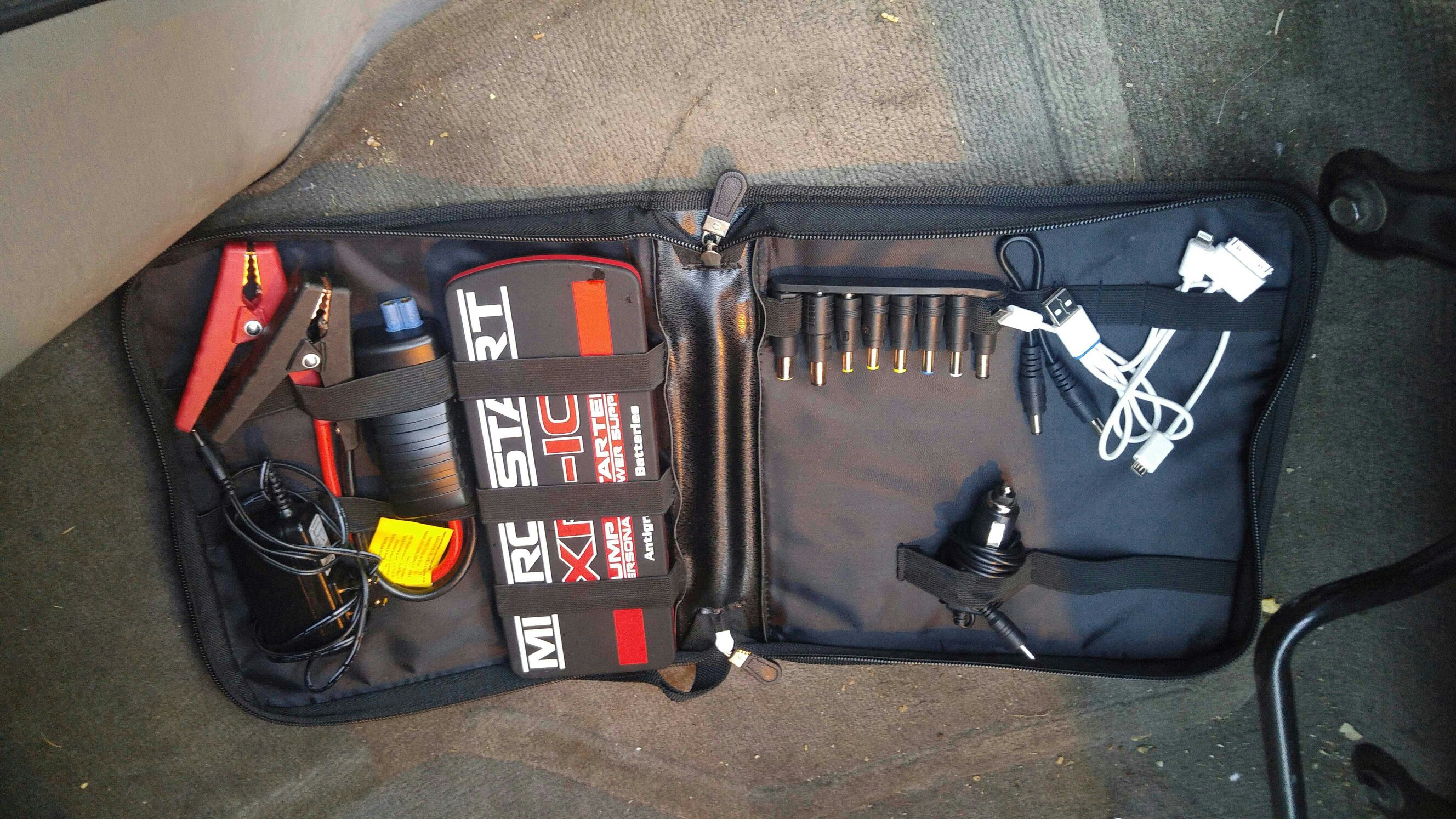

I also am about to replace my main battery with a new one, and use my current battery in a battery box in the rear cargo are...people however have commented on the gasses released by batteries espacially inside the cabin...so i will be looking at a decent "jump-pack"...especially the low profile horizontal ones.....keep you postedView attachment 6341
@Luis Merlo take a look at the micro start xp10 battery pack. I absolutely love mine and it comes in a handy carrying case that fits right in the map pocket of my truck.
https://www.amazon.com/Antigravity-Batteries-AG-XP-10-Multi-Function-Starter/dp/B00MQ5Z5F2
Sent from my LG-H810 using Tapatalk

^^x2 on the Microstart. I've used mine to jump several cars and it holds a charge so much better than my old lead acid jump packs.
The xp10 is the biggest one they make and it's jumped my 5.9 dual battery powered diesel a couple of times.
