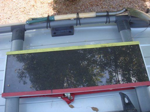

I've done it. Tempory for my Ham Radio stuff. I first did it for a Mobil Field Day station. This was running a battery that we independent of the cars electrical system so that we could claim extra points for not being on a gas powered source. It also eliminated some of the alternator type noise inherent in a car's electrical system. I have since used this setup when doing service events so that I do not have to worry about the battery getting run down for hours on the radio.
It is running into a 70hr battery and I have since added an inverter to the equations for use in remote locations for work to run a printer and charge my laptop.

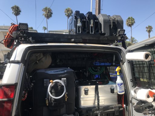

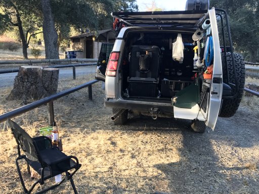

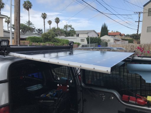

I made an under-the-rack solar panel slide using 80/20 extruded aluminum. 200 watts....Works really well. Doubles as an awning :thumbsup:
Even with the jerry's and water tank, I get about a 2 amp trickle charge with them stowed away. 10-13 amps when pulled out
View attachment 33984 View attachment 33985
Do you have anymore pictures or a detailed write up? I've been wanting to do this style also.
Jeff Blake

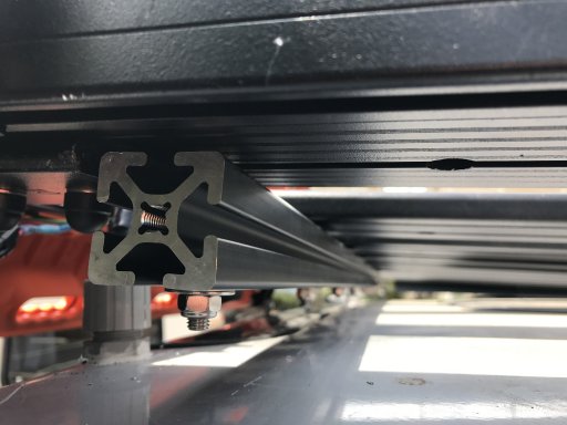

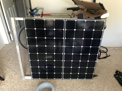

Hope this helps
Solar panels are framed in aluminum angle (architectural), and aluminum u-channel
The two 80/20 products are 1.5" smooth t-slot and plastic glide track. custom ordered w/ access holes drilled in the t-slot
Hang M8 bolts from the underside of the rack (front runner racks are key here, they have t-slot too).
Through bolt the t-slot track using locknuts and fender washers
For the solar panel frame, countersink the glide track and affix using flathead #10 screws every 4" or so
Also added a deadbolt latch, handle, and 2' threaded rods to secure the handle to the opposite edge of the frame
