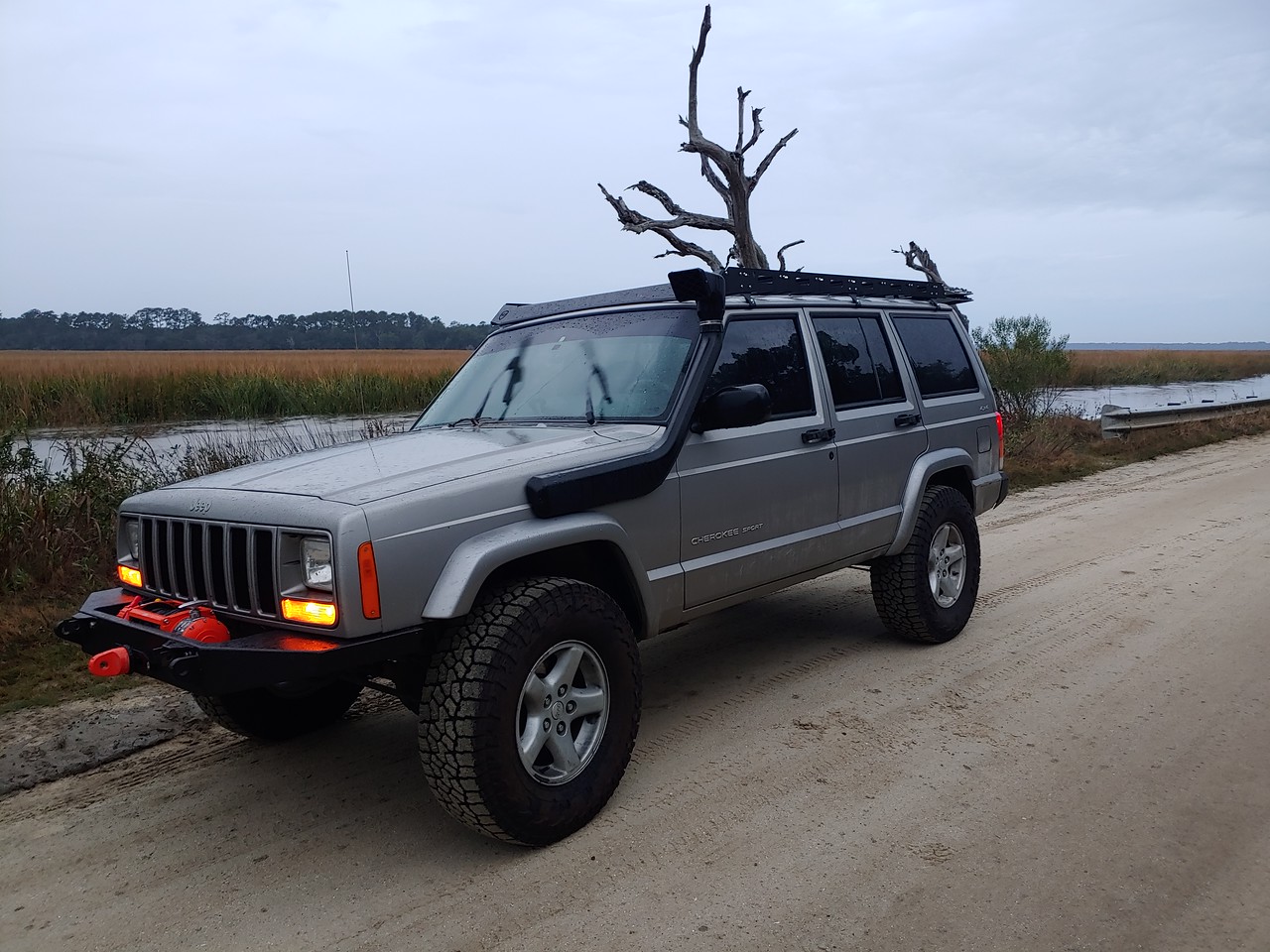

I installed one this fall. It is well sealed against water intrusion from end to end. But my XJ isn't sitting on 6" of lift, it's on 2" and the factory intake was only about 30" off the ground. At least one water crossing on my planned spring trip can be over 30" of water depending on rainfall. That's reason enough for me to justify drilling a hole in the fender. I also considered a cowled version, but it was 3 times the cost.
I love your XJ. built perfect IMO!

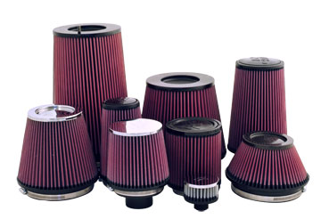

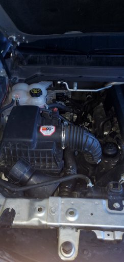

I have used K&N filters for many years and although they cost more initially, they are worth the investment because you clean them when they get dirty, put them back in and you get a better performing engine with them
I live in New England, and with the amount of moisture out here has made me curious if I would NEED one. I currently use a "normal" K&N air filter on my Ranger and those are pretty pricey, but I just have to clean it vs replace it. Any thoughts from the community?
I'd take those K&Ns and toss them in the garbage, or sell them to someone who just has to have it. Paper/fiber are much better at keeping out contaminants. Here's a test done to ISO standards on the K&N vs something like a stock replacement AC DELCO filter. K&N is a good marketing company. OEMs spend a lot of time money and resources finding intakes that flow plenty of air while remaining quiet and filtering well. Believe it or not they get it right the vast majority of the time and no bolt on or drop in mod is going to make their work better and in many instances will make it worse. For the cost of a K&N for my 4.0L I can buy WIX filters for the next 120,000 miles.

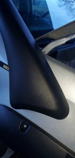

As posted earlier, a snorkel doesn’t have to require a hole being put into your fender... This spring when I finish putting my Bronco back together I’m going to be running my snorkel inside the cabin... if I can find a decent way to rout it, otherwise I will be going into my cowel and have the ability to add a dust prefilter when needed.
