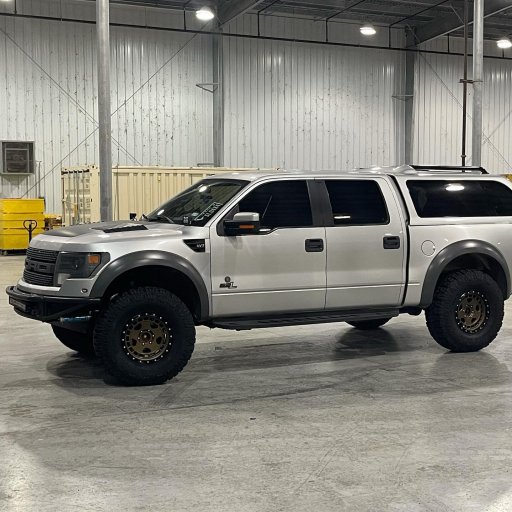

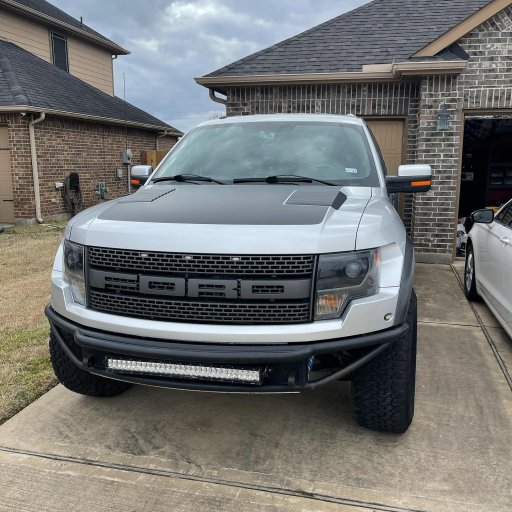

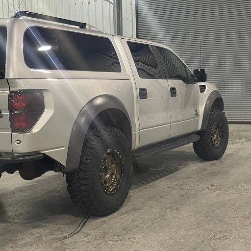

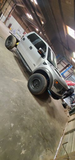

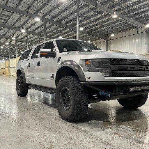

The Truck when purchased in Jan 21'
2013 Ford F-150 Raptor CrewMax
129k miles on the clock
King 3.0 coil overs
Method NV Matte Black Wheels
37" BFG K02
Snugtop XTR Camper Shell
Note: Not the best at taking pictures. Most of these were taken for my own personal documentation and did not have build thread quality in mind. So moving forward I will try to take better pictures for you all. But this first post is basically the forsale ad pictures.DriverSide Front.jpgDriver Side.jpgDriver Rear.jpgRear View.jpgRear Passenger Low View.jpgPassenger Side View.jpg

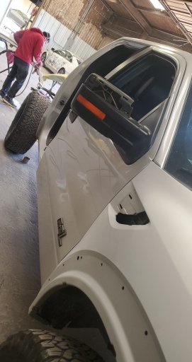

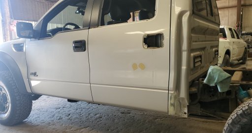

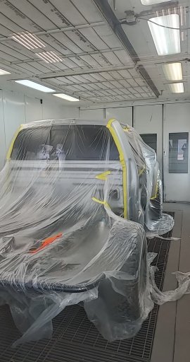

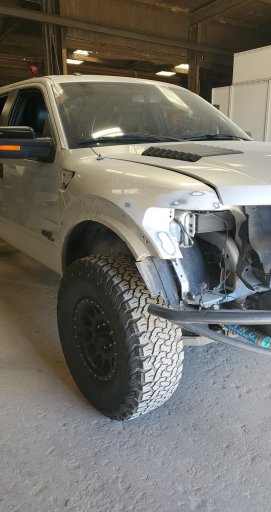

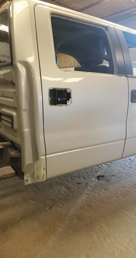

So, first thing to do was take care of the rust! This was apparently a Nebraska truck and well....midwest rust came with it down to Texas. Thankfully I was buying it from a guy that worked at a bodyshop.
Cab Corners.jpgFront Passenger Fender.jpgMirror Caps.jpgRear Driver Side Door.jpgGetting Sprayed.jpgTorn Apart.jpg

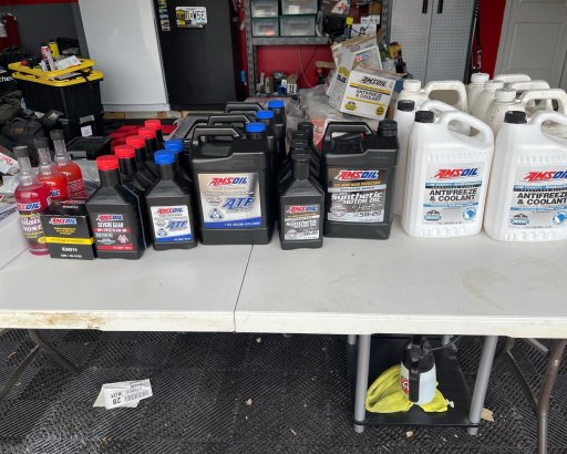

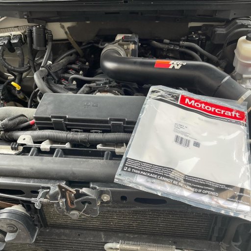

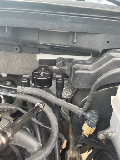

Maintenance has begun! 129k on a truck is probably not the best starting place for a drive anywhere reliably truck lol.....I am a sucker for punishment I guess.
Started with changing out ALL the fluids to Amsoil. I am a dealer and have been using it in all my cars for 15 years.
Replaced the rear diff cover with a Ford Performance cover for easy of changing and filling and it just looks cool (sorry, didnt get a picture of that)
Greased the slip yoke as well to eliminate that ford clunk. Why they don't have a zerk I don't know but some cuss words came out during that.
Did the Fuse 27 fix to avoid any fuel pump failures

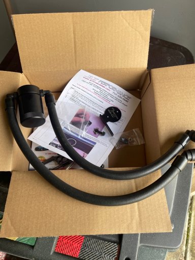

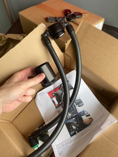

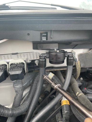

Installed JLT air oil separators for driver and passenger side because overkillNew Fluids.jpgFuse 27 Fix.jpgJLT Driver Side A-O Seperator 1.jpgJLT Driver Side A-O Seperator 6 Done.jpgJLT Passenger Side 1.jpgJLT Passenger Side 3 Finished, Showing Line Configuration.jpg

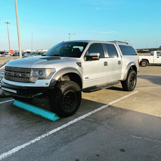

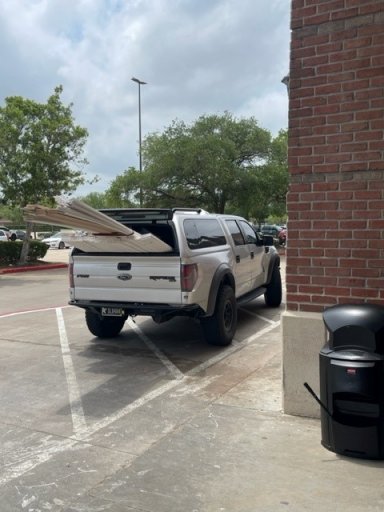

Per mandate of the Raptor community, I had to take a drive to Starbucks and the mall. I couldn't commit to Starbucks and this was the closest thing to the mall that my truck was going to.hauling wood.jpg

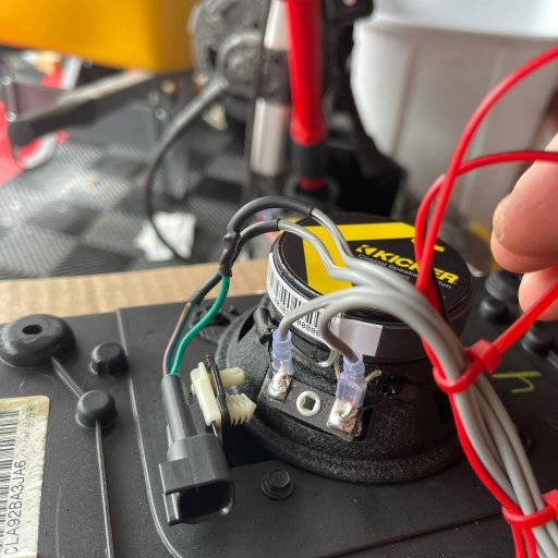

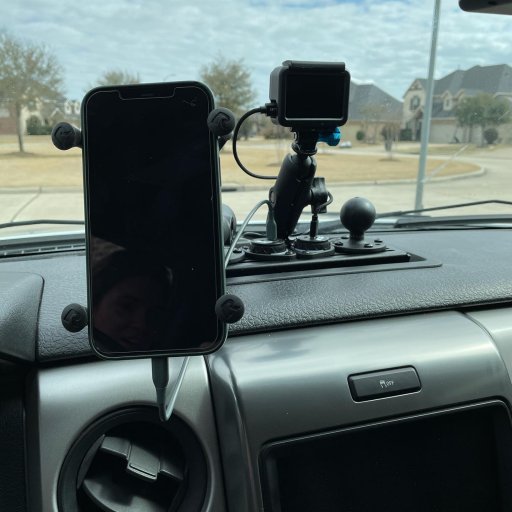

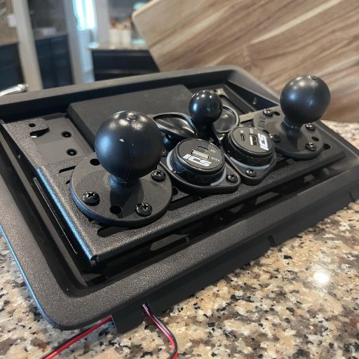

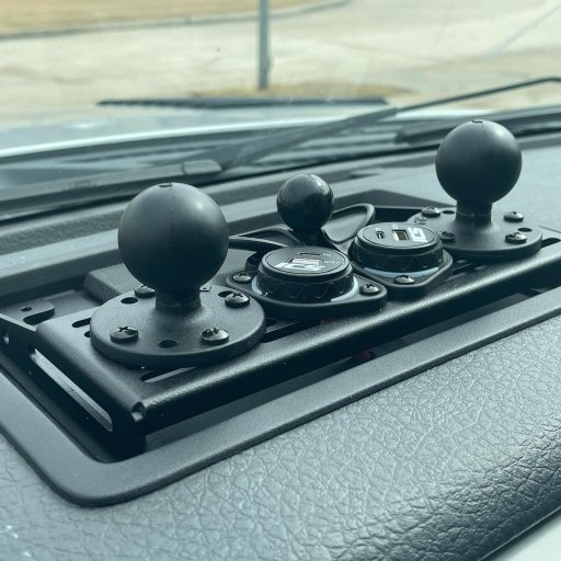

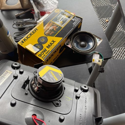

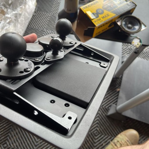

So, I guess this is an Overlanding community let me get back on track with something more Overlandy. Audio isn't necessarily an upgrade but while i was installing Ram mounts and power for my devices I upgraded the speakers while I was up there.
The Ram mount looking USB/USB-C power modules are from ICS Fabrication. They're pretty slick and if you have a mounting plate for ram mounts they really make for a clean setup, I had them in my Tundra as well. Through a GoPro up there to experiment. That is a work in progress. I was hoping to use it as a dash cam but it doesn't work very well for that. I'm working on getting a different mount to install a second GoPro so I can have cab view and forward facing view for time lapse.Figureing out Placement.jpgMounting Configuration.jpgThat will do.jpgModifing the mount for a bigger speaker.jpgRam Mount Installed.jpgRam Mount Final.jpg

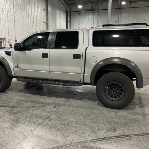

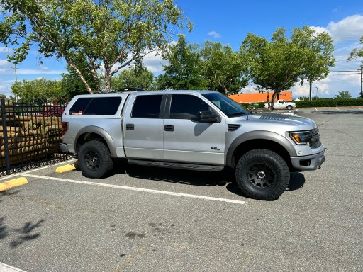

I'm not sure where I'm at in my timeline maybe Aug 21'?

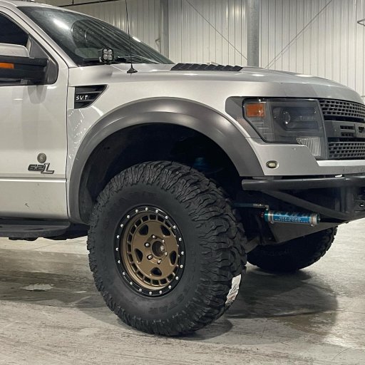

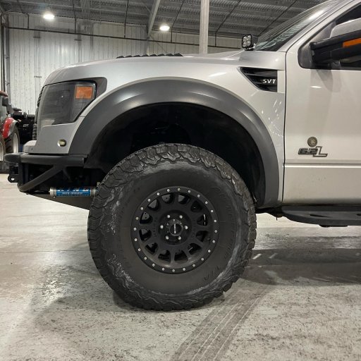

The BFG's were getting fairly bald and one of them was leaking. So naturally I had to go tire shopping! Also decided to switch up the wheels since Method NV's seem to be the go to for everybody it seems like.
Tires I chose to go out of my comfort zone and went off of youtuber reviews. That's a scary thought.
Milestar Patagonia MT 37x12.5R17LT
Fifteen52 Turbomac HD 17x8.5 +0mm
Also chose to go with Balance beads instead of weights
A lot of firsts with this.
Method Front.jpgMethod Side.jpgMethod Passenger.jpgFifteen52 Front.jpgFifteen52 Side.jpgFifteen52 Rear.jpg

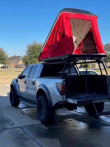

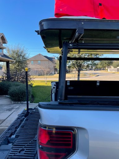

The REAL reason I sold the camper shell was I fell into a stupid cheap deal on a Leitner rack, Tent and decked storage system.
I picked this rack up from non other than Demolition Ranch from Youtube! Unfortunately it was shot show and I didn't get to meet him lol. While picking up the rack and tent there was a fellow overlander selling the decked system. His name is @Lonestarrigg at least on instagram. Not sure if he's on here or just the Texas overland Facebook group but it was nice meeting a community friend.Day 1 Decked and Leitner.jpgRoost First Opening 1.jpg

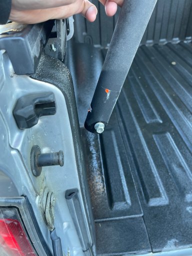

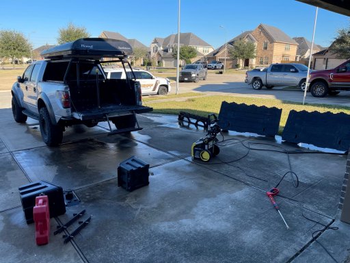

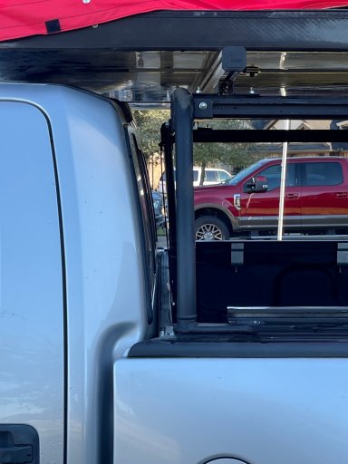

So previous post you see it all torn out of the truck. Everything was getting a pressure washing and I was taking inventory of what else I need to buy and order to finish loading out the bed properly. As you can see in the pictures I attached, the Leitner rack is bent a little from improper storage and neglect, so this weekend its all coming off to try and get bent back into shape a little and re-squared on the truck. New hardware, brackets, and misc. accessories have been ordered.
The Decked system has a few holes that need silicone to attempt to make it a little more water resistant.
Also picking up a XL Gear pod this weekend as well.
Just another reminder, I've posted a lot of pictures, non of which have been outdoors camping related, this past year has been super busy. My wife was pregnant for most of it and our house was quite literally being destroyed as we were remolding it ourselves. So other than basic maintenance and cosmetics the truck has been on back burner until more recently. Now that i'm a father a spark has been ignited to get this truck in tip top shape and start taking the family camping.
Leitner Rack Bent Front.jpgLeitner Rack Bent Rear.jpgLeitner Rack Missing Bracket.jpg
