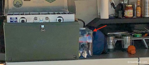

For cooking and drinking water when backcountry or when I wonder about the potability of available water, I use a clear 2.5 gal jug. Red arrow in the image below. Not flimsy in the least, either, it serves me really well. I got mine at a big box store or chain grocery, I don't remember. I buy inexpensive gallons of good spring water when I find it for my coffee and fill this jug with that.
2.5 gals can go a long way, and this jug sometimes serves--when running the interstate and not wanting to set up the trailer or pull out the black jerry if it's stowed--as my daily water source for drinking, cooking, and washing. It nestles right into the side of my kitchen box when on the counter.

As always, thank you for your knowledge on the subject! I have always liked the idea of the Front Runner Jerry Can, if I didnt have this jug laying around I would have bought that one.
The 2.5gal jug idea has caught my eye too. We dont bring shower water with us in the jeep, we just simply dont have the space for it. All of our water is used for drinking and a small amount of dishes. Love your set up though, the more I see it the more ideas start to float around in my head!
