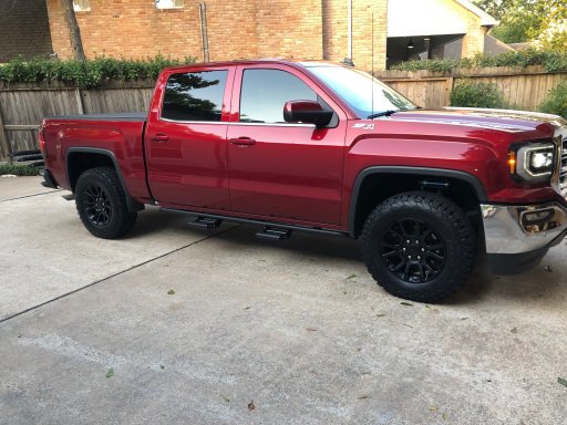

got the truck ready for a 3 week road trip. Went with 33" BFG K02s and got a set of N-Fab RKR rails with removable steps. My mom will be on the trip with us, so she'll need the steps. The good thing is i can unbolt the step part when we get back.

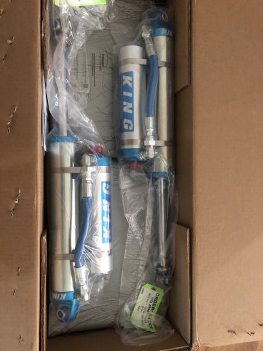

Looks great. If you don't mind my asking, what did the shock setup run you? I'm probably about due on mine and am looking for an upgrade over OEM.
stone150
Texas
Joshua
Stone

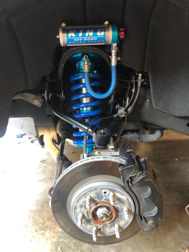

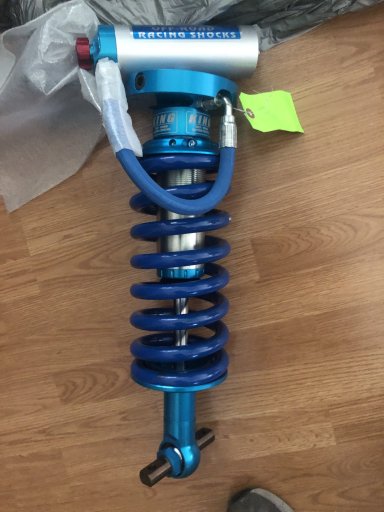

Thanks!, They are 2.5 OEM Series Kings with remote reservoirs and compression adjusters. The fronts are extended length travel giving 2-2.5 of lift in the front.
They are pricey and I haven't had experience with the similar Fox, or Icon, but for normal driving they are on par with GM's mag ride and well worth it IMO.
Awesome, thanks. I'll take a gander!
Shocks alone lifted the front? Did you notice if they had any other shocks with more than the 2.5" that you got
Yes, the shocks alone provided the extra lift, you have to spec the extended travel versions to get that. I should be able to get atleast 3" of lift by cranking the pre-load a bit. But I'm not happy with the readylift UCAs as they limit travel. I have a set of JBAs waiting to go on when I get back.
They offer shocks for different applications and they had them to fit with different size lift kits, so they may have one for your 3'"+ kit. But alone the shocks won't due to angles of the drive line.
