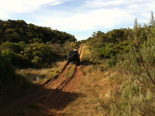

I have just finished building an off road camper trailer/base camp set up. It was designed to be dragged along with my custom Nissan Patrol. I live in south eastern Australia and we have some brilliant coastal national and state parks locally, this trailer was built to create a base camp to take day trips from. The first stage had one Howling Moon roof top tent and a shorter chassis, but with more kids arriving we needed space and a proper kitchen.
