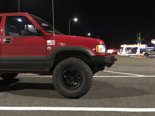

That is sexy. I need one! Tell me more about your bedlined trim panels and fender flares?

The bedliner is not the cheap aerosol can stuff because that comes off easily and doesnt provide enough texture. I bought the roll-on Herculiner which is a polyurethane type and it is much tougher and because they put small rubber chunks in, you get a nice texture. As for the flares, well I have none. Mine is a base model so it didnt have them so I painted the bedliner on to look like the shape of flares.

Well you fooled me. I have the flares. I think I will definitely do this. Did you remove the trim to roll it or roll it on in place?

No, the only thing I removed was the front license plate and spare tire. Everything else I taped off. The kit comes with a scotch pad to scuff up the paint. My first suggestion is to scuff up the bumpers with 120 grit sand paper and use a bumper adhesion promoter. I only scuffed mine up and some areas it didnt stick so well. The second suggestion is to cover the ground completely under the area you will be rolling it on. Alot of the chunks dont always stick and they come flying off. The polyurethane is really tough to get off of cement once it has penetrated.

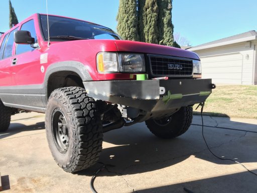

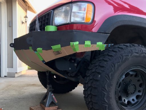

Well I was able to make alot of progress this week despite getting rained on one evening. Bumper is about 80% complete. Just need to weld on the section underneath the bumper, reinforce everything on the inside, make end plates and install the flush mounted led flood lights. Here is this weeks progress in pictures.
