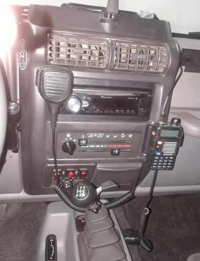

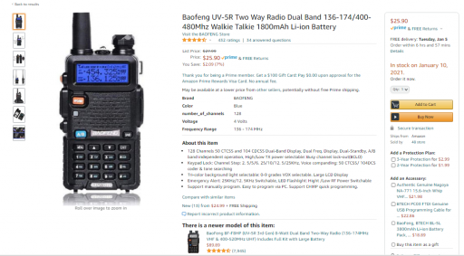

You don't have to spend a lot of money to get a GMRS radio. Technically, you can do it as cheaply as $25 by purchasing a BaoFeng UV-5R and calling it a day. Technically this lil' radio also covers HAM frequencies (I have my HAM technician license), but we'll be limiting ourselves to the GMRS frequencies on this trip.
These BaoFeng radios, while cheap, are not toys. You need a license to transmit on them (depending on the frequency, either a HAM license or a GMRS license). Please don't buy them and give them to your kids to play with.
It comes with a charger. So you'll need some sort of inexpensive inverter to plug into your cigarette lighter to charge it ($20 +/-). It wouldn't hurt to purchase a separate battery ($10.00) so you've always got a fully charged spare ready to go if needed. If you can get some sort of mount for your dash so it is always in front of you and readily accessible you'll be happier. You will get tired quickly of holding the radio in one hand and driving with the other, and I can guarantee you if you set the radio on the dash or seat beside you, it will fall on the floor out of your reach. I mention the one I use by Rugged Radio later.
Even if you've got a hard-mounted GMRS radio in your vehicle (like a Midland), it is really nice to have a separate hand-held for when you're out of your vehicle (you'll be glad you did). We spent a day trying to get through a muddy section once (with multiple vehicles quite spread out), and I was away from my Jeep a good bit helping, but I was still "connected" with my hand-held, so when they needed a chainsaw or my tire inflator to reseat a bead, I heard the request and could respond. I had it clipped to my jacket so my hands were free.
I have an upgraded version of this UV-5R (BaoFeng BF-F8HP - $90.00) mounted on my dash using a Rugged Radio MT-5R "single side radio mount" ($17.00 on Amazon) that works well. I also have a two-way radio speaker attached to the radio (is a speaker and a mic). You can get them from Amazon starting at $15.00 (BaoFeng BF-S112); there are plenty of options for these two-way speaker/mikes. I also have the BaoFeng battery eliminator (between $9.00 and $18.00 on Amazon) so my radio is plugged into a cigarette lighter outlet all the time (and that actually freed-up the battery that came with the radio, so I automatically had a spare battery now). I've also got an external antenna attached to the outside of the Jeep and connected to the little radio by a cable (but you could get away with using the antenna that comes with the radio or a cheap upgrade).
So this is my version of a "hard mounted" GMRS radio. I also have a couple of the hand-held UV-5R radios for use when I'm out of the vehicle. If you are going to get a BaoFeng radio, make sure you're getting an actual "BaoFeng" product and not a knock-off.

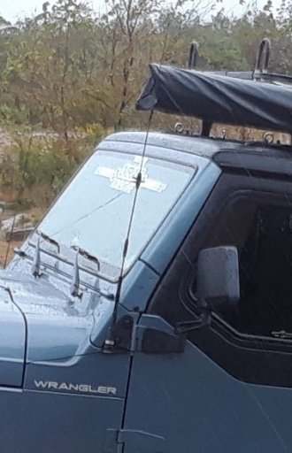

Here's a magnetic antenna that looks like it would work for GMRS use with a BaoFeng UV-5R (MHz numbers are approximate and rounded to whole numbers). I think I remember reading from someone knowledgeable about HAM radios that they'd rather have a cheap radio and a good antenna vs. having a great radio and a poor antenna.
Link: SMA-F Magnetic Vehicle Antenna UHF for BAOFENG UV5R Kenwood LINTON TYT Radio | eBay
These BaoFeng UV-5R Radios are a dual-band radio; they cover a large range of frequencies(VHF - 138-174MHz and UHF - 400-512MHz). The GMRS frequencies (462 - 467MHz range) are in the UHF range. Most antennas advertised as dual-band antennas are a compromise between the two. This antenna linked above is designed (or advertised) to work in the UHF 400 - 470MHz range. And is dirt cheap. As Neal A. Tew mentioned above, an external antenna on one of these little UV-5R radios can make a world of difference.
Some of the dual-band external frequency antennas (VHF/UHF) aren't designed or tuned (or advertised) to go above 430MHz. It might make a difference.
If you're looking for an external antenna for your BaoFeng UV-5R to use as a GMRS radio, look for one that covers the GMRS frequency range (UHF range) 462-467MHz.
This is the antenna (and spring) I'm using. It is way more expensive than what you would need for a BaoFeng UV-5R, but I got it with plans for later adding a "real" dual-band HAM radio to my Jeep. Still waiting to buy the "real" HAM radio (technically my lil' BaoFeng 8W radio is a HAM radio). I also had to purchase the cable and the antenna mount separately. As far as my BaoFeng radio goes for GMRS use, those little magnetic mount antennas would probably work just as well as what I've got now. But magnets won't stick to my Jeep's fiberglass top...
Link - antenna: COMET-NCG CA-2X4SR Antenna Mobile Dual Band 2m-70cm, CA2X4SR (hamradio.com)
Link - spring: COMET-NCG CA-SPR Antenna Accessories Other, CASPR (hamradio.com)

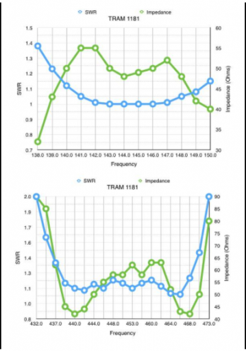

Absolutely!
Another antenna option, though a bit more expensive than Paul's suggestion is the Tram 1181/1185.
The 1181 is the NMO version
And the 1185 is the mag mount version
You will need an adapter to connect the coax to the radio, something like this.
I run the 1181 on my Jeep and keep an 1185 for the wife's vehicle. The magnet is super strong for such a small antenna.
From a review on the 1181 listing above. The 1185 should be the same. More than acceptable SWR on the GMRS frequencies.
