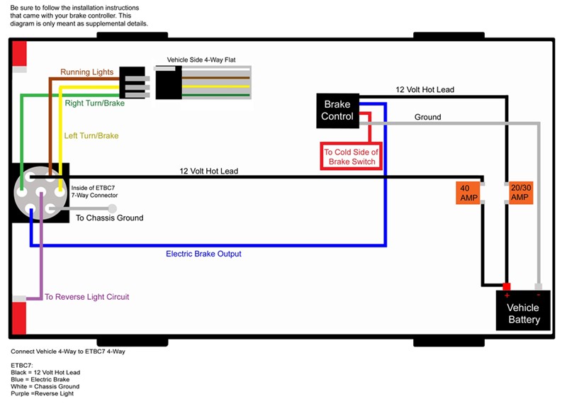

If you already have a 7-Way Trailer trailer connection at the back of the truck you might already have 30 or 40 Amp charging circuit installed. Here is the diagram I used when adding the tow controller to my 1997 Tacoma which included adding this 40amp charging circuit. you're interested in the 12v hot lead and Chassis Ground pins for charging your GoalZero.
You would need to wire up an adapter to connect the 10 gauge 12v line and 10 gauge Ground line to your Anderson plug.
