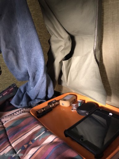

For lighting up there I use one of the pods from my solar Ready Lights (on the tray in image below), so don't need to run lights. It's all I use in the van for lighting, too.
Pro Tip: Get an inexpensive TV tray to use in your RTTs. Keeps pocket items from rolling around and getting lost in bedding, provides a stable surface for drinks, and is a great little lap desk, as well. I always know where my Streamlights are in the middle of the night, too.
Thanks, I'm definitely going to use that TV Tray idea!
