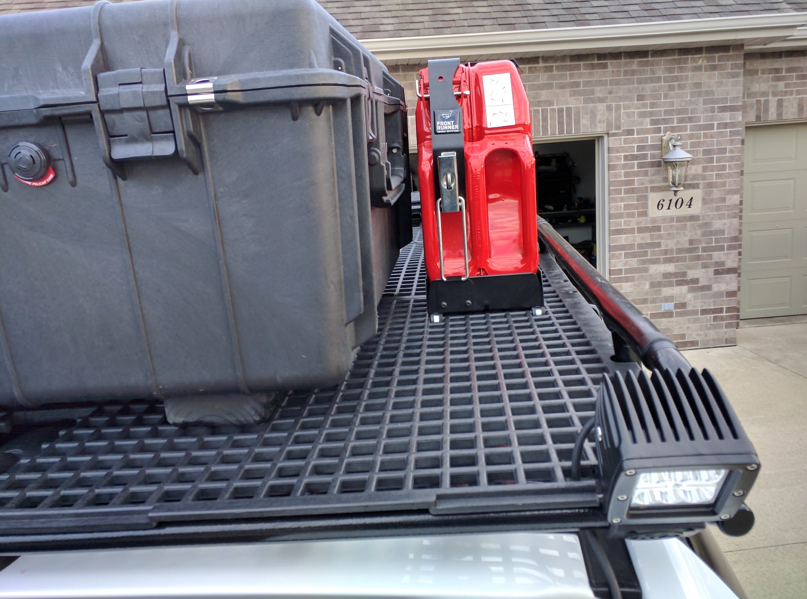

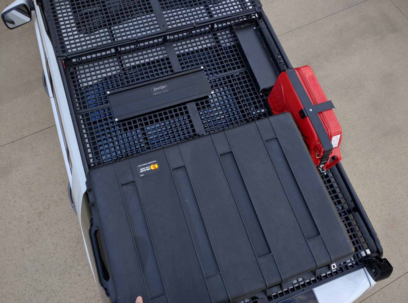

My setup is similar to above, but slightly different. Mine are removable (rather than bolted.)
I use (EO)2 mounts. I have used this setup to drive across major chunks of the country. No straps! Lock with padlocks on the pelicans, but easy to open the lid and live out of them.. I just chuck the camp gear down to the tent from the roof.
I have lots of big camp gear, standard sleeping bags, big self inflating air pads, etc. And I pack for up to 4 people when the whole family goes. So I need lots of space... Pelican 1730 Transport cases... 37.5 x 27.13 x 14.37" (95.25 x 68.91 x 36.5cm) (LxWxD) . Only 14.3" high!
The bottom part of the mounts are on the rack all the time. The chicken coop flooring I use is cut out around them.
The you can put the cases up there, the SNAP on and have a push lock.. so they lock to the rack.
Same height as a jerry can.
Here is a crappy video I made about it.
