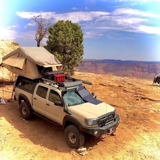

I have a topper on my Tacoma its a CX made in 2009 it has held up find with a 94 lb tent, front runner rack (64lbs( ish)) on the top, and me in it. (230 lbs). No cracks or anything to speak of. However, I am considering a larger tent and my wife is wanting to come along so while I was looking for something that might add that extra support, I found this: Buy a LoadMax universal roof rack support system 2010 - Current Unfortunately its an AU only company and its over $200 to ship.

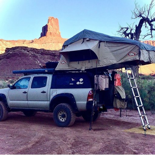

I’m running a Leer 100XQ on my short bed Tacoma with a Tepui Kukenam 3, I think it’s even called like an ultra light model tent or whatever. Anyway the tent weighs about 115lbs without anything inside it when it’s folded up. The shell was used when I bought it and had two cracks in the fiberglass on the drivers side when I bought it. I bought the RTT last fall and had it on the truck for about a month driving it daily with no issues. Put the tent back on this spring and have went camping in it several times and some mild off-roading with the tent on and had no issues with cracking or anything. So far I’m the only one that’s been sleeping in the tent and I’m about 180lbs. The tent will probably remain on the shell until like November when I remove it for the winter. I’m actually more concerned with the thin Tacoma bed walls opening up at the top than I am the shell cracking at the moment. I’ll be buying some bed stiffeners for the truck in the near future

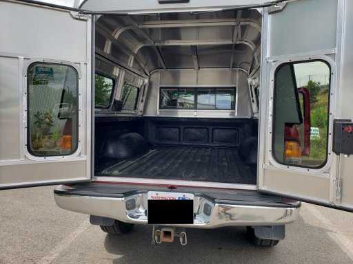

The commercial caps are the best for weight. They are reinforced in and out, and able to carry hundreds of pounds. I love the look, and modeled my cap after them when I built it. Others thing they are ugly. It's whatever you like cause it's your money.
I'm going ARE DCU after the first of the year.

And this is where I'm headed....maybe.

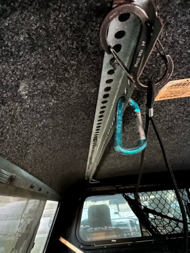

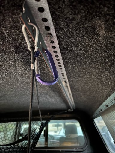

I haven’t had any issues with my RTT mounted on my topper. Have had it on for >2 years and been on some long multi-state overland adventures. My wife and I both sleep up there. We aren’t super heavy - 175 and ~115 (don’t tell my wife I put her weight haha). Hopefully my good fortune continues and I don’t run into any issues. I did reinforce the underside of the topper with aluminum strips that bolted through from an older model 4Runner roof channels. I also used Superstrut as cross beams to mount RTT.

Any photos of your aluminum reinforcement. I have been running a light tent on top of my old ARE CX topper and it’s held up fine. But I recently purchased a heavier tent and my wife is now coming along so it’s quite a bit more weight than I would like to run on it regularly.

Here you go. Nothing special but it keeps the pressure off the fiberglas and adds an underside support to match the top rails. I also have truck bed L-bracket supports which probably help stabilize the topper against the truck bed walls under the weight.
