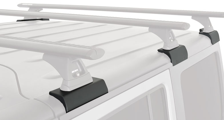

Personally, I don't like roof racks because they increase your height, COG and mostly look goofy on Jeeps. If I were to get one though, It would be the Rhino Rack Backbone. It's removable, and can use their Pioneer tray or platform.

The pioneer back bone system and rack seems ideal, but you are talking well over 2.5k for that system, and when all you are looking to put up there is ideally not that much weight. After riding with a jeep top heavy, that is not something I generally want to do. The AEV rack is sourced by the Rhino Rack folks, and assembly etc looks pretty good. If money were no option... but honestly it always is.
This is why the K9 seemed like a good way to get the same low profile as the AVE, Rhino Rack, and Frontrunner, but less invasive. While it can't hold as much weight, that it not a goal. When the rack is not on you just have two very low profile tracks. The other plus is welded, no bolts. The big fear is supporting just using the fiberglass.

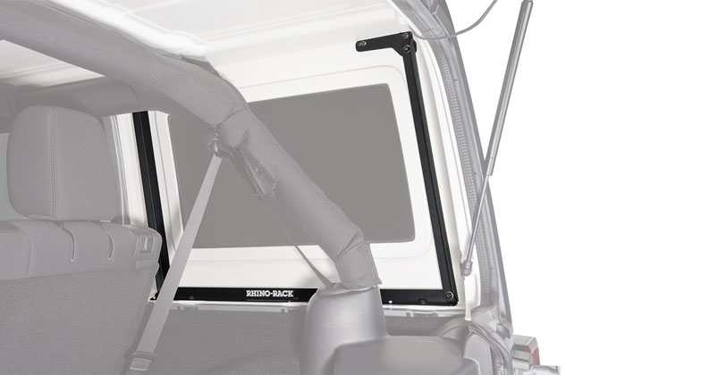

It's good to mention that on a JK make sure you get a rack that's supported by metal. If the rack mounts through the hardtop, make sure it has brackets that go through to the roll cage like the Frontrunner or Teraflex racks. Going through the roof to actual structure is what gives those racks the ~600lb ratings. The unsupported hardtop is only good for about 200lbs (and that's pushing it for offroad use) including the weight of the rack.
