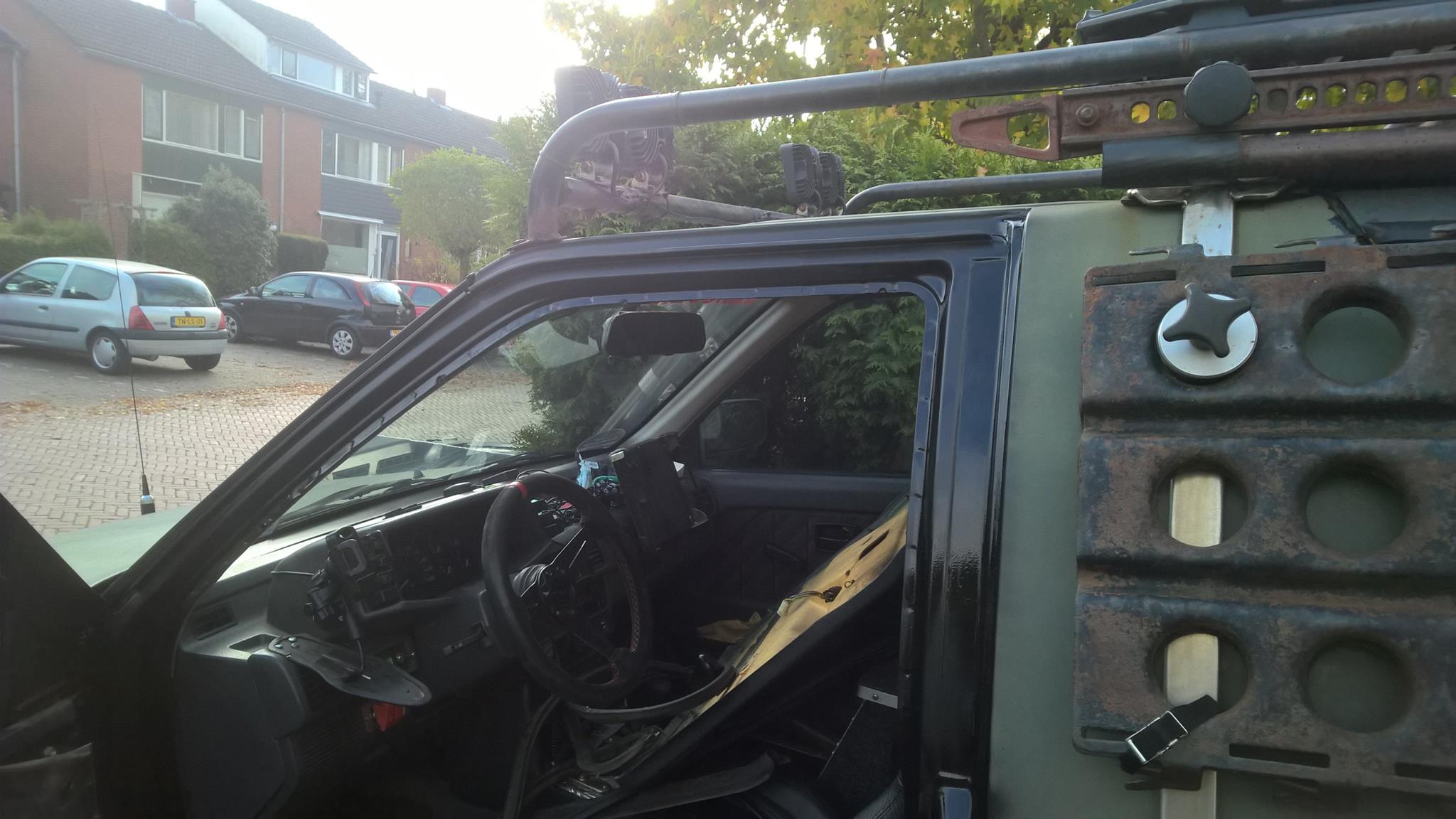

I worked today a bit on the Frontera.
I needed to extend my roof rack with a basket for the Oztent. But, I wanted it to be removable, and quickly as well.
So I did this.
So, to remove it, I just release one lock, and its
Wow, Robert, that is really a nice idea! The cam lock takes out any rattles, I assume? Stick a padlock on it and it will be nice and secure. Very clever!

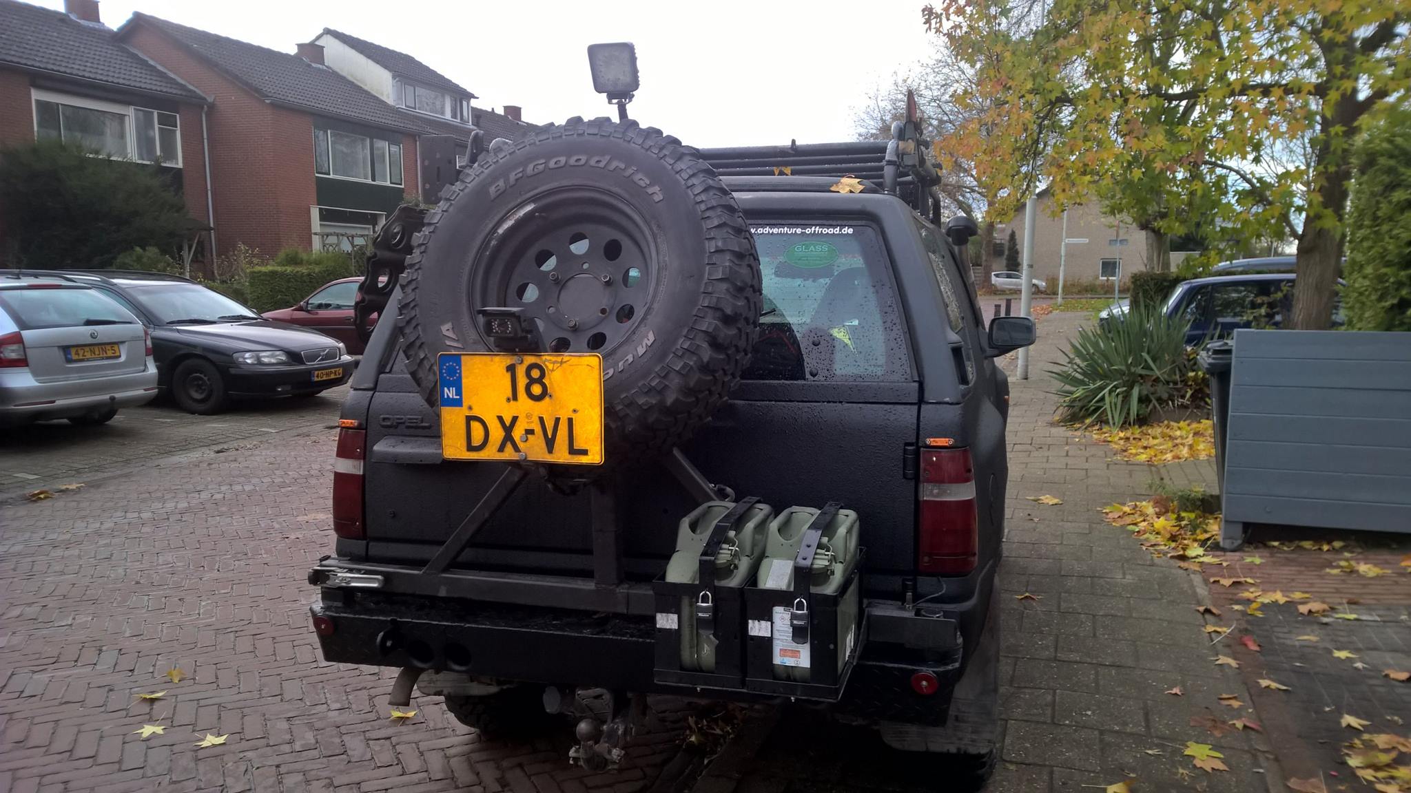

And, I needed some spare fuel. So a dual carriage mount for two jerrycans of 10ltr would be enough.
That should be enough for this trip

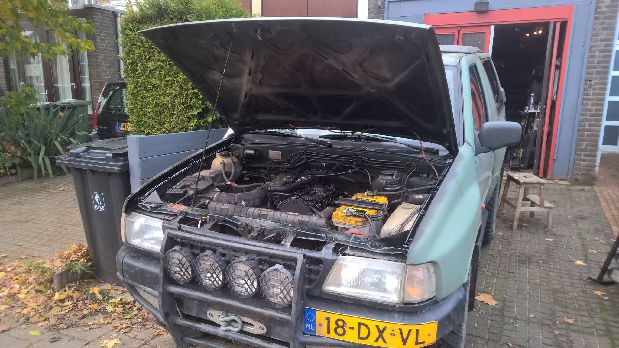

Installed new leaf springs. Here a picture report;
Before
The new leafs
The old one
The difference between new and old
The new setting
And the result
So, I think Iam happy with them.
The brand is Old man Emu 1 inch lift and 200kg plus load.
Think these will be better as the ones i had before.
Just a little thing. I made a new rack for the Jerry cans.
It is really simple, but I think it is very sturdy. 5 to 6 mm steel should do the trick.

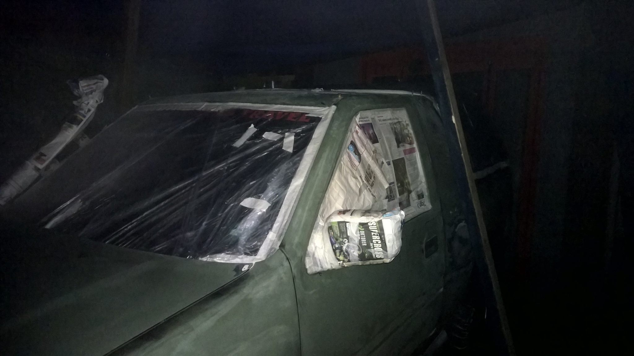

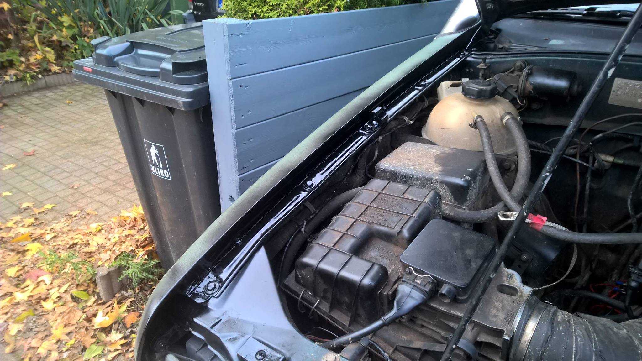

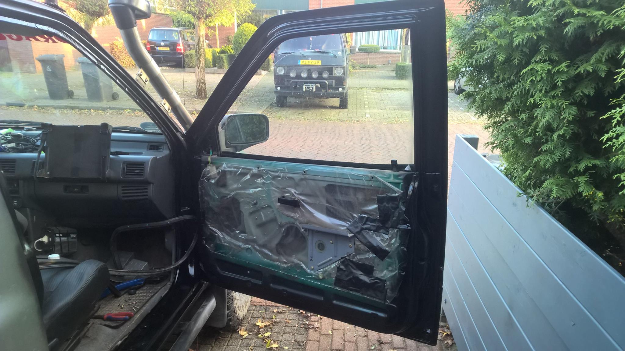

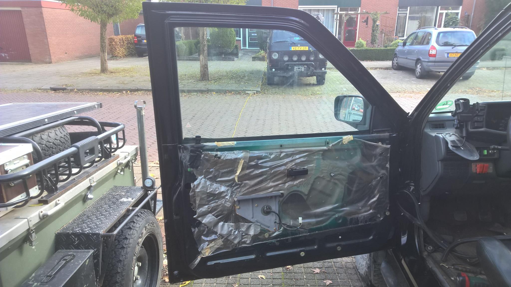

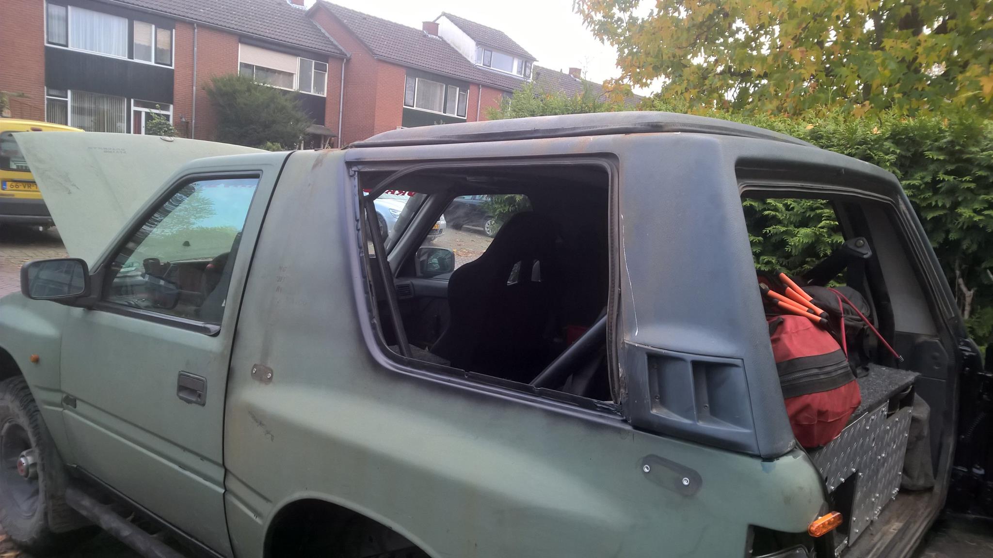

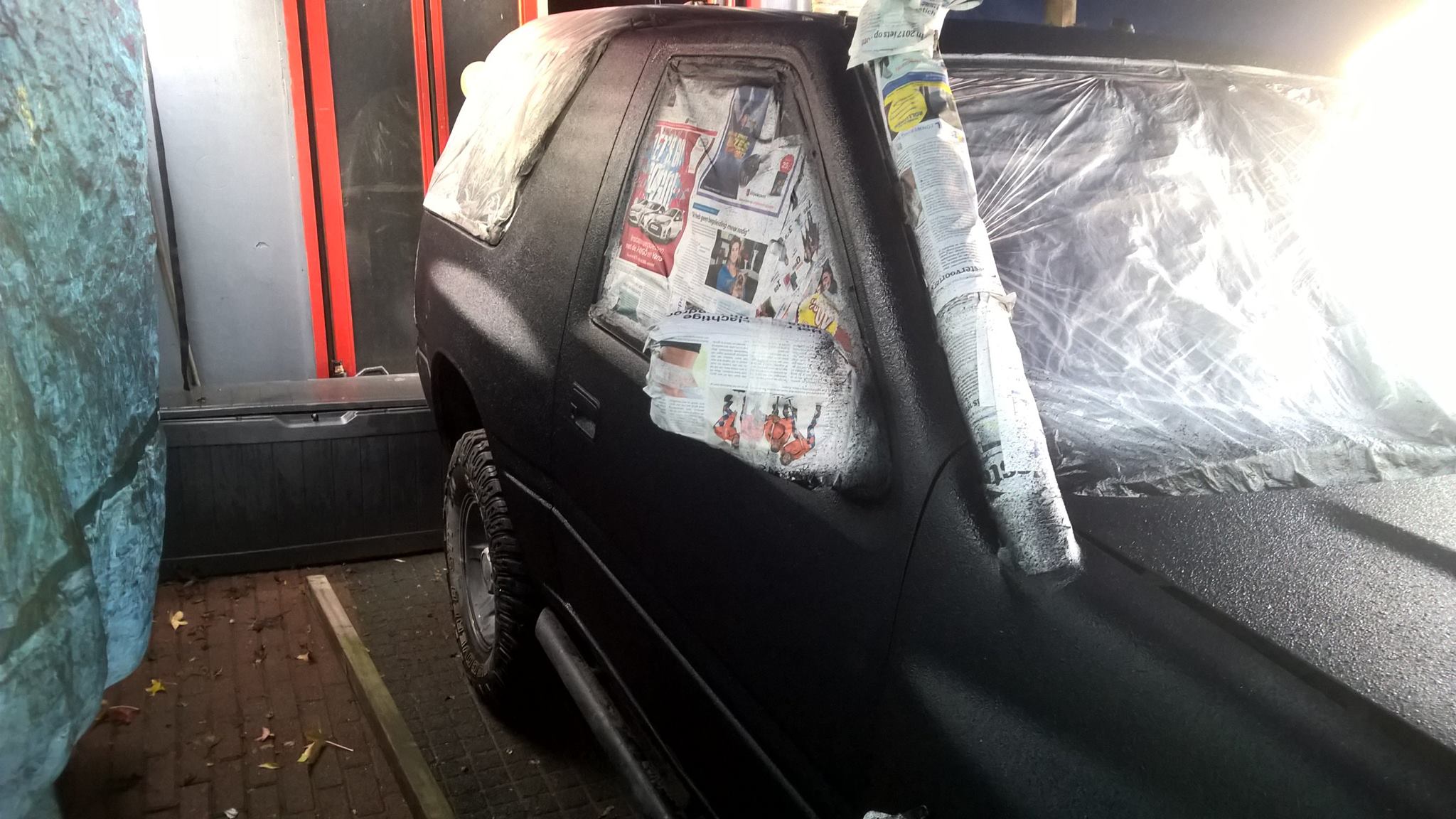

Next step in my rolling restauration :) is painting the car with U-Pol bedliner.

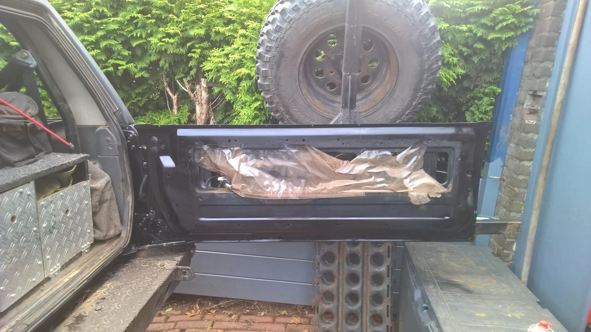

But before that, I had to do the inside of the doors, windows and rear door with standard black paint.
Oh, and dont forget the hood.
Well, almost ready to do the sanding and taping it.

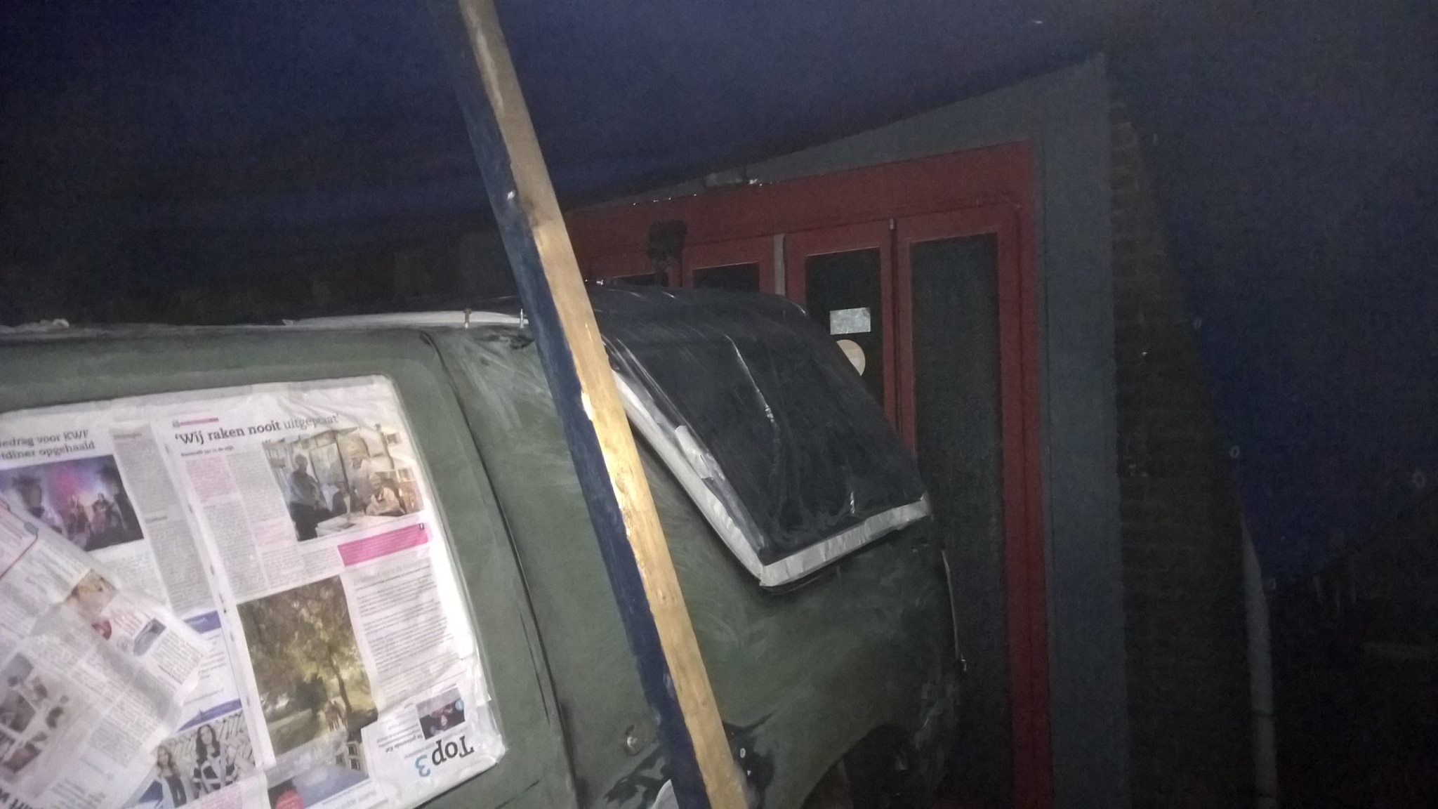

So, I hope we will be ready with sanding tomorrow and also tape of the windows and such.
We will see.

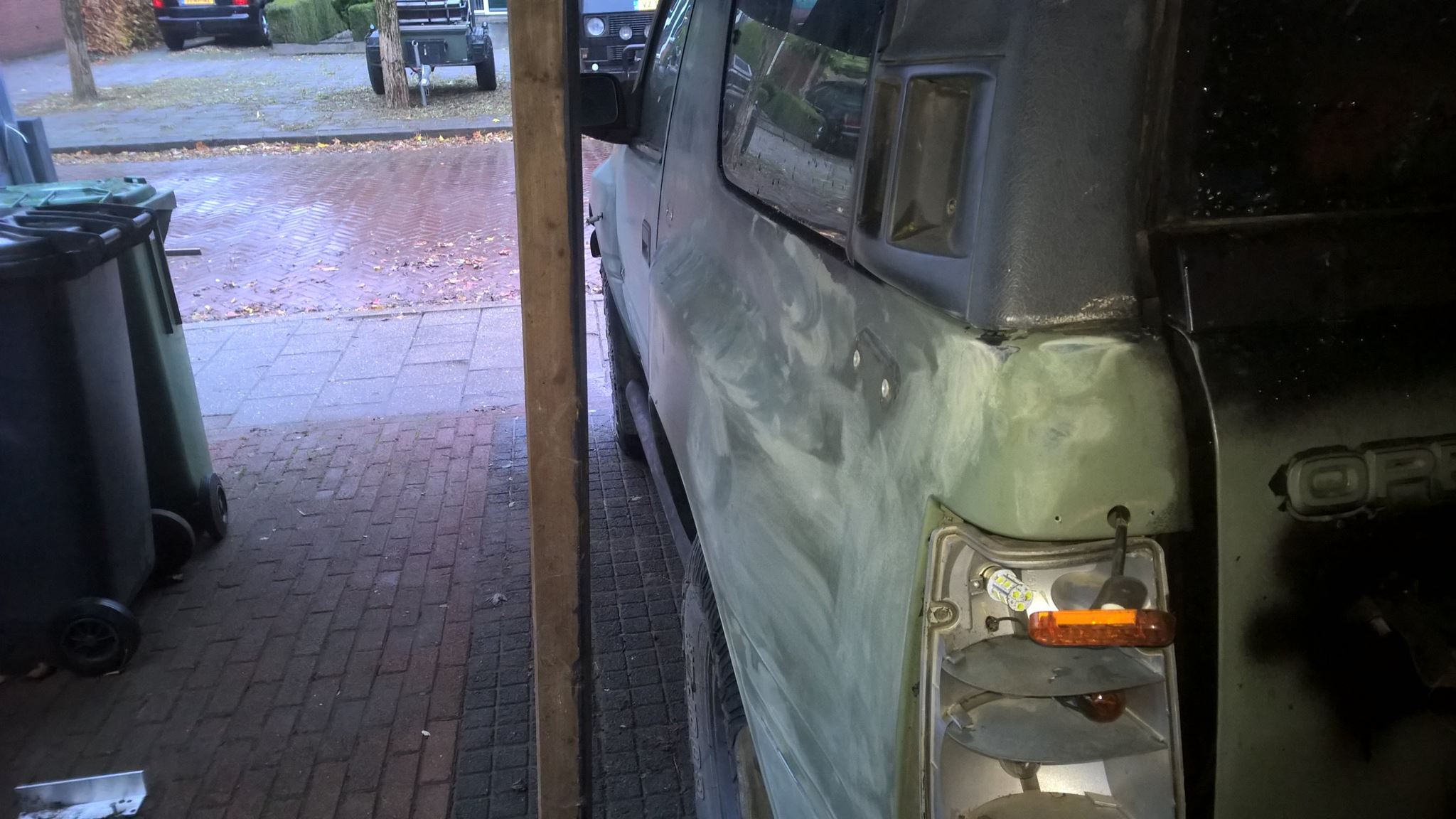

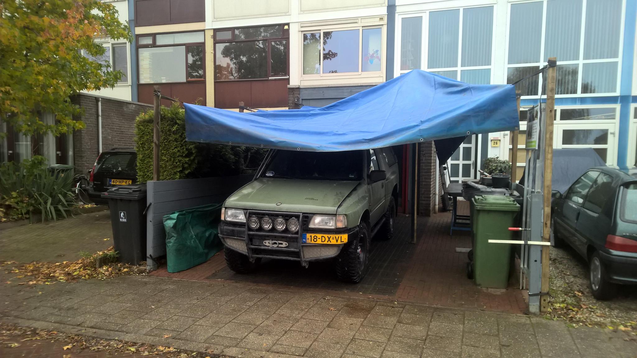

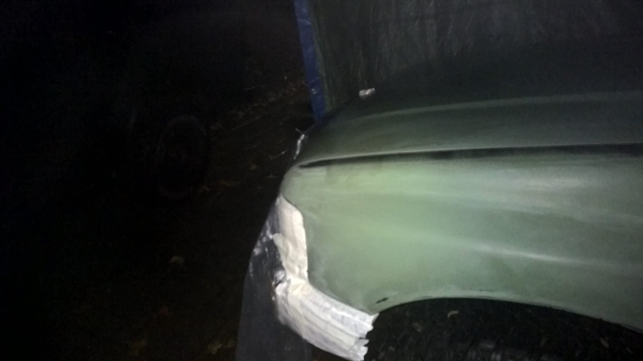

It is raining, so I had to adjust my timetable.
So an Awning (temporary) is set up.

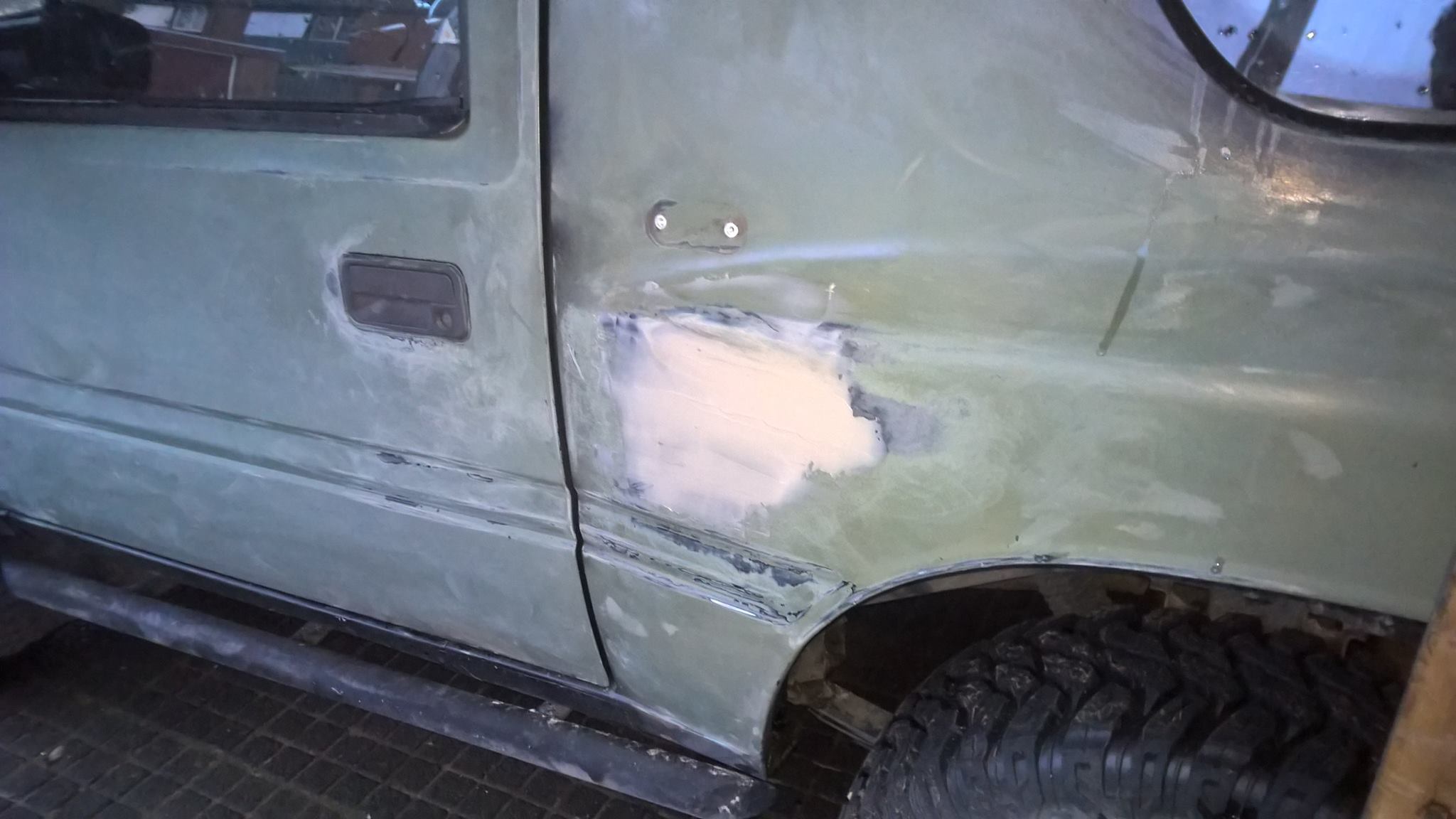

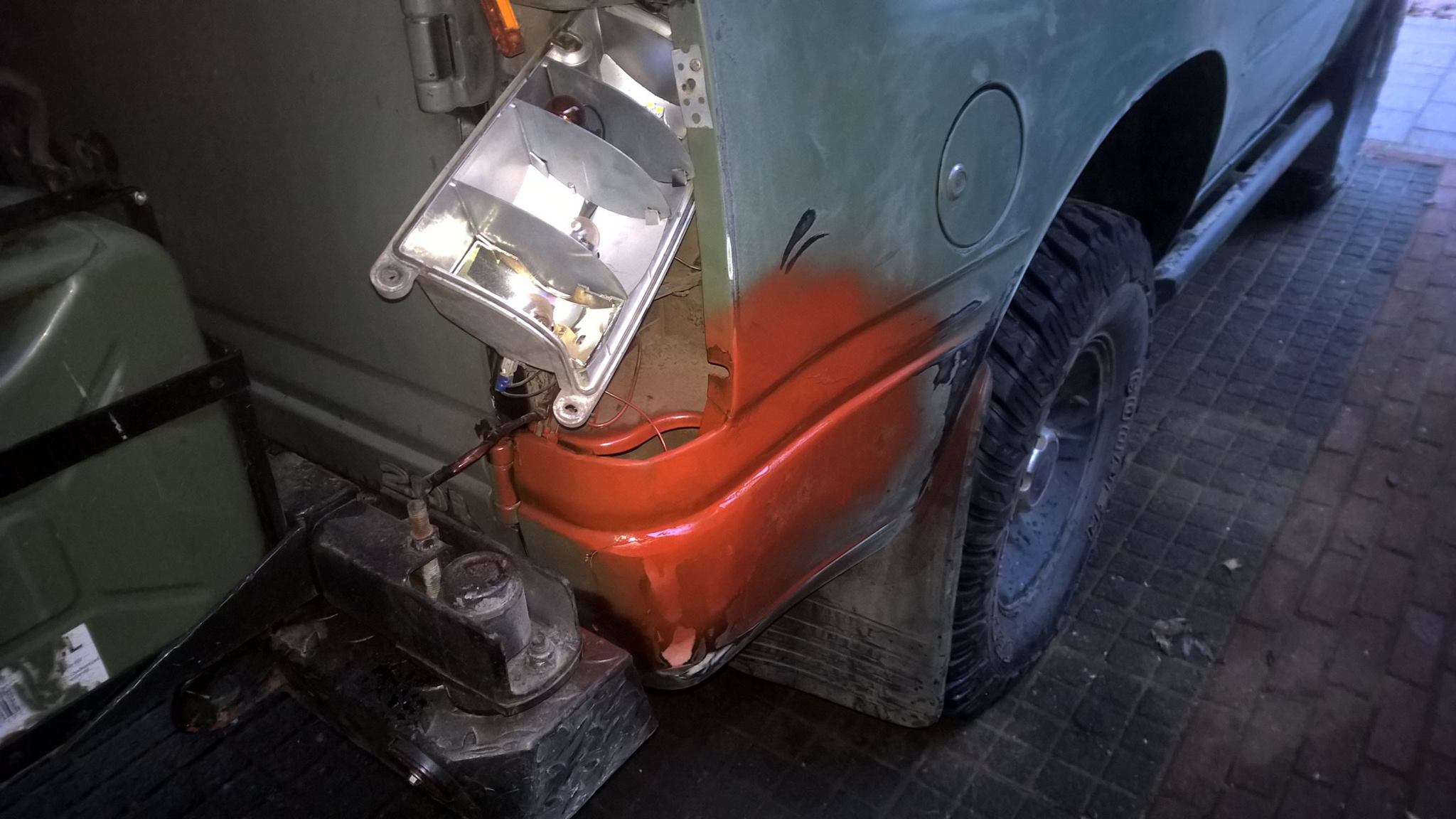

Then I started with some work and sanding.
The dent is out
And the only visible rust is gone
So, that is it for today, it is getting dark and it is still very wet outside.

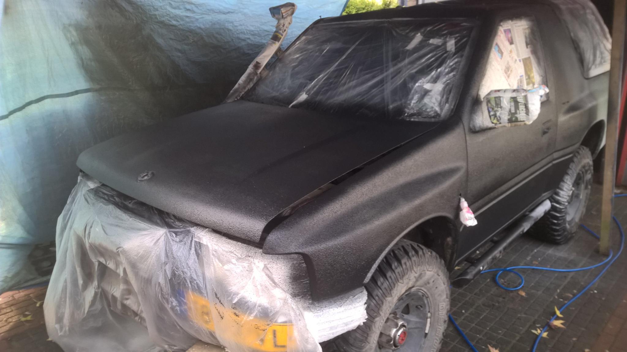

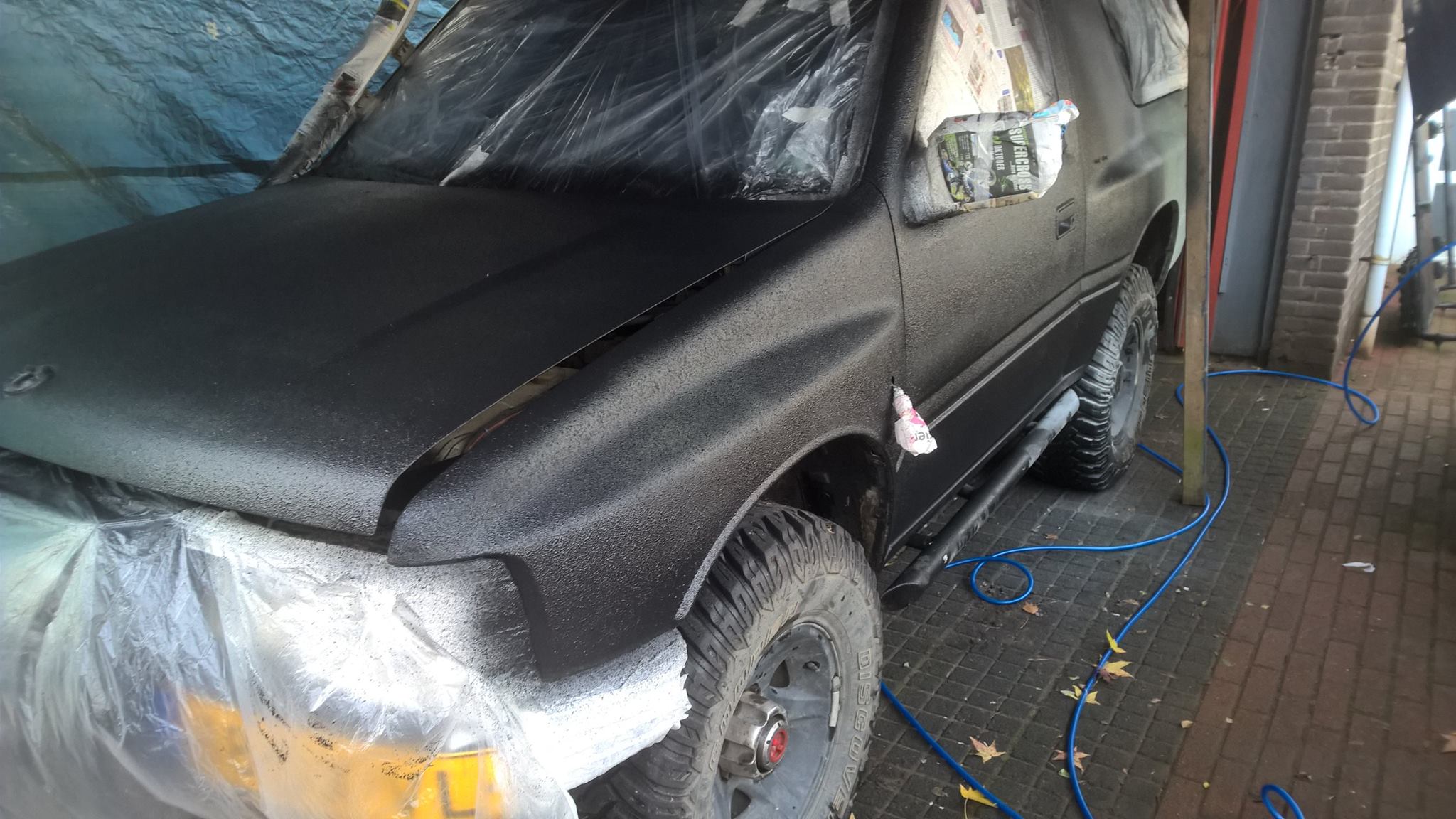

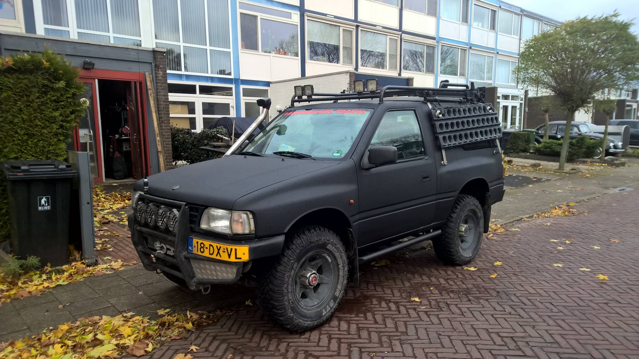

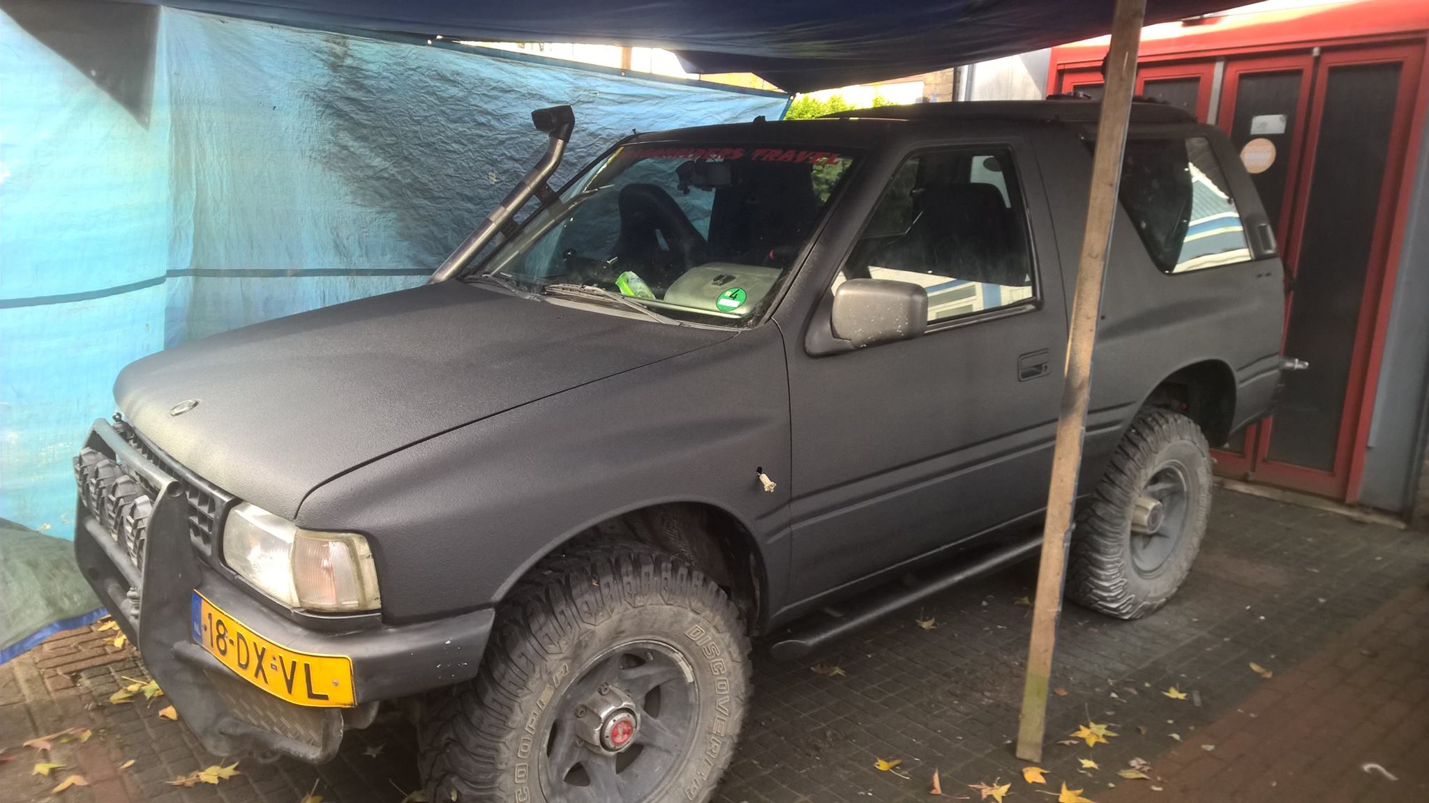

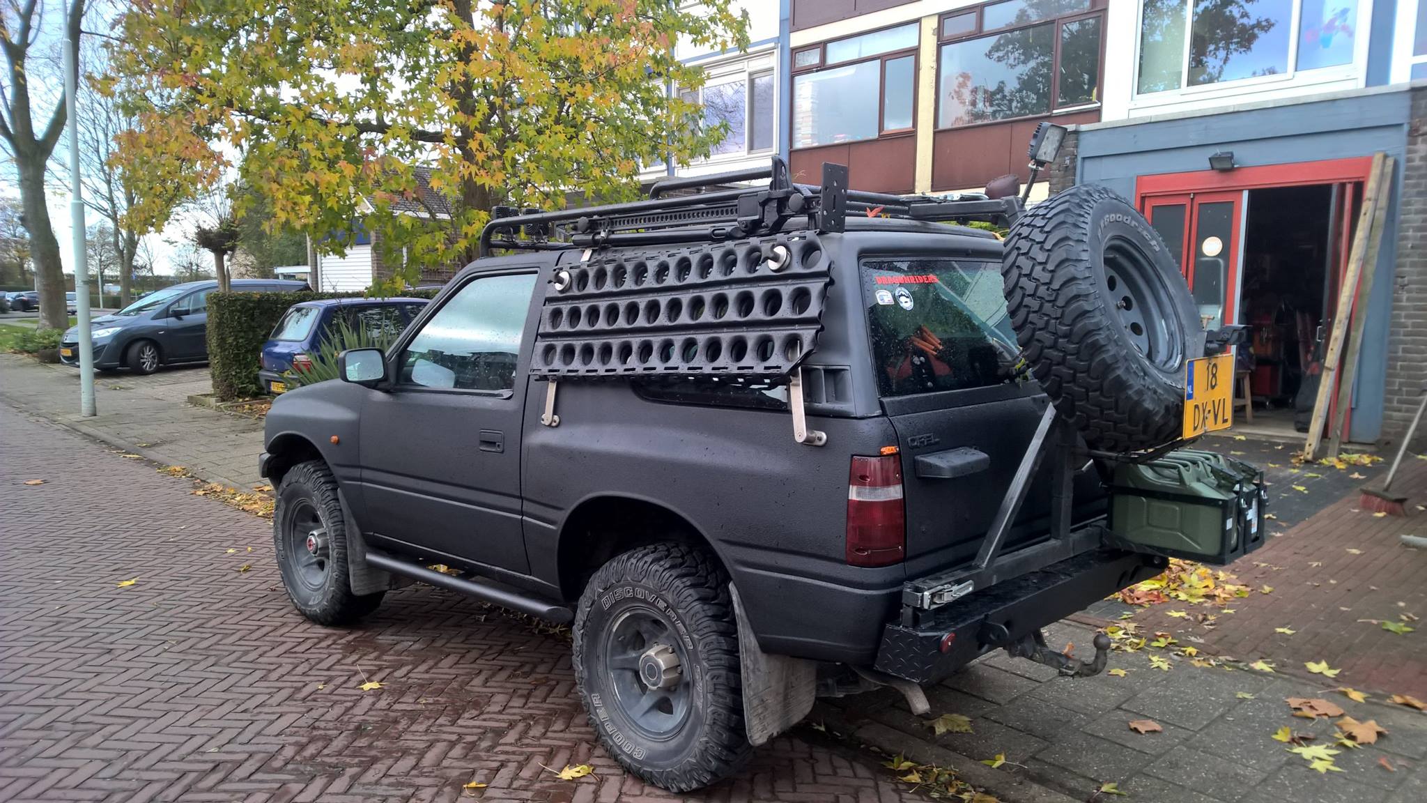

Well, almost done. The care is done except for the rear. I have to move the car to reach the rear. So that will be done tomorrow.
U-pol is a great product. Iam very pleased with the result.
Just have a look.
Tomorrow evening I can remove all the masking and then it is all done again.
Reactions: murps

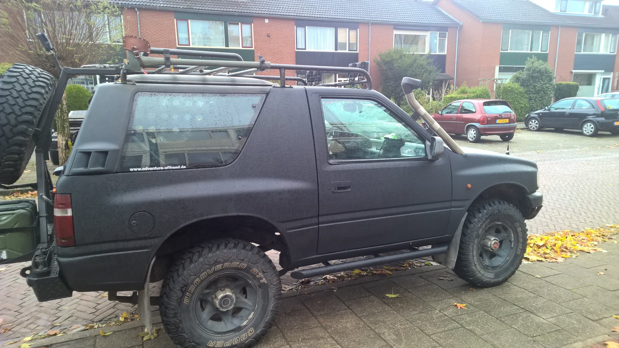

Done. It has been done.
A Dark Crystal has been created.
So now it is onto the next project

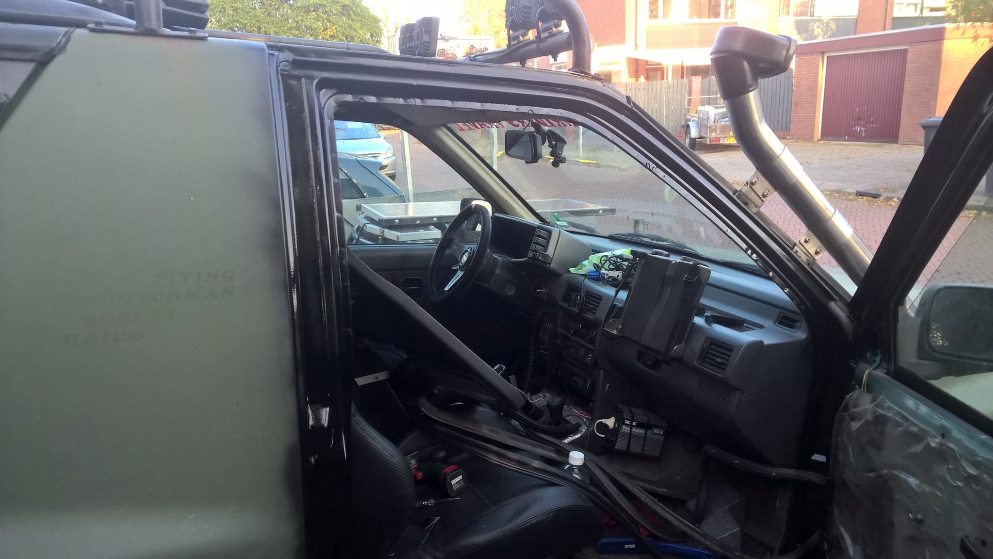

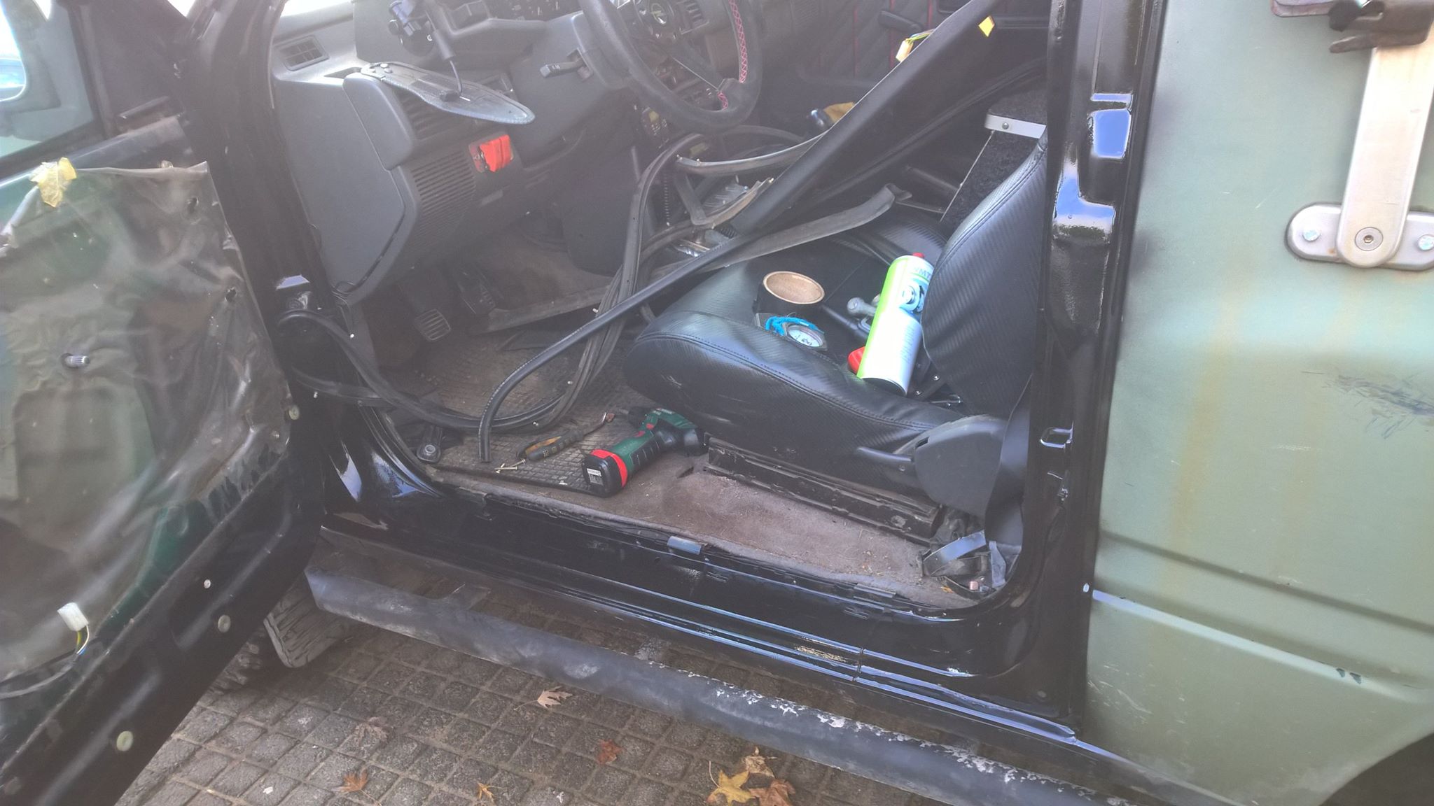

And I started a new Project. As we are going to Morocco once more, we had to decide with which car we would go. And we decided that we would take the Frontera.
But one of the things you can do with the Van is sleep in it. But the Frontera is with fourwheel drive better equiped for the trip.
To make it a win win situation, the Frontera needs an interior that provides us with enough storage room and a place to sleep when needed.
We will do the trip with our Oztent and Trailer, but during the fast trip to Morocco and maybe one or two nights in a place were we think we better sleep in the car, we have to be able to do so.
So, lets build a new interior.

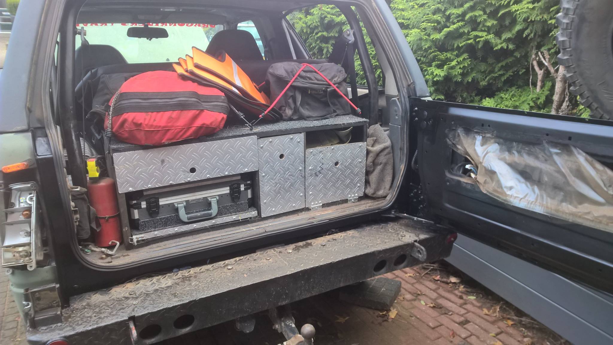

And this isslowly the result. Not finished yet, but the shape of it is showing already.
In the back there will be these two boxes. I will have in total 5 boxes in the back, two with drawers and the others will be top acces storage boxes.
One of the drawers will hold my toolbox and other technical gear, and the other one will hold some recovery stuff and fluids like oil and water (cleaning water and fills for wipers and such)
It aint done yet, but you can see how it will look like.
The thrid box, you see right behind the drawer boxes is a almost car wide box with two lids on it. It is devided in two compartiments who can be accesed seperatly.
This can contain food, clothing, recovery gear and so on.
The last two boxes will be in front of that, were the black box is and will also be able t contain clothing and such.
The idea will be that this all will provide us with a bed, not long or wide, but we need te be able to sleep when needed.
Think of a long day drive and bad weather and you just dont want to set up camp. So sleeping in the car and drive of the next day.
Or during the trip from Holland down to Morocco having a nap now and then.
But, if needed we can stack the three front boxes on top of the drawers and create a seat for a third passenger plus our dog.
And it has to be an easy removal of this all.
