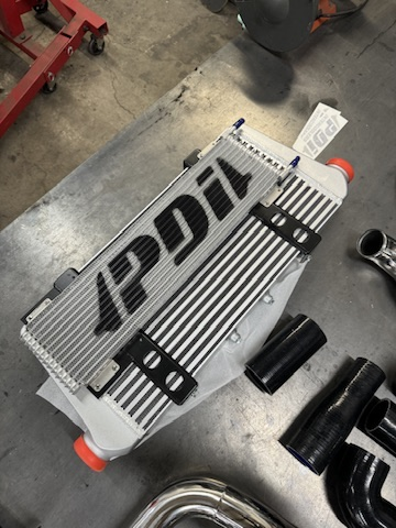

The first thing I had done was a PDI intercooler and trans cooler.

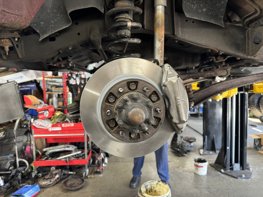

Most of the stuff on my short list is maintenance. So, I'm currently getting my front knuckles rebuilt. But while they're apart I'll be upgrading to the later 80 series rotor and calipers for some added braking power.

The knuckles got rebuilt, so while it was apart, I had them upgrade the rotors and calipers from a later 80 series. The difference is pretty noticeable in person.

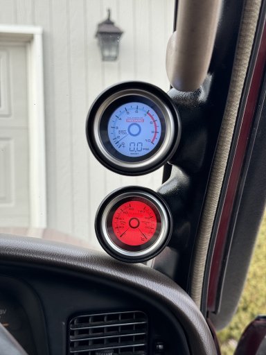

I got my redarc egt/boost gauge wired up and it’s 10x better than the glow shift one I was using

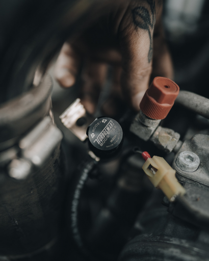

Since I got the boost gauge in. The Turbosmart manual boost controller was right after. Turned the boost up to 14lb

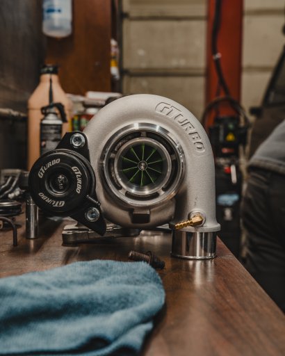

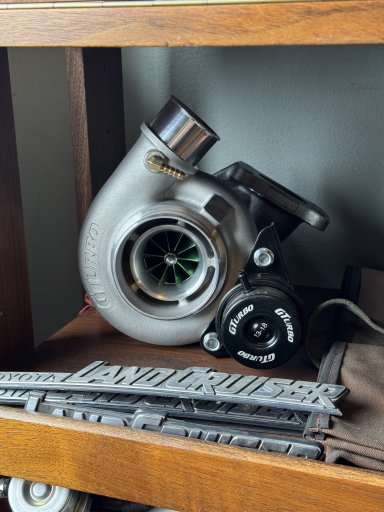

Next week, I'm finally swapping the turbo for a Gturbo green wheel. along with all new gaskets, and I'm also getting the intake gaskets replaced. trying to get this thing refreshed for spring!

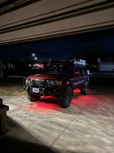

I got my Stedi Surface 6 rock lights wired up. They are pretty slick, being RGB, and they have an app you can mess around with.

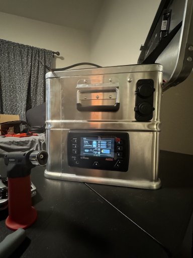

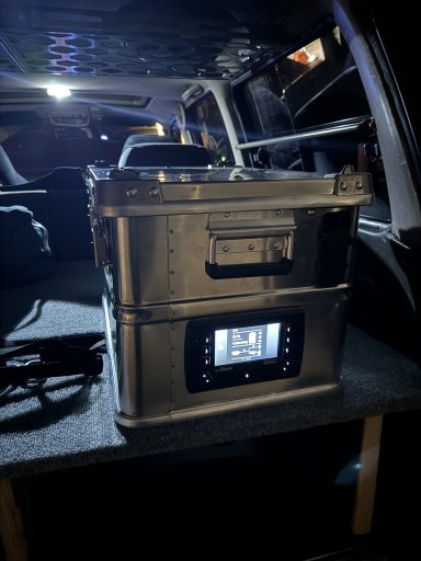

SHES ALIVE!
Alubox 60L with x2 Expion 120AH batteries, Redarc SBM, and a Redarc Rogue Redvision. I still need to button it all up, but so far, everything seems to be booted up and working.
