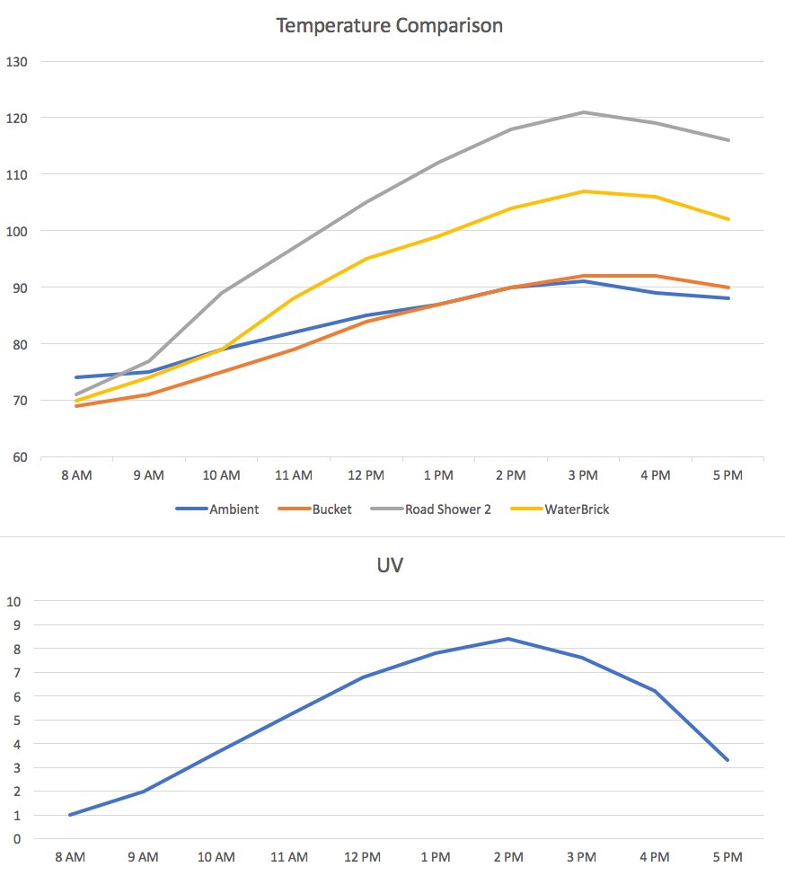

The Road Shower 2 heated the water faster and to a higher temperature than the bucket or WaterBrick. This would be advantageous when the temperatures are cooler or there is less sunlight. It also means that the residual heat would be higher later in the day with the Road Shower 2.
I'm curious about users' experience on this last point though. Offhand, I'd think two things cause the RS2 to heat water faster than the bucket or waterbrick: the color black absorbs heat instead of reflecting it, relative to blue and white containers, and the RS2 being long and narrow has vastly more surface area than the other two "short/fat" containers.
The higher peak temp would lead to higher residual heat, but cool night air flow over the much larger surface area conversely would rapidly cool the RS2.
again, very curious if folks who have used this product at night felt like it retained heat.
I'd bet an insulator on the bottom and sides, but not the side exposed to sun, would be a good mod.
I think it is a little of each of the above. Plus, aluminum is *much* better at transferring heat than plastic. (Don't believe it? Pour boiling water into a single wall aluminum water bottle and a plastic one, then grab it. Which one hurt the most? :grinning: )
And conversely, the aluminum sheds heat faster than the plastic material.

I performed this test on two different days; the first having an ambient temperature range of 59-75°F, and the second a range of 74-91°F.
As shown in the second chart, the water temperature topped out at 121°F in the Road Shower 2. That is about the same temperature as the setting on most home water heaters. Care should be taken to avoid scalding at these temperatures! I left the LCD thermometer's readings off of the charts. Since it is reading the surface temperature of the tank, it was always a few degrees higher than the actual water temperature. The LCD thermometer has a maximum reading of 118°F, so the water temperature line on the chart crossed the LCD line. I found this distracting, so I removed it.
On the second test, I stopped recording at 5 PM, but checked the water temperature in the Road Shower 2 later in the evening. At 7:30 PM, the water temperature was still 104°, and at 8:45 it was 92°.
Location and latitude should be taken into account when considering any solar water heating product. Southern locations will receive much higher levels of solar radiation, while locations further north or climates with frequent overcast would see less solar heating. For reference, the highest UV reading during the first day of testing was 7.4, and 8.4 the second test day. Historically, we will see UV highs during the summer of 11-12, which should result in even higher water temperatures.
