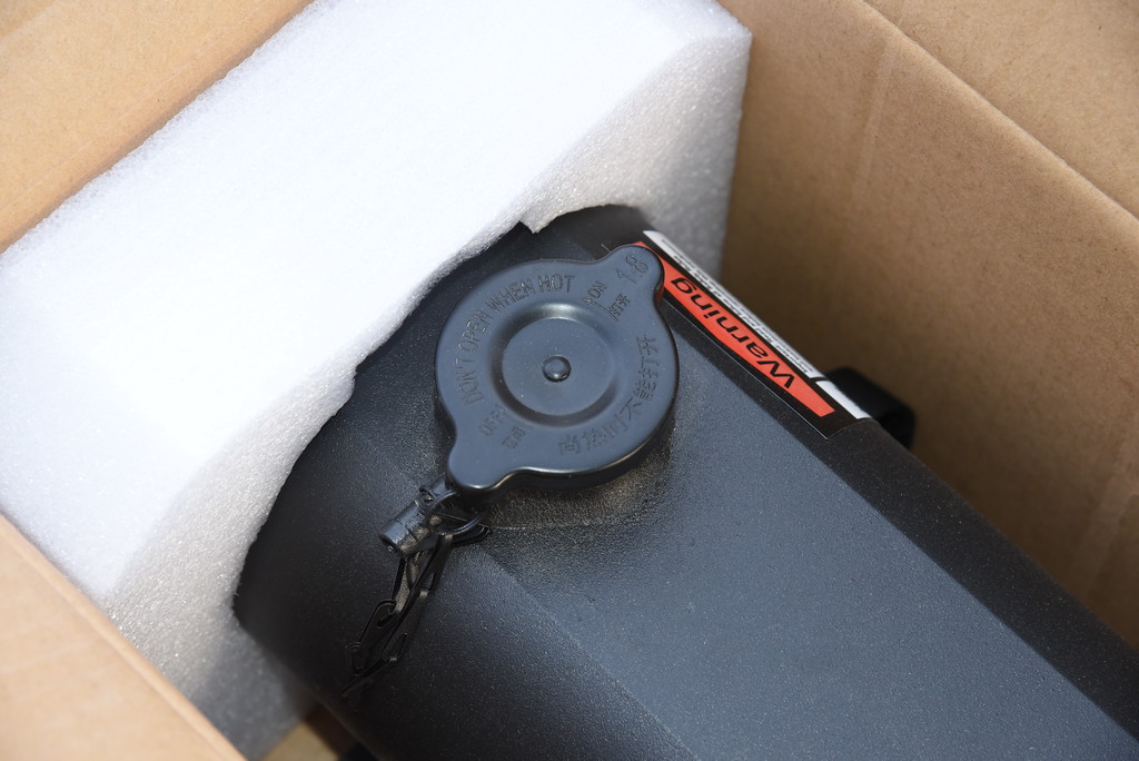

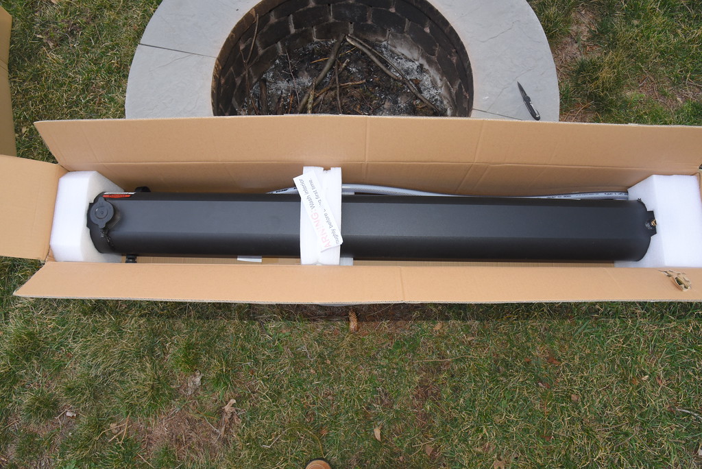

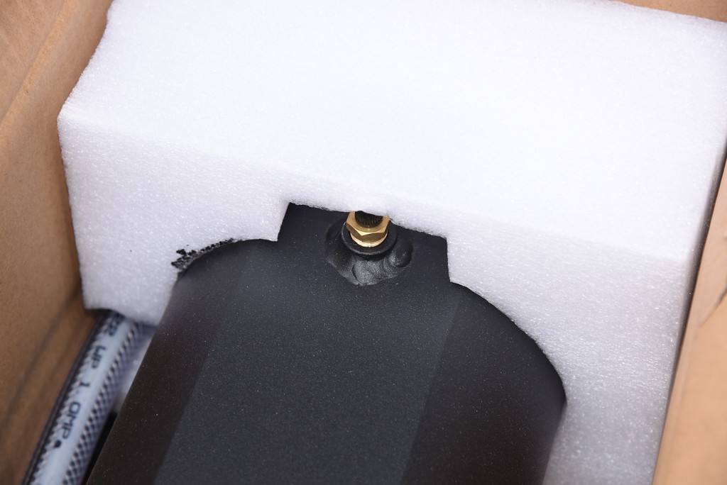

The Road Shower 2 came packaged very well, in a thick corrugated carton of better quality than the typical Chinese cartons. Inside, the tank was completely suspended in fitted closed cell foam blocks. There was no damage to the tank, despite the carton having some minor shipping damage. The aluminum knob on the tank's valve was broken. It looked as if the carton had been dropped on its end. An email to Road Shower resulted in a replacement knob arriving in just a few days at no cost to me. A friend who has a Road Shower 2 had no damage at all to his packaging or contents.

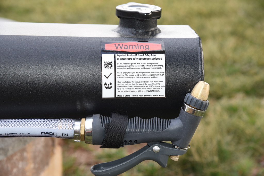

The Road Shower 2 is a 55" long, 6" diameter cylinder; flat on the top and bottom (4-1/2" high.) It is all aluminum construction, and powder coated a textured flat black. The bottom has a full-length T-slot for mounting on a roof rack. It weighs 15 pounds empty, and 55 pounds with five gallons of water. An adhesive-backed LCD thermometer is supplied to stick on the tank. This is to show the relative temperature of the water in the tank.
One end has a 25 PSI (1.8 bar) pressure/fill cap, much like a radiator cap. Under the cap is an pressure relief tube for when the pressure in the tank exceeds 25 PSI.
On the opposite end of the Road Shower 2 is a hose valve with standard garden hose threads. Attached, is a 55" long 5/8" diameter food grade hose, with a standard adjustable garden hose nozzle on the end. On the top of the tank is a standard Schrader valve for pressurizing the tank using a tire pump or air compressor.

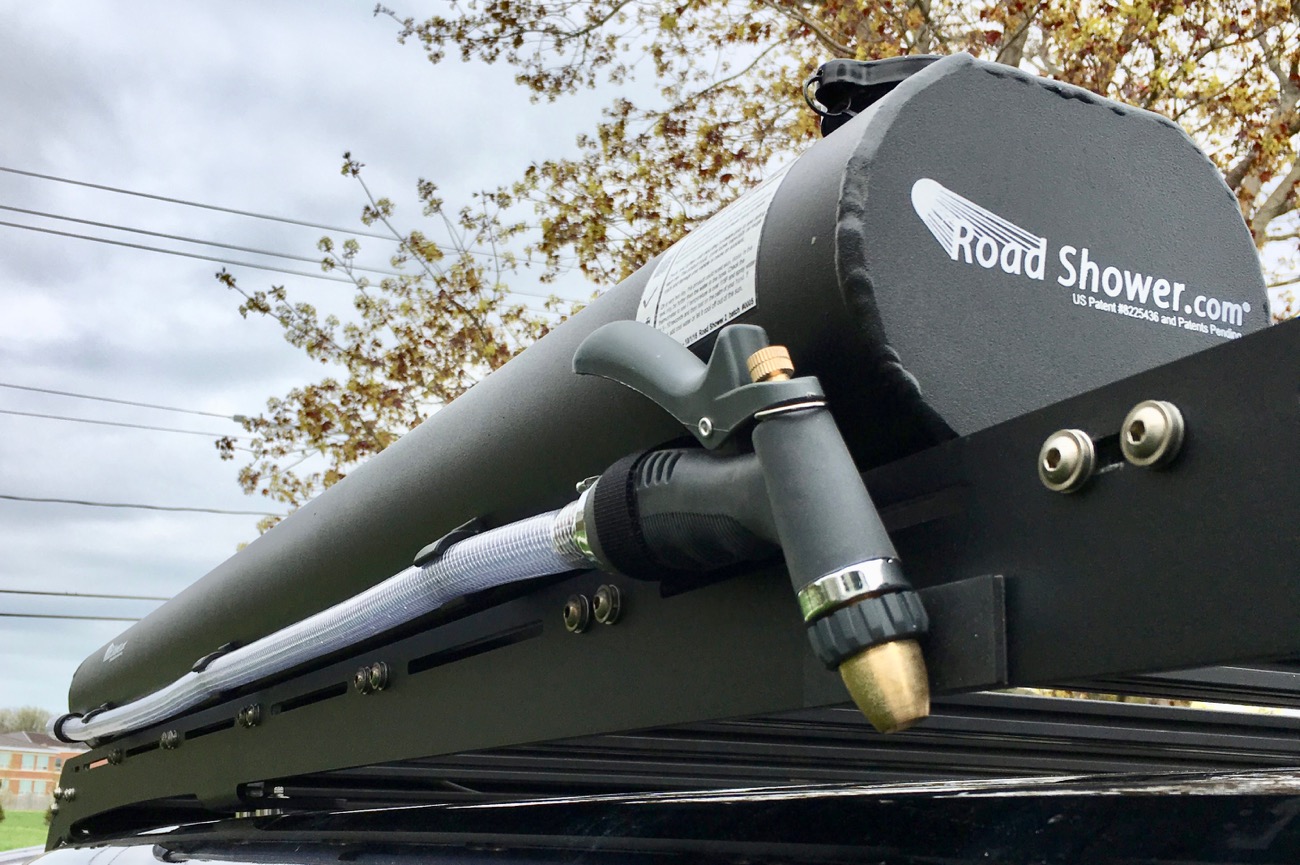

Mounting the Road Shower 2 is very simple, and attaches much like any roof mounted bike/ski rack. Your vehicle must have crossbars. The provided brackets and fasteners will fit 1" round or square crossbars, and aero bars. My Prinsu rack has 1" X 2" rectangular crossbars, and the supplied parts fit it just fine.

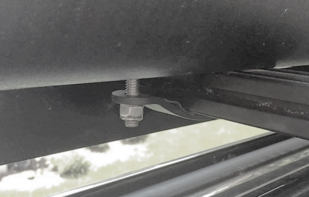

Simply slide the four carriage bolts into the T-slot on the bottom of the tank, then lay the tank on top of the crossbars. There are two pieces of adhesive backed foam that can be attached between the bottom of the tank and the crossbars to avoid scratching either, and for vibration isolation. Slip on the two steel straps, then the locking nuts. Tighten all four nuts evenly using a 1/2" wrench, and installation is complete. (I stuck the adhesive foam on the side of my rack, under the nozzle, to prevent rattling.)
A note about orientation: In order to use the full capacity of the tank, it is recommended to have the hose end of the Road Shower 2 at the lower end of the roof rack. My 4Runner is lower in front, so I mounted the Road Shower 2 on the driver's side of the roof rack.

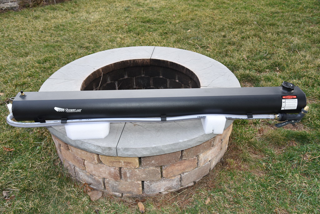

To test the heating capability of the Road Shower 2, I filled the tank with tap water. I also filled a white 5 gallon bucket, and a 3.5 gallon blue WaterBrick. I parked my 4Runner to get full exposure to the sun on the tank, with the other two containers on the roof rack next to the Road Shower 2. All three sat overnight to equalize temperatures. I then checked the temperature of each container every hour during the day. For comparison, I also recorded ambient temperature, the LCD display on the side of the tank, and the UV reading from my Davis Vantage Pro2 Plus weather station.
I performed this test on two different days; the first having an ambient temperature range of 59-75°F, and the second a range of 74-91°F.
As shown in the second chart, the water temperature topped out at 121°F in the Road Shower 2. That is about the same temperature as the setting on most home water heaters. Care should be taken to avoid scalding at these temperatures! I left the LCD thermometer's readings off of the charts. Since it is reading the surface temperature of the tank, it was always a few degrees higher than the actual water temperature. The LCD thermometer has a maximum reading of 118°F, so the water temperature line on the chart crossed the LCD line. I found this distracting, so I removed it.
On the second test, I stopped recording at 5 PM, but checked the water temperature in the Road Shower 2 later in the evening. At 7:30 PM, the water temperature was still 104°, and at 8:45 it was 92°.
Location and latitude should be taken into account when considering any solar water heating product. Southern locations will receive much higher levels of solar radiation, while locations further north or climates with frequent overcast would see less solar heating. For reference, the highest UV reading during the first day of testing was 7.4, and 8.4 the second test day. Historically, we will see UV highs during the summer of 11-12, which should result in even higher water temperatures.
The Road Shower 2 heated the water faster and to a higher temperature than the bucket or WaterBrick. This would be advantageous when the temperatures are cooler or there is less sunlight. It also means that the residual heat would be higher later in the day with the Road Shower 2.

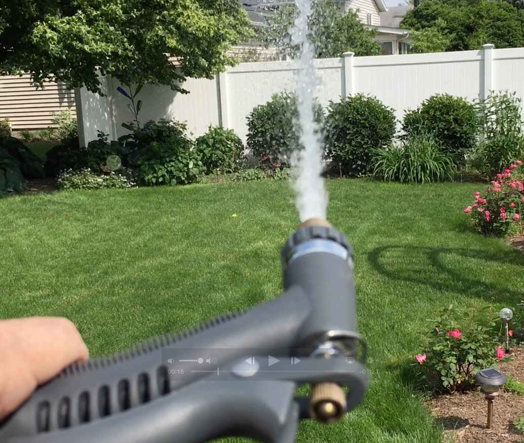

The next test was to measure how far, and for how long the Road Shower could spray water with the nozzle set at the hardest setting. This took a few tries, balancing the volume of the water and air. A nearly full tank would spray fairly far, but would reduce in pressure quickly. Too little water gave great pressure for a sustained amount of time, but ran low on water quicker.
The best results were with the tank about 3/4 full of water and then pressurized to 25 PSI. This resulted in a spray that reached out 36-37 feet, and lasted about 30 seconds, slowly reducing in distance. This isn't a particularly practical test. I just wanted to see how far I could get it to spray. The obvious way to get a long, continuous flow is to fill the tank to the brim, and then leave the air compressor attached, giving a constant full 25 PSI pressure. The spray pressure is quite strong, and is useful for blasting mud and dirt off of my kayaks, shoes, bikes, gear, and the truck. There are several pressurized water options available, and from what I've read, the Road Shower 2 is the highest available. And as described in the conclusion below, will soon be even stronger!
For comparison, before getting the Road Shower 2, I was using 3.5 gallon WaterBricks for water storage, and a 12V Ivation portable outdoor shower from Amazon. This setup only offers a fixed soft shower flow, and only sprays 2-3 feet. However, as it is a 12V submersible pump, it will maintain that same pressure as long as you have a water supply.

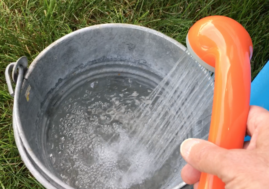

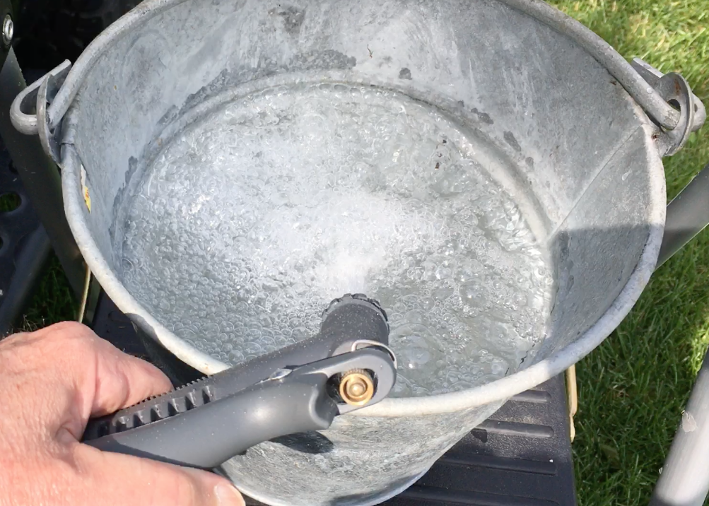

The next arbitrary test was to see how quickly the Road Shower 2 would fill a 2 gallon bucket. Again, filling the tank about 3/4 full and pressurizing to 25 PSI resulted in the best performance. The bucket filled in about 48 seconds. Of course filling the tank full and leaving the air compressor attached would take less time, but that's not how the Road Shower 2 is normally used.
I put the Road Shower's spray nozzle on my house garden hose, and filled the bucket in just 2 seconds. That's with a 3/4" garden hose, and a continuous ~40PSI water pressure, so the Road Shower 2 did okay in comparison. Interestingly, the 12V Ivation shower pumping from the 3.5 gallon WaterBrick only took 55 seconds to fill the two gallon bucket. Even though it had a relatively slow flow, it had a continuous pressure due to the submersible pump.

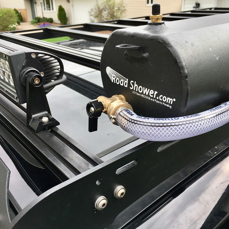

Great review and testing. Been using a RoadShower for several years now and love it. Trying to slide into my bag at night without having taken a shower is now unthinkable!
Did make a few improvements to the basic rig, however. To ensure constant pressure, rigged up an external air tank that continuously charges the unit - so I get constant pressure to the last drop of water. I can also adjust the pressure flowing into the unit with the variable valve and read the pressure in the tank and in the Roadshower through isolated liquid-filled gauges. That way, I can extend the spray time for a shower or crank up the pressure to jet clean kitchen gear.
Overall, a great addition to our desert rig. A few pics of the mod below.
That's very cool! I figured for constant flow, I'd just leave the compressor attached and on when needed.
The new models eliminate the need for all of that, though. They have a 65 PSI cap, and a separate 2 gallon air space, even with the water tank full. So pressurizing the full tank will give enough pressure to empty the entire tank on one go! Very nice upgrade!!
