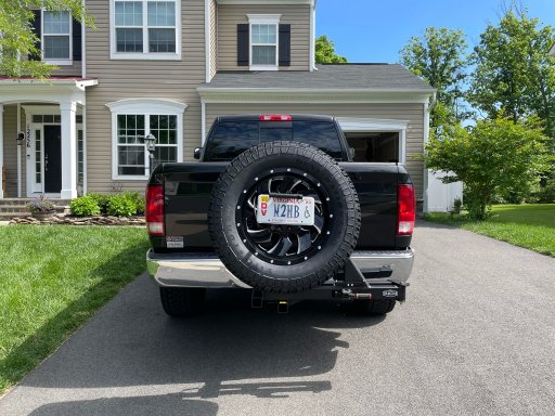

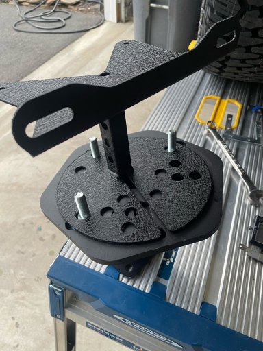

I bought a SmittyBuilt license plate holder that is actually made for Jeep and modded (?) it out to fit on the wheel plate for my Ultraswing Megafit for my Ram 3500. I had to drill a couple of extra holes and make the others larger to fit the wheel bolts that came with the plate but it worked out nicely.
I also added a AutoVox wireless backup camera so my 16 year old daughter who also drives my rig doesn’t “Hulk smash” anyone or anything!
Still waiting on the A.R.E. MXHD topper (it’s been 4 months so far) to finish out the install.

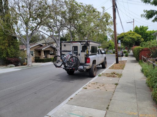

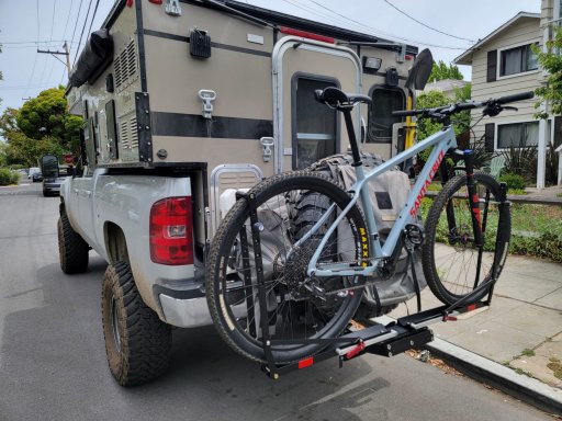

Got my 1-Up setup, riding tomorrow. Had to use a 6" extension to clear the massive spare, used an anti-rattle on the extension into Rig'd side, and the 1-up has it's own where it goes into the extension. I will say, watching it in the mirror it bounces a lot... I might look into a ratchet strap up to the spare just to support it a bit... but this is how it's meant to be used.
