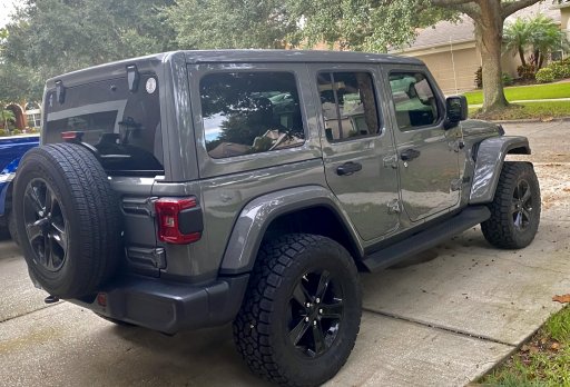

Hello Everyone! I am a new Jeep owner and need to understand what type of trail my jeep can operate on before I do any modifications to it. First, I'm not going rock crawling on extreme trails but I would like to go on moderate trails in Colorado. I am interested in Black Bear Pass and Schofield Pass. I will be traveling pretty light and will carrying on average 200lbs of gear in the back. If you are familiar with these passes do believe my jeep's stock suspension can go on that type of terrain?
Specs:
2020 Wrangler Sahara Altitude
EcoDiesel
33" AT4 tires
Modifications: None-

Lockers, any recovery gear? What you are describing is someone who has never been off-road. I suggest finding someone in your area to go out with and have them “help” you learn what you are doing.
There is quite a bit your Jeep can do, but giving it the skinny pedal isn’t always the answer.

Not having a matching spare could be problematic off-road. However, going with someone and having recovery gear and a matching spare your Jeep could navigate probably a 4 with a new driver without damage. Anything above that you want sliders. That’s my .02.
Witn an experienced driver as well as recovery gear and skids then the Jeep can tackle more without getting stuck. The best mod is the one behind the wheel.

I would add the following:
Matching spare tire.
The ability to efficiently air your tires down and back up. Accurate tire pressure gauge.
Quality recovery gear - kinetic strap, tree protector, D-ring/bow shackles, snatch block, and, optionally, a Hi-Lift jack can be used as a sort-of hand winch but, they're heavy and take up space.
A buddy with whom to go wheeling who is more knowledgable than you. Learn from them.
The desire to get out and explore.
Otherwise, your Jeep is perfectly capable as-is. Lots of folk on here seem to have a hard-on for lockers. Yeah, they're great, but, theyre unnecessary for the type of driving you mention you plan to do in your opening post.

I am driving a 2019 Sahara JLU and without any mods, you will find you Jeep quite capable. Caution will be your best tool.
As far as things you actually need:
- A matching spare is essential
- Some basic recovery gear (snatch strap or tow strap, some D-ring or soft shackles, gloves, and tools to change a tire)
- Air up/down tools (air compressors are inexpensive)
There are lots of gear that you may later add, based on what you decide to do longer term, but start small and add as the need arises. Just a bit of advise from a fellow jeeper!

Black bear is a bit difficult in my opinion not because for the trail itself but more for the scare factor in some sections, especially for a beginner. Also, the trails is now closed for the season.
Schofield Pass is more doable, there is only one section that is narrow, watch for upcoming traffic and your tires placement.
In the same area you should do Crystal city (stop at the mill!) and Paradise Divide.

yes, given experience a stock Wrangler without lockers would have no issues. But yer dream of 2000# of gear is unrealistic. Look at the Jeep Spec sheet and decide if a Wrangler will work.
and consider joining a tour group with reputable guides with references.
