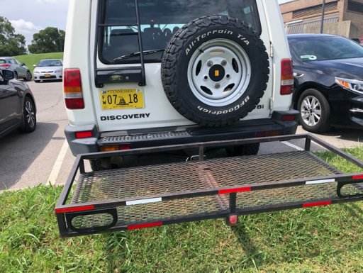

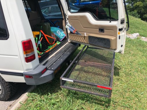

Found a cheap cargo basket locally, but when I picked it up initially it had been adapted to a 1” hitch then adapted back for a 2” receiver with a sleeve. The slop and play in the setup was unbearable, and I couldn’t open the rear cargo door with the basket in place. After cutting and grinding off what I didn’t need I slipped the entire center frame of the basket into a solid 2” receiver extension I lopped one side of off with a bandsaw. This both took the rise out of the assembly while making it more solid installed. As I welded that up I tacked in a few steel plates to hold standard oval trailer lights to make the basket more functional at night since it will cover the rover’s bumper mounted lighting.
Nice job as always !
