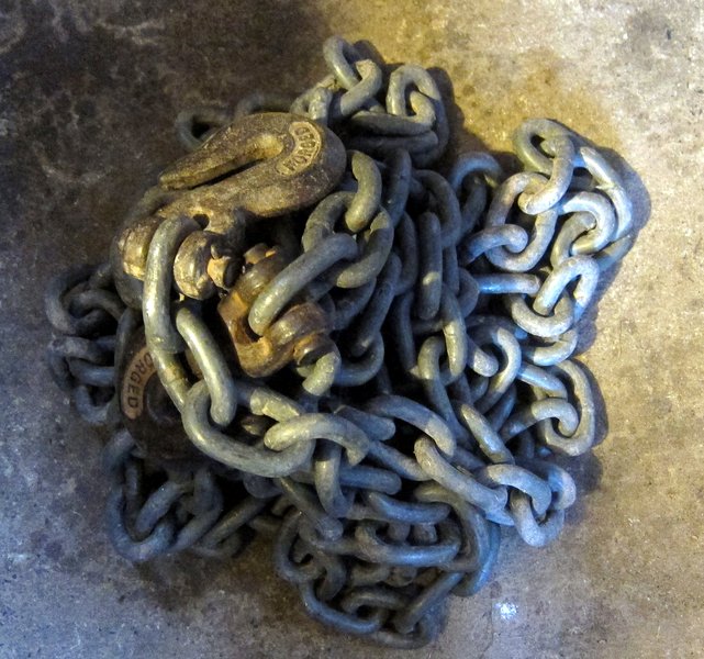

I would never use a come along for this. Get a Hilift or electric winch.
Generally, you don't want to be standing next to a metal cable when it snaps. I use 35' of chain with the Hilift. I also have some synthetic winch rope.

Chain should NEVER be used in any recovery situation. Period, end of discussion.
If I can ask you to re-open the discussion just for a bit, can you expand on why you feel chains should not be used in a recovery situation?

Yeah, because that doesn't sound right. Been using chains responsibly for 30 years.
Overloaded steel cables are the widowmakers you might be thinking of.

OK guys.
I’m really surprised how many of you think a chain is the answer.
A quick search came up with this article..
Have I used a chain before ...yes I have. I owned a construction company for 37 years and have pulled equipment that was stuck that weighed over 30 tons. In fact I had a cable that was rated over 100,000 (50 tons) and used it probably monthly. But after my first heavy duty chain snapped I researched what to use so that my guys wouldn’t kill themselves and we switched over to heavy nylon straps. In fact my concrete company switched several years ago when one of their employees was injured. I also carry a kinetic rope which allows me to recover vehicles easier and potentially larger than what I’m driving. If you have never seen Matt’s off-road recovery Utube channel check him out. I think you’ll become a believer..
The bottom line is that while a chain might work it also might severely injure you...there are better, lighter and cheaper options for snatching a 3 to 5 ton vehicle out of the mud.

Well according to that article, my 9/16” grade 100 chain is double the strength of the pull of my winch with the same sized cable, of corse you don’t use open hooks with chain; who is that dumb? Also you don’t go jerking on a rig while using chain, you ease into the pull to take up slack... btw, don’t you dare jerk me and my rig while pulling me out even with a kinetic strap or you’re going to have a busted jaw (just ask Nate). I would agree with that article for someone who knows nothing about chains and gets a Walmart recovery chain.

I no more think "a chain is the answer" than I think "Chain should NEVER be used in any recovery situation."
I never we said it was the answer, but I won’t leave my chain behind either... like I said, never broke a chain not had it come unhooked in over 30 years of using them, but I have broken way too many straps and ropes to count... I also know how to read a situation to know which to grab... chains are usually a last resort unless using my hi-lift jack, or making a yoke for my winch.

Well according to that article, my 9/16” grade 10 chain is double the strength of the pull of my winch with the same sized cable, of corse you don’t use open hooks with chain; who is that dumb? Also you don’t go jerking on a rig while using chain, you ease into the pull to take up slack... btw, don’t you dare jerk me and my rig while pulling me out even with a kinetic strap or you’re going to have a busted jaw (just ask Nate). I would agree with that article for someone who knows nothing about chains and gets a Walmart recovery chain.
Mike I’ve never heard of a Grade 10 chain...Are you sure?? Most chain grades start at 30 and go up from there.

Typo, thanks for catching that... Grade 100... I will go fix my previous post to reflect my typo

Good. How long is your chain and how much does that beast weigh?
I have a 10’ chain and a 15’ chain... how much does it weigh??? Not sure never weighed it... and since I run Full Sized 1/2 Ton or larger rigs, I really never cared...
