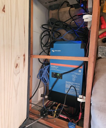

Got a few things done this weekend. Straghtened up some of the wiring, made it into a 24v system. Got the inverter swapped to a 24v|3000kva to support the induction range fully. Also got the new fridge in today. Went with an Isotherm Cruise 195. Could have fit a bigger one in, they where all left swing so it would not have worked unfortunately. A lot less propane use and its so much better at keeping a stable temp. Monitoring to see what power use will be on average.

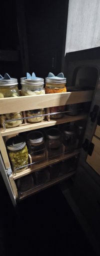

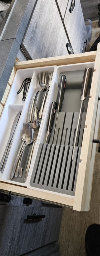

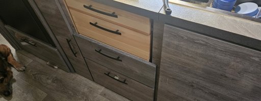

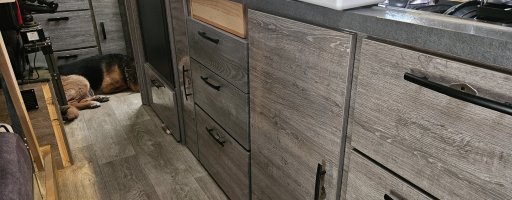

Got some more work done through the last couple of weeks. Havent been able to upload photos on the phone so having to post from the PC. Got the drawers done up under the induction top. I want to add a piece in front of them so they can match the other drawers/cabinets. Top drawer is for silverware and cutlery. other two drawers are cast iron and all the other cooking supplies. I also took the slide out between the fridge that had a bunch of wasted space and replaced it with a slide out rack. Using it for fermenting the peppers for hot sauce.

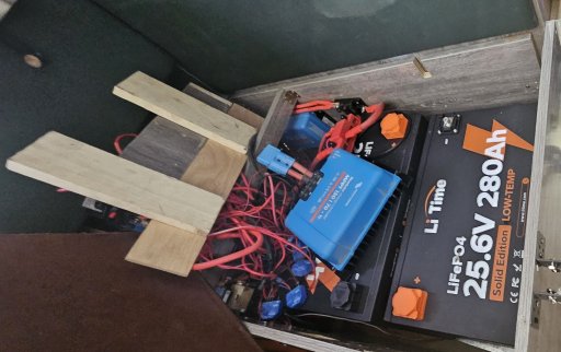

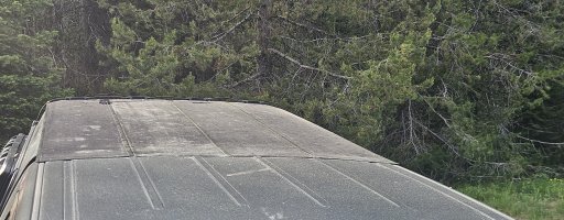

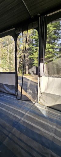

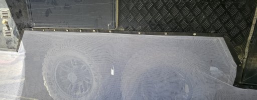

Been a while again since my last update. I feel like I have gotten quite a bit done. The water is finally fixed, and run as much as I can through the inside to help with freezing next winter. Got a bit more of the drawers done today, then ran out of wood so am not able to finish them up quite yet. They are a slightly darker shade of grey than what is already done, it looks good though and not super noticeable. Had some issues with the prior solar panel on the truck, was getting only about 40% of the rated capacity at max so decided to replace it with CIGS panel. So far they are working very well hopefully they stick to the truck and do better than my prior flex panels.

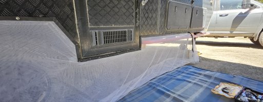

Also upgraded the battery bank, went with two 24v 280ah LiFePO4 LiTime batteries. So fare they are working fantastic, they barely did not fit, so I had to extend the seat by about 1/2 an inch. Was easy to do that and ill make it look pretty again using the same cover I did with the drawers for it to match-ish. Last thing I've been able to get done is more of the bug netting for the awning room. Did snaps along the side of the caravan, and used some reinforcement fabric tape. So far its holding well and wont snag like it did using Velcro to secure it. Also got a mosquito door in at the front which makes it easier to let dog in and out.
