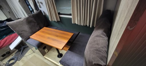

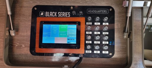

Got the galley seating area done. All the fabrick is water proof and marine grade. Makes for easy cleaning.

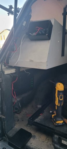

Finally had the holding tank heaters installed which are working great with the freezing temps we have been getting overnight here. This has also allowed the testing of my battery heating pad. The battery comaprtmebt has not gotten below 37 even with outside temps being low 20's.
This weekend I need to install the Safiery LPG sensors to the cerbo GX and figure out how I am going to redo the black series "control center" so that it is can display the Cerbo GX information and have all the breakers there as well.
House is on the market, hoping to accept an offer soon. Current plan is to leave on Jan 1, for about 5 months, down through NV then AZ and across all the southern states with many stops along the way.

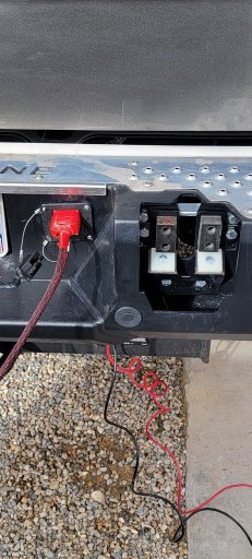

Need to find a way other than solar to charge batteries while in motion. Running a victron 12/12-30 would require 1/0 wire to run about 50'. That wire is not in the budget and would be a pain to run. Any suggestions on a solid plan to do this? that isnt going to break the bank.

If you'll be driving a bit most days the Redarc dc-dc 40a charger is what I rely on. It generally drives 20+ amps over 4g into the trailer bank and we pull 100 amps per day.
If you'll be parked or pulling too many amps for a car charger then we use a champion 3.5k mounted on the back of the trailer. I think the new model is a 4.5k, but either one can drive 100 amps into the trailer charger at eco speed or also run the ac at the same time.

Yeah, the resistance is the resistance. We sometimes run the generator while underway. That charges everything up pretty quickly.
My generator is in the bed of the truck so that wont work too well as its enclosed. Its not a major concern just something that I would eventually like to implement. I have 1kwh of solar mounted between trailer and truck and another 150w will be added before I take off full time. (maybe an adition 200 on top of that if i can figure out how to wire my goal zero boulder in series).

Just in case you don't already know, the Victron display can adjust the 110 amps being pulled from the power source. Might be worth playing around to get the most efficient approach
There is a lot that can be done, but still large wire to be run... even with the 12/12-18a I would need 8ga. which isnt bad and doable. 18a is much better than nothing but i want to get out for a few weeks and see what happens. If I dont need it I dont want to soend money on it. if i start going low I always have the generator.

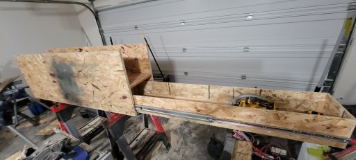

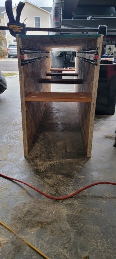

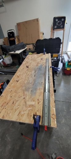

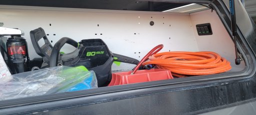

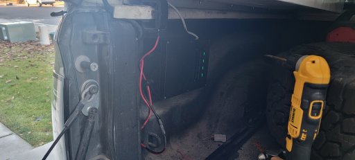

Attempted to go out on a winter tripe a few weeks back, it was failtastic, we didnt get out due to rig troubles. But Have been able to get quite a bit done. New slippers on. Black Rhino Armory wheels with Falken Wildpeak AT3's.

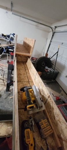

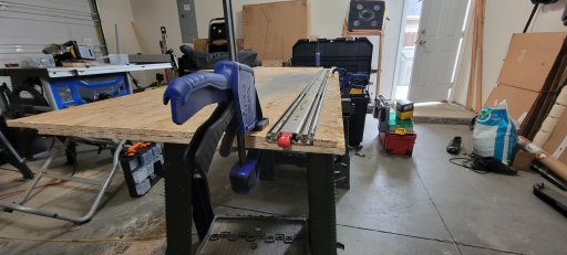

Working in some better storage for the truck bed. Have been puting toold and gear in bins which has worked but is not ideal as getting to stuff is a hassel. Puting a drawer with enclosed shelf on the CargoGlide. This will house tools and other importantish items in the drawer, with smaller organizer boxes in the shelf and other storage for stuff that doesnt need to be readily accessible in the trailer.
Also just waiting for the bed lights to come in to help see everything. have the boxes and wiring done, just need to hook lights to switches.

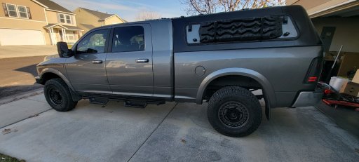

This week when weather cooperates I'll be installing airbags in the rear suspension to help with comfort while driving. It pulls great, but this will make the ride even smoother.

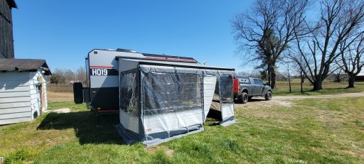

I got the Airbags put in and they make the ride a lot better. Doesnt even feel like the trailer is behind me on trails. Also got the anex room for the awning, which is a great addition when whindy or rainy. keeps the wind and water out. A great dry place to be able to hang out.
