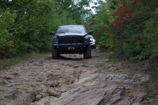

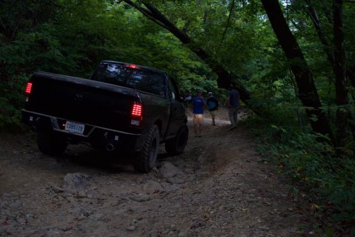

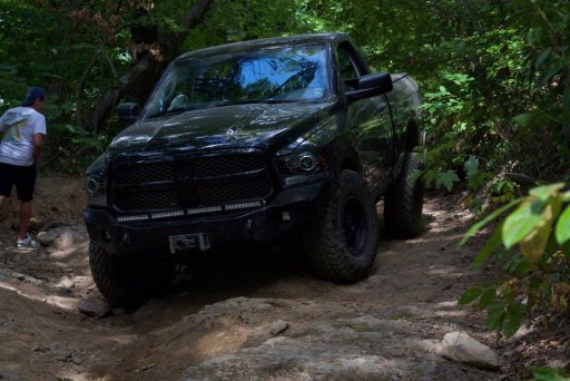

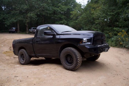

Awesome build man.
I have a 2014 single cab with similar mods and i use it as my daily driver and LOVE IT.
Love the looks I get from truck guys who appreciate the classic short wheelbase look!

They are good trucks the 4 link rear suspension gives them great flex on the trail and a good ride on the street.

Nice ride Conrad. It reminds me of my first 4WD a 1978 Power Wagon short bed. Put a cap on the back and you can sleep in the back. Back in the day we just called it tailgate camping :smiley:, you just pulled up, dropped the tailgate and you were camping. Overlanding sounds way cooler though.
