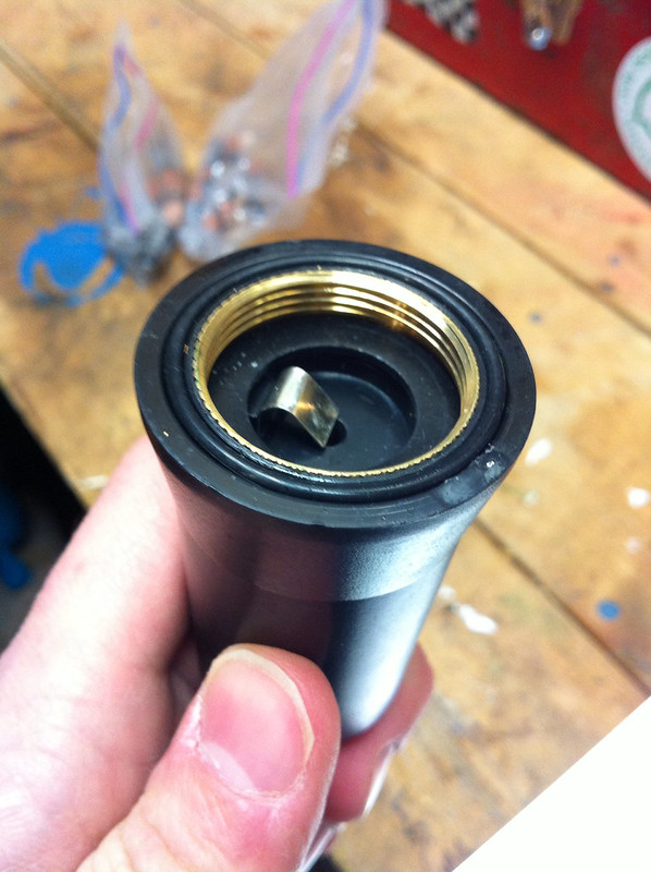

Ha, you know what, I was thinking back to when I put my radio in and at first I was having trouble hitting our local repeater. I borrowed the clubs tuner and was getting crazy high SWR numbers. Unscrewed the NMO and the contact had gotten bent;
Carefully pulled it back up and everything was great.

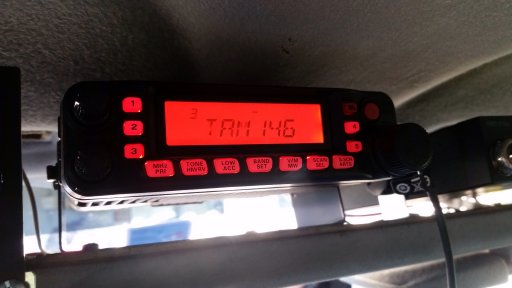

I was long asleep, thank you though! Friday I spent some time trouble shooting it all, did some more research online, broke out the multimeter then got mad, went to HRO's website and a few clicks later the upgraded radio I wanted with a new antenna cable is coming my way. FT-7900r.

I found where the old coax was crimped badly between the roof and the shelf bracket, so that could have been the problem. No one was on the repeaters this afternoon while I was programming it, but I could pick up the local Unicom from the airport and the SO's primary radio channel (one of the few here that aren't only APCO-25) clear as a bell. This radio does more of what I want than the single band (like being able to scan local Unicom). I do like how easy both radios are to program from the interface without having to flash them using CHiRP or similar.
