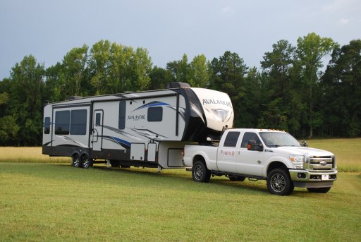

GVWR is a dart on the wall. But whichever way you go. AIRBAGS......I hauled RV's with my F350 for 2 years with a max weight of 16k lbs and a hitch weight of almost 3k lbs and those airbags were awesome....
