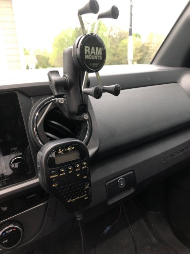

Comet rs720 mount. Here is a pic.
Nice rig, we have similar builds in mind. Go out and explore!
Sent from my SM-G930V using Tapatalk
Did you have any problems tuning your antenna? I have the same set up and can’t gwt my SWR reading out of the red. Wondering if it’s a grounding issue. Thanks in advance.
Sorry i havent logged in recently. I have yet to tune to be honest, when i do i will report back.

I ended up having to go a different route. I unknowingly bought the nso mount with a 3/4 in hole instead of a 1/2 in hole. I was also having problems grounding so I just got a ditch light bracket from relentless fab and put the antenna up there. Hopefully you'll have better luck than I did.

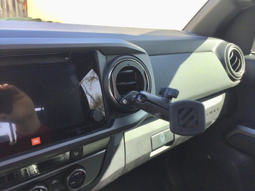

Quick question, where did you mount your cab and antenna? I ordered a unisex 520 but am returning it and thinking of going with a Cobra 75 WX since I couldn’t really find a good mounting spot.
Check out the Hondo Garage CB Mounts for Cobra 75WX, It works great

I went with the Midland 75-822 for cb and have a Scosche magic mount that I will use to mount it in the cab when I'm using it. Otherwise it lives in the glove box. For the antenna mounting I went with a relentless fab ditch light bracket.

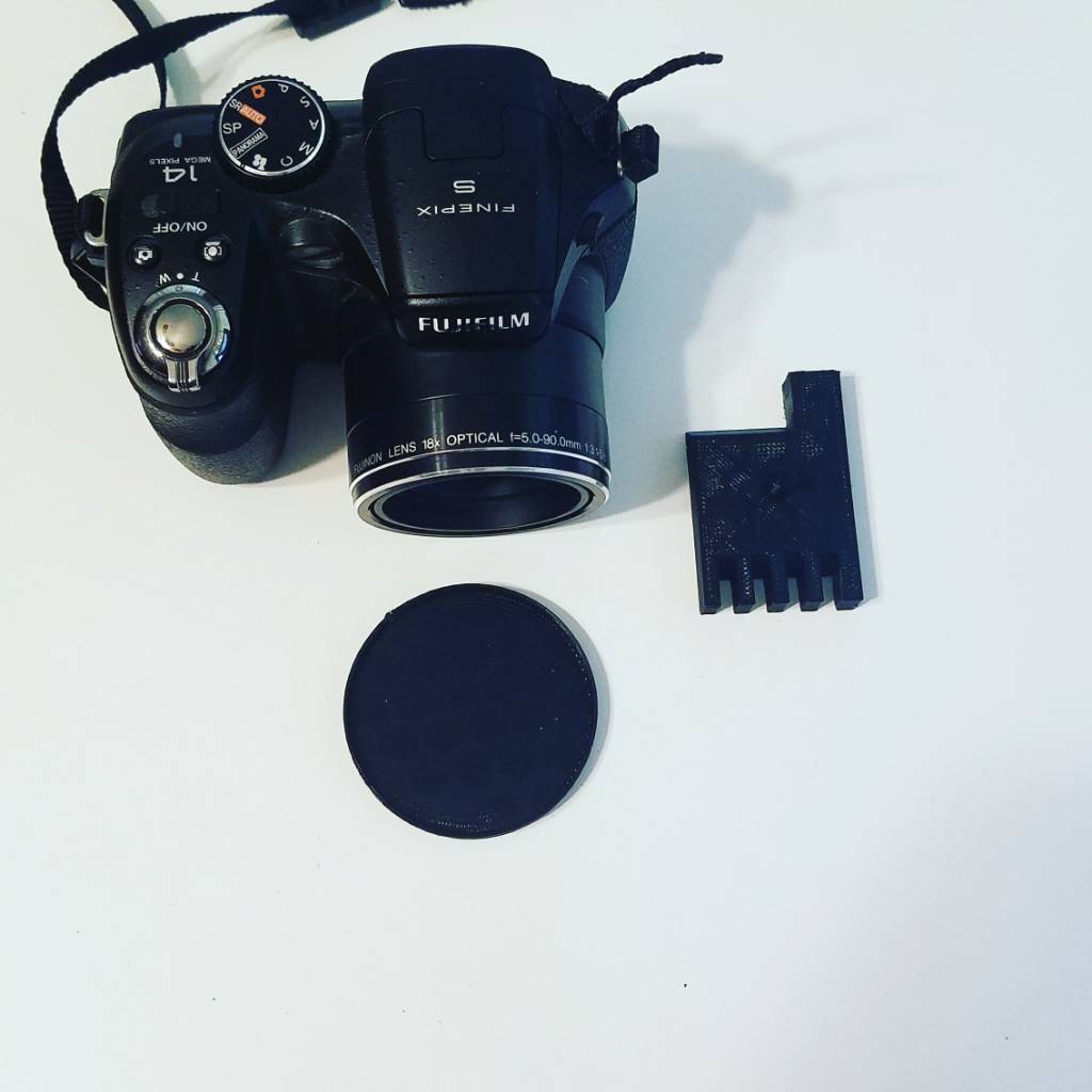

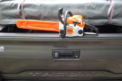

Got a killer deal on a chainsaw ive been watching for about 4 months. The stihl MS170 will handle home and trail duty. Also designed and 3d printed a lens cap and mount for my wifes old fujifilm S2940 that she passed down to me now that she has given up her photography hobby.

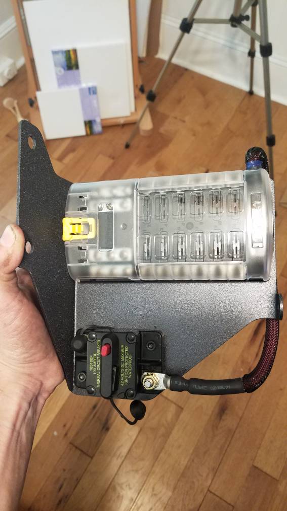

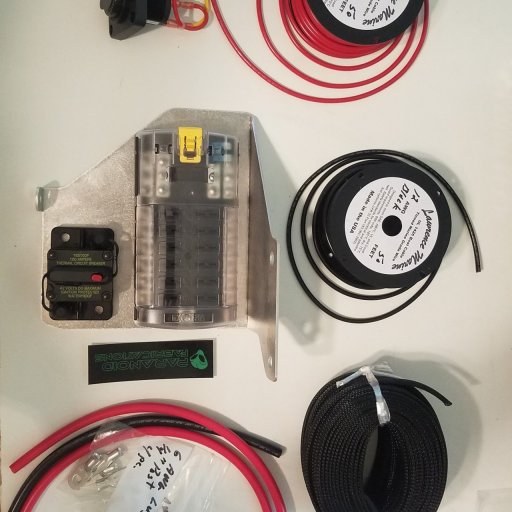

Putting my electrical together.
-Blue seas 12 circuit fuse box
-Bussman 100 amp circuit breaker hooked up using 6 gauge cable
-Paranoid Fabrications mount for 3rd Gen TRDOR model to mount the fuse box and circuit breaker to

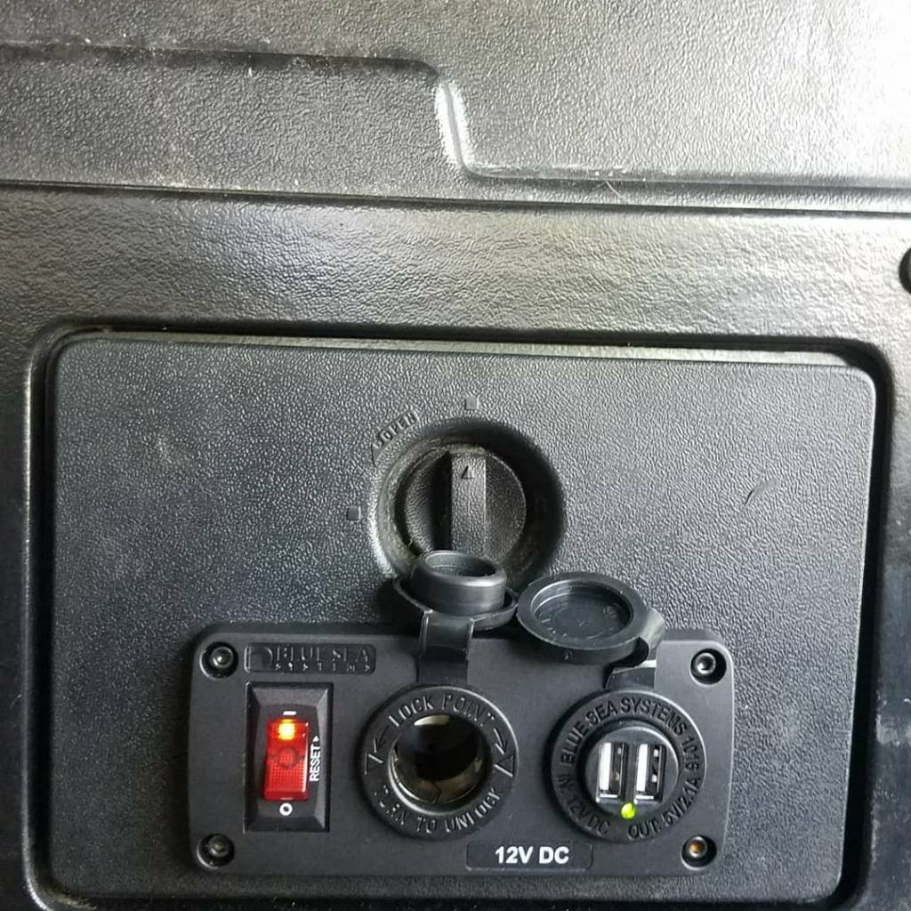

-Blue seas 12v socket and usb port being installed in the bed, wired up with 12 gauge wire
Reactions: Shallow Water Steve

I learned a lot throughout this mod. I built my electrical system, now have 12.6v in the bed of the truck to run the dometic and charge stuff.
