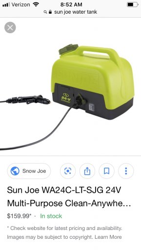

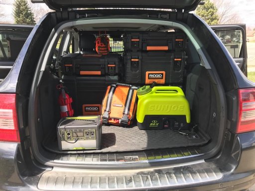

I use a Sun Joe. Cheap as hell and works perfectly. Battery lasts many water refills and easy to fill in and discharge. It holds 5 gallons and very light to carry.
You're using a Sun Joe what? I tried Googling to find it and I find all kinds of stuff made by Sun Joe like pressure washers but not anything like what you have pictured, what is it exactly?

Found it, thanks! Curious, how long does the 2 ah battery last?

Looks like they don't make it anymore. I got it from flea bay for $50, brand new. Never run out of battery on a single charge for more than 10 refills or you can power it up directly from your car.

I see them available on Amazon and Home Depot for about $120

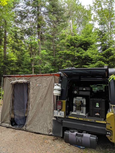

My 11 year old son bought me a Nemo Helio for my birthday after hearing me talk about wanting pressurized water. I had looked at the different mounted systems but I decided I wanted something I could remove just for ease of convenience whether that be filling it up or taking it away from the truck. I also hunt so this was a dual purpose for me as well. I used it for the first time this weekend and it surpassed my expectations not just with showering but doing dishes after making breakfasts. It made clean up so easy. The foot pump is great. It doesn’t take much to get the pressure up.
I filled it up before we left camp with tap water. We drove about an hour to a swimming hole and after about two hours of swimming we sprayed off and the water was very comfortably warm. It sat in the bed under my RTT’s shade and still got warm. It holds about three gallons which is plenty for two people to shower and have enough to do the dishes. I highly recommend it.
