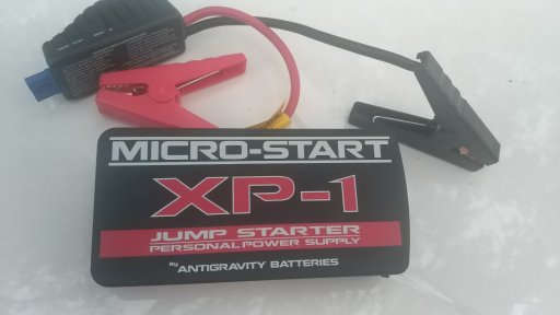

I have the xp1 Haven't had an issue with it though. Clips are the same as any other. Has saved me as well as about a half dozen others. I keep it in my everyday pack so it's always with me. I also have a harbor freight 3 in 1 but use it primarily to run the tent lights and fan. You know how it is, 2 is 1, 1 is none.
