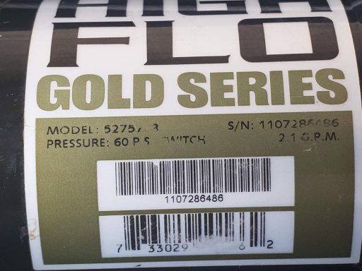

The data plate is starting to wear a bit, but you can still read it 60psi @2.1GPM FIMCO model 5275087

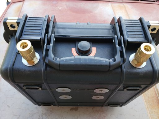

I did a dual washer under the home brew Bulk head fittings, a large fender washer inside, and standard washer outside of the case. and again "Borrowed" the idea of the QD fittings
Stainless hardware was used as well, with Nylocks since getting everything really tight is hard with out compressing the rubber isolator mount on the pump. something you want to avoid so you do not loose the vibration isolation.
Because of how I placed the pump, I ended up grinding down one of the ribs on the bottom so the fender washers would lay flush.

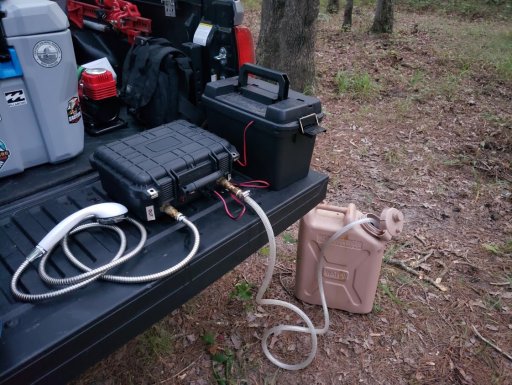

The shower head is from the Ecotemp L5 heater, and I had set it up so I could use the sprayer with the just the pump or the pump and heater. The water in the water in Scepter MWC, was plenty warm ( in the middle of August in Oklahoma) and 5 gallons was just about right for 2 people for a quick shower. Inside the box is a 30ah AGM battery, bit crude still since I did not get around to building a proper portable battery system yet.

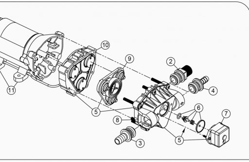

After tearing down and inspecting everything, the rubber parts for tears or nicks, and the plastic for cracks or other defects. I cleaned everything up an reassembled it. When I went to test the pump again, the leak was not as bad, but still there. So once more I tore the pump down, dried all the parts off. I then applied a thin bead of clear silicone to the mating surfaces of part #10 and #5 in the below diagram. along with a thin bead around the edge of the diaphragm.
I let everything dry for a couple of hours, and retested. This time the leak was gone.

How long this fix will last, I have no idea. it was to the point where I was going to have to either buy parts to fix it, or replace the pump. This pump had lived most of its life in my Jeep, and has probably been frozen at least once. So I did not want to risk buying a new diaphragm or check valve only to find the housing had a fine crack that I missed.
