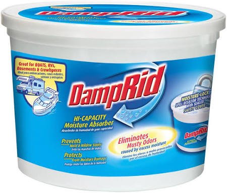

Has anyone used a desiccant while running their buddy/propane heater? something like this?
I remember using something like this when when our "laundry room" was in the the middle of the house with no venting and our dryer was a giant humidifier. I'm thinking of trying this.
