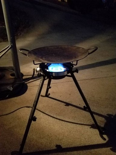

There are some big dollar names out there producing these kits. I don't begrudge them in any way, it's just their product doesn't meet my needs or what I'm willing to budget. I have found multiple sources for the plow wok http://www.southwestdisk.com/18-madrid-discada/ and I have a Coleman single burner stove. I'm thinking some kind of support to set the disk on over the burner on top of the propane bottle on a table. I would like it to fold so as to minimize packing problems. Any ideas ?

A standard wok ring/wok rack might do the trick assuming it fits over the stove in a suitable way
Here's one on amazon for $7. Top diameter is 8 1/4", bottom diameter is 9 7/8": B00125P91C

I'm thinking too short, I have a single burner on top of a small propane bottle, so maybe 12 in. tall. add a couple inches for flame. I need something 14 or 15 inches high that can fold small. May have to fab something, I was hoping there might be something out there that I hadn't stumbled across.

ah, yeah, i wondered if you meant single burner propane or single burner butane. i wonder if one of those pizza holders they put on the table at a pizza place to hold it above the drinks and such would be high enough? Might not be stable enough, though

I made a Dutch Oven stand out of a plow disc and three legs of pipe. I'm sure you could use the same design to make a plow disc cooker.
The pipe end is welded or drilled and bolted on to the plow disc. Then you attach legs of whatever length suits your needs. When you're done, unscrew the legs and it stores flat to take up less space.
To make it a cooker, choose legs long enough to make a comfortable cooking height and work well with your heat source (stove).

I made a DIY version of the skottle with the Southwest disk 18 inch you linked. Total cost with the disk was about $80 or so. Ill add a pic of my setup shortly.

Big Kahuna burner ($75) is what I use with my SouthWest Disc 18" Madrid. The burner can do very low heat all the way up to 34000 BTU blast furnace. Also, the Madrid Disc is heavier/thicker gauge steel and distributes heat more evenly. Last, but not least, I can just set the disc off and use griddle plates, WOK, large boiler pot etc. with the Kahuna Burner-- talk about flexible.

Nope-- you're right. I got it for $98 but had a discount code that I got from somewhere. Sorry about that pricing info. Still about half-off from a Skottle or similar from the other big name guys. That being said, the new Skottle that I saw at Overland Expedition East 2017 this last weekend was pretty cool-- and small--but almost $400.00

If you get the south west disc, BlueRidge Overland (the company that makes the bags for the Skottle from Tembo Tusk) has made me a custom bag for the Madrid 18" disc from SouthWest. They made one fro myself and my brother-- they should still have the pattern. I bought a "tupperware" box from Home Depot that holds everything-- I use it as a chuck box for all of my cooking stuff. You can use a cut-off wheel or dremel and take some material off of the Kahuna Burner to lighten it and reduce it's size as well.
