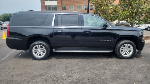

Hello! I've been looking through a lot of forums trying to find the best advice for overlanding with a 2015 Chevy Suburban thats been with my family for over 10 years. I'm currently in VA and want to do a cross country round trip visiting as many parks and places as possible. Thankfully I work remotely and can travel throughout the week but I work remotely and will be working east coast hours during the trip. Anyone have experience with a starlink mini and remote work while overlanding?
I've gone camping a good number of times and wanted to make sure that my rig would be ready for a cross country trip. Not trying to do any major off roading (trying to get her back in one piece). I plan on using the stock roof rails on the car. Should support up to 220lbs
So far I have the following:
  • Jackery 1000v2 Portable power station:
  • BougeRV 5kw diesel heater
  • a bunch of camping gear (sleeping bags, pads, pillows, cooking supplies, chairs, lights)
Things I'm contemplating getting;
  • TopOak stellar/nebula Rooftop Tent (Good for my needs, exceptionally quick setup and tear down time, diesel port, skylight and visibility
  • Starlink (to work remotely)
  • Maybe some beefier tires?
  • Skid plates for the underside of the suburban
  • a lift/level kit probably 2-3 inches
  • an Awning (one thats easy to setup and tear down)
  • A dual battery setup
  • Water/shower setup
  • Any other accessories that you think would help with the trip!
Bonus for any cooking tips and recipes that you would make on the journey
Extra bonus for any trail or park recs!
Thank you so much
