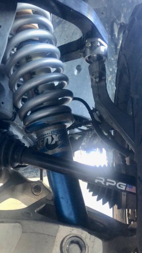

I got the front RPG Off-road Stage 3 suspension done! Billet upper control arms, billet tie rods and upgraded Eibach springs to compensate for the winch and bumper. This thing is bulletproof!!! So far it feels amazing, getting it out for a weekend excursion starting Friday!

I thought about going this route next time I have 2 replace the upper ball joints. I had a rough go when I took my factory shocks off and had them rebuilt. Ended up having to replace all ball joints, tie rod ends, and had to replace the vacuum line for the 4x4 hubs. Learned to not take my rig to my bosses house to get it worked on. While the lift was a great luxury. It wasn't worth the money in replacement parts though. Heard good things about rpg though. It definitely looks good

Thanks for the comments, so far I am very pleased with the RPG set up. I am also very fortunate that they are 30 minutes away from my house. The upper control arms and tie rod ends are burly as hell. The rear Deaver 4.5HD leafs are a massive difference too. I can’t believe what a massive step change this is from the stock suspension.

Awesome rig! Just a friendly hint, those ball joints are going to need to be serviced a lot. Just one of the trade offs on the design. I’m sure you are going to love that suspension set up.

Thanks for the heads up!

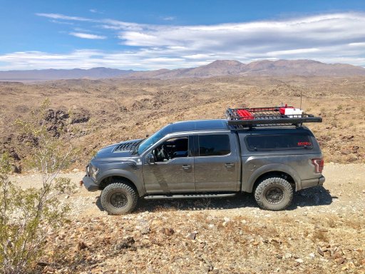

I have been doing a few smaller projects that are fun for more space and detail work. I rebuilt my roof rack setup with the extension from Yakima for the Mega Warrior adding 22”. This was quite a project as I had to completely rebuilt the wiring harness for the four rear lights. I also fabricated a new bracket for the MaxTrax. I like the extra space for things like firewood, or I also got a heavy duty cargo box from Lowe’s that fits up there nicely. I like the way it looks now, more proportionate to the truck and the awning is more proportionate to the rack. I do have to admit I am already thinking about swapping the awning and the hilift so the awning is on the passenger side. My Dometic fridge lives in the super cab on the passenger side so my kitchen will flow better. And here is a gratuitous truck shot from Old Dale Road in Joshua Tree :)
