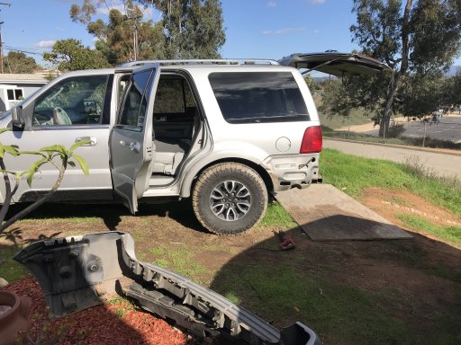

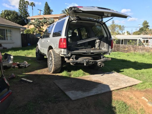

Thanks for all the help and responses guys I really appreciate it! I went ahead and cut the wheel wells and now this thing looks lifted hahaha it has tons of clearance for the tires.
All I could think about as I was chopping my rear wheel well with a saws all was the one of the first comments someone left, he asked “ are you afraid of scratches” hahaha
But yeah I’m not sure if I need a lift anymore and I can probably fit 40” tires now lol
