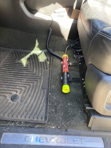

I'm carrying two Element 50 extinguishers. One mounted in the cab on a Desert Does it molle panel on the driver's seat. The other one is under the driver's seat for now. Planning to mount it in the truck cap when I get that far with the build.View attachment 247326
Beware of only carrying gas generator type fire extinguishers. I would also keep a dry chem on hand has well. In something like a Class A or a class C electrical fire, once the gas dissipates, you'll probably get reignition. Dry chem has the advantage of smothering fires and in a Class C fire can buy you time to disconnect the electrical power, effectively turning it into a Class A fire which is much easier to deal with.
