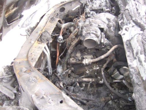

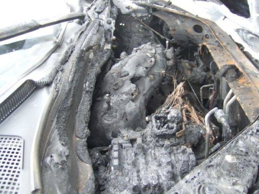

I had one catch fire while driving. I got stopped, and got my own out plus the a guy at a gas station and a nearby truck driver. A total of 25 pounds and no joy until a fire truck got there.
The hood release had burnt through by the time I got stopped.
Wow that's rough. Sorry that your car was totaled, but glad your alive. Guess it shows you can never have too many extinguishers on hand.
I’d love to hear the 911 tape of my call. I was grabbing stuff frantically to get it out, think coyote works Jeep, while on the phone when something under hood exploded. Scared the crap outta me.
Those hood releases seem to be the first thing to go. I've fought a few car fires and never had one work by the time we got here. We used to use a big prybar to get it open. Now that we have our battery powered "jaws of life" we grab that and pop the hood open in seconds.
That’s exactly what happened. Dallas FD cut the hood hinges to get to the engine bay.

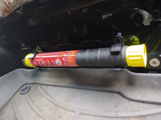

I'm carrying two Element 50 extinguishers. One mounted in the cab on a Desert Does it molle panel on the driver's seat. The other one is under the driver's seat for now. Planning to mount it in the truck cap when I get that far with the build.IMG_20221005_175837950.jpg
