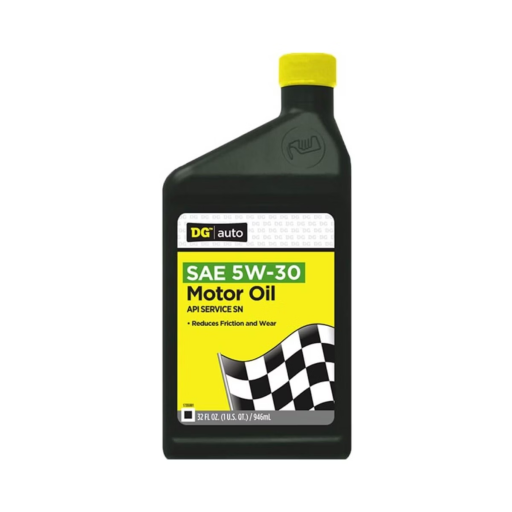

While we're on the topic of lubes...I researched a bit on different motor oils and THAT was a rabbit hole unto itself. I recommend y'all go do a little research on motor oils, because apparently some brands actually wreck motors. I use Mobile 1 across the board and that was tested to be a really good oil, but even some of the versions of Pennsoil are not good for certain engines and the Walmart brand "Super Tech" is apparently (not surprisingly) the worst and caused significant damage in the test engine using it.
AND...just when I thought it couldn't get any worse...I found THIS brand of oil...:disappointed:
