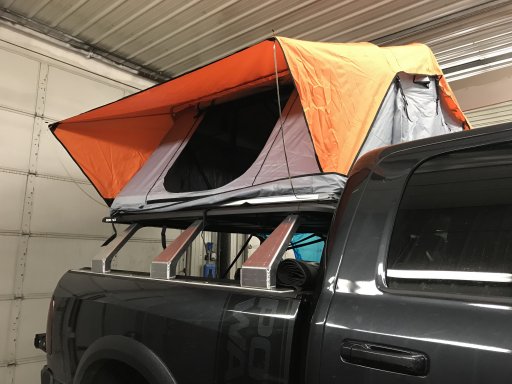

You should be able to find a metal fabrication shop in your local area that will make them for you. Thats the best way to do it.
The difference between the way I went and getting something like a Yakima rack is with a Yakima you can add what THEY have figured out you want. With mine I can figure out what I want and have it configured accordingly. Everything on mine will be where I decide I want it. Just like the hight. I wanted them that hight, so the guy that made em made em that hight.

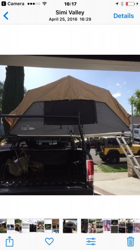

Bed bars. Generally run about a hundred ish a bar. Mine ran a little more cause I had em made taller than usual. Also, You probably only need 2. Ive got a 6 ft. bed and a 6 foot long tent so I went with 3.
Front Runner outfitters has a LR series track bar that one can attach their tent supports to. There are a lot of fab options and you can transfer it to the F350 easily enough. Attached to the vertical side if the top of the bed.

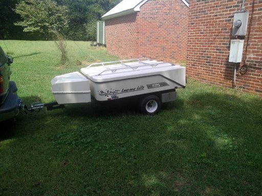

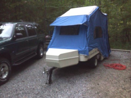

check out leesurlite. i have one of the motorcycle trailers but they do make i think on an as order basis a truck bed mounted fold out tent.
my trailer rocks on the bike. park , level, open get outdoor stuff out, done. if your only carry the bare bones like i do on the bike. after unhooking. about 7 minutes to full extension and ready to sleep.
if i want the canopy up to add about 10 minutes to lay it out and set it up. they are very cool units.
hope this helps with ideas
Mikeyleigh
Clarksville Va
6274
i re read my earlier post and wow i type really bad.. i corrected it so it is understandable gibberish now. and added pics of my leesurlite trailer set up and closed. give you some idea of its size. the pickup version is the same only without the suspension and tow setup hanging off of it.
they are made in canada and there are i think three dealers in the usa for them. millers trailers out of PA. is one of them i believe. Hope this helps in what you were looking for. sorry about the terrible spelling on the last post.

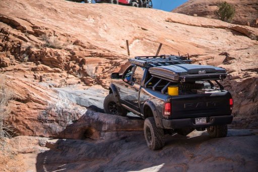

Looked on TNT's website and didn't find any info on the product (looking for solutions for a ram with a rambox).
Any link or direction to go to get more info on the product?
Thanks
Don’t have the RAM box done yet. Should be up on the website in a few months.

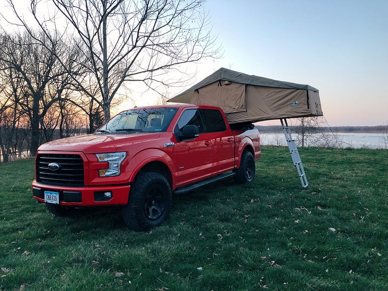

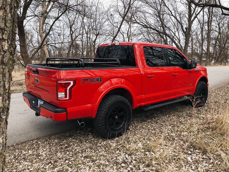

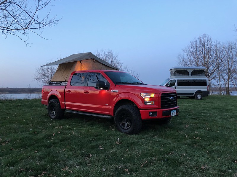

I bought a rack from "hot metal fab" its universal rack and only $300, comes bare metal so you can leave it as is or have it painted. I had mine powdercoated locally.
