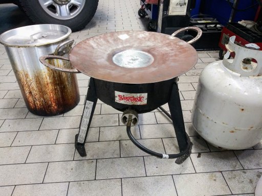

I just wanted something new. I have a nice 18" carbon steel paella pan that gets plenty of use. The different shape of the disc has interested me. It has a very slight dish about 6 inches in diameter in the center and the rest is just like the others posted in this thread.

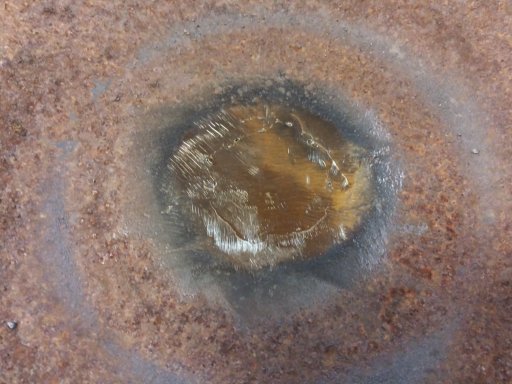

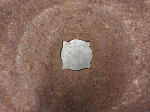

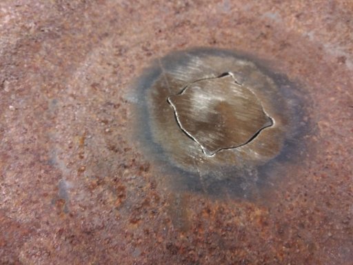

First you cut out a piece of steel to fill the hole in the middle.
The you sand off as much as the surface junk as you can.
Then you use a borrowed, under-powered 115V stick welder to cram as many 6013 rods as you can in there. Immediately grind everything as smooth as possible without taking a picture beforehand because this is your first time ever using an arc welder and it looks ATROCIOUS. I realize now i should have ground the edges at a bevel before welding with something to weak.
Tomorrow I'm going to weld on a couple horseshoe handles with the MIG at work.

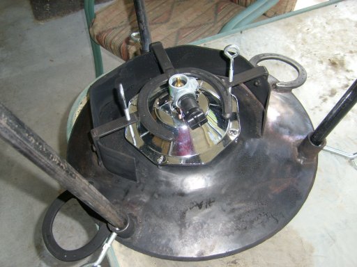

I used a 60 grit flap disc to clean mine up. For seasoning, I put mine on the BBQ to heat it until it quit smoking. Then removed it, reoiled it and did it again. Those discs are high carbon steel and will kill a sanding disc pretty fast. This pic is how I did my first disc. The wide flatbar is a wind screen, it is removeable. The horseshoe has a small spacer in the "U" to make it wide enough for the stove. I have made another discada out of the Bayou Classic disc.STP60900 (1).JPGSTP60900 (1).JPG

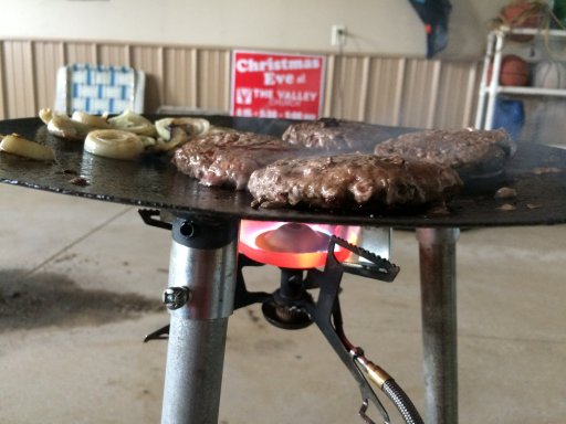

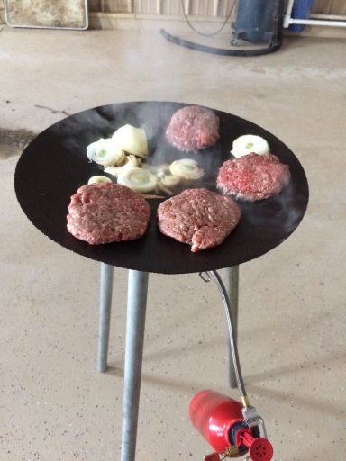

Made a disk cooker today ..... cooked dinner for me and the wife . I think I’m going to like this thing.
Had all the steel laying around, using my MSR whisper light for heat.
