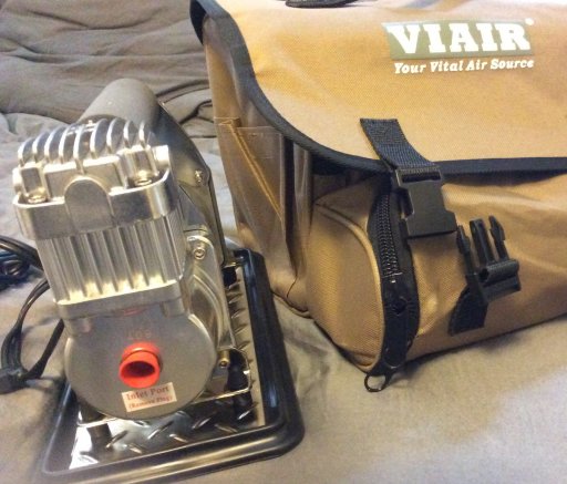

I just got a Viair 400 a couple weeks ago. I run 265/75/16 BFG K02 tires. If I air down to 20, it takes about a minute and change to get them back up. That unit is just over $100. It comes in a great kit bag all organized. Super happy with it.image.jpg

I just got a Viair 400 a couple weeks ago. I run 265/75/16 BFG K02 tires. If I air down to 20, it takes about a minute and change to get them back up. That unit is just over $100. It comes in a great kit bag all organized. Super happy with it.View attachment 102
I think I am going to end up with that 400 series! Looks like the best of both worlds.

@4Runner If you haven't got one yet...I wanted to learn how to use my new Viair 400. I have air down valves set at 20psi. I aired one down and hooked it up. It was 50 seconds to go from 20 to 39 psi on my 265/75.16's. Easy peazey. Pretty quiet unit too. You can find them under $150...

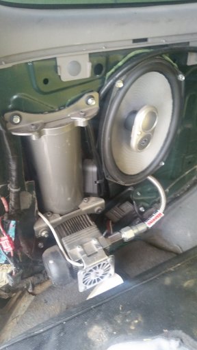

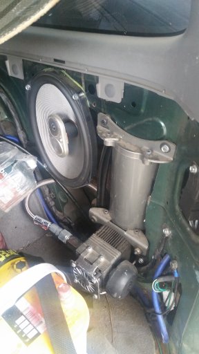

this is most likely out of most peoples budgets for compressors, but ive been very impressed with Air Zeniths OB2 compressors. Im running a dual compressor setup with a 5 gallon tank. the compressors are 200 psi, 100% duty cycle, high output compressors EACH. I have dual outlets currently (high pressure and low pressure) with a VIAR pressure regulator for running my air tools.
Under a stress test of the system, i aired down all 4 of my 33x12.50x15 km2s down to zero, then aired them back up to 35 psi each. It took about 7 1/2 minutes to complete and the tank pressure never dropped below about 80 psi.
The whole setup with fittings, compressors, tank, lines, etc ran about $1200 in just parts. The plus side of it is that i pretty much have a shop quality air system for the trails.

That's a sweet setup, and like 1/3 of the price of my Jeep!

Exactly why I prefaced it the way I did. However, when you can easily run air tools on the side of the road & trail, its well worth the investment.
In the future, I may add a dual arb compressor to the setup for when I add air lockers, but will add a valve to tie it to the air tank for even more air flow
